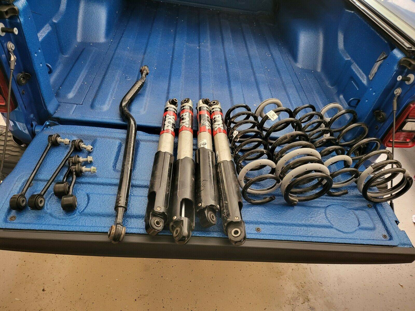

I'm just a little confused about shock setups. Background info: I have been driving a Jeep daily for almost 9 years, last three years, a 2022 Glad Sport S with Max Tow suspension. Most of the mods I have made to my JT have been cosmetic. I started reading on this site in early '22 while my new JT was on order. Read many posts about swapping out shocks and coils to Rubicon Fox takeoffs. So I jumped in and bought a lightly-used set for one of my first Mods, even before my Sting Gray JT landed in SC. I was not planning on a lift as my wife and I aren’t spring chickens anymore. I had to get running boards for her to convince her I could use the Gladiator as my daily. Well, before I arranged to do the swap, that setup was out of favor here. Then there was talk about changing the front shocks & coils to the Rubi takeoffs and leaving the MXTOs on the rear as they were better than the Rubis. That never happened; they are still sitting in a box. My 3-year factory warranty is almost out, and I might be ready to change something soon. I'm a little mechanically inclined, but not a vehicle mechanic, much less a Jeep suspension mechanic.
Now, finally, the question. I see posts about the Bilstein 5100 shocks as a good upgrade. If I do this, would you change the front to the 5100s and leave the factory MXTO rear setup?
Or should all 4 be changed and not mix different types of shocks?
If the rears are changed from the MXTO setup, how will this affect the intended factory load capacity and daily handling?
I also plan to change bumpers and go to 285/70-17 tires but not lifted.
Thanks for listening.

Stick with your stock Max Tow suspension until the shocks need replaced. They should be good for at least 50k miles. Since you already have the FOX shocks, put those on and see how they work (you may need four of the older style bolts). If you don't like the ride, get some Bilstein shocks or some Max Tow take-offs.
I would not worry about changing the front springs unless you get a significant sag after swapping bumpers.
I bought a set of the Rubicon take-off FOX shocks for my first Gladiator. I traded it in for another one before the shocks needed replaced. I also have a complete Max Tow suspension that I got from someone who installed a lift. He gave it to me, I just had to drive an hour to pick it up. For now, it's all sitting on a shelf.

Bilstein 5100s all day and yes, do all 4
The MaxTow is going to be about the springs not the shocks.

This. The springs carry the weight. The shocks control the movement.

What are you trying to gain with playing with the suspension?

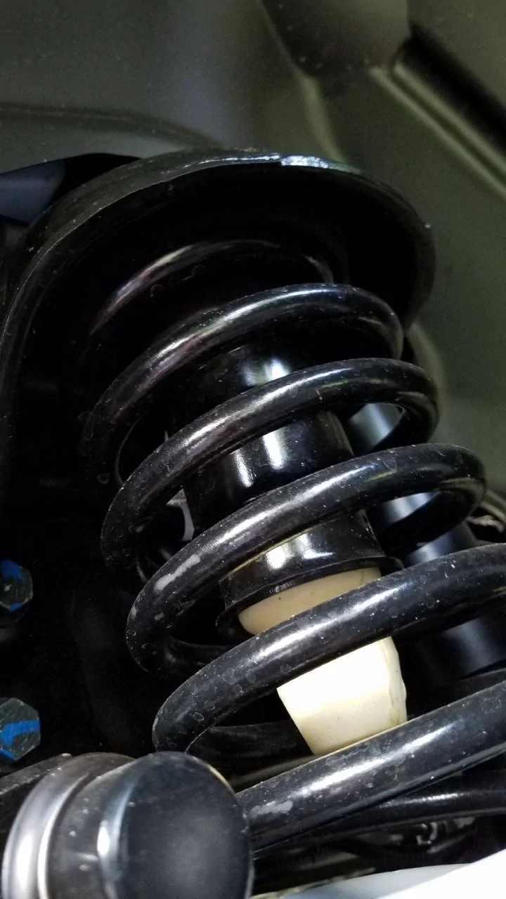

I specifically ordered a Max Tow as I wanted 4.10 gears and the most payload capacity I could get. It wasn't really about the tow capacity specifically. I put a 1.5" Teraflex leveling spacer kit in the front and I have 285/70R17 tires. Since I do not want to adversely affect my payload capacity, I plan to keep the stock springs in the truck (all around lift kit was never part of the plan).
Now, at 25K miles I found that one front shock is completely blown out (shock oil is pouring out of it) and a rear one may have some residue coming out. So I have Bilstein 5100's laying in the back seat to install tomorrow.
There shouldn't be any affect on payload capacity since the springs aren't being changed. I am curious to see how the ride quality and handling changes (if at all). Should know more this weekend.
