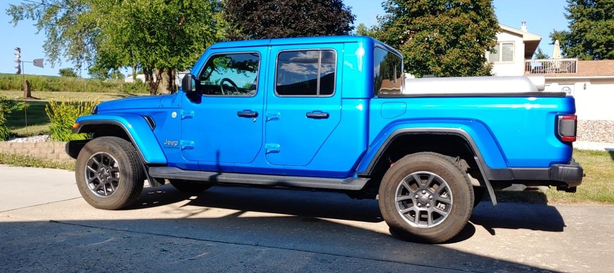

Thanks - now a way to regain some of the height I lost in the rear with the max tow springs. The Overland springs are a lot longer. I lost a good half inch or so in the rear (gained a strong inch in the front - less rake but I sure didn't want to lose height in the rear)
Just need to recenter the steering wheel now since the front height changed, the wheel is off.
I have some 3/4” rear spacers that would probably do good on there.
40,483
53,972
I gained a strong inch on the front,
lost .5" on the rear.
That's 1.5" rake out - I had wanted to take a little rake out as hopefully the max tow springs won't drop as bad as the Overland springs did staying in the Overland payload and towing specs.
So 3/4 back under the rear puts it up .25" over stock in the rear,
1.0 in the front over stock so that's a loss of .75" rake.
Not bad, as I wanted some rake out and a little lift isn't bad at all. No need for any longer or different parts otherwise.

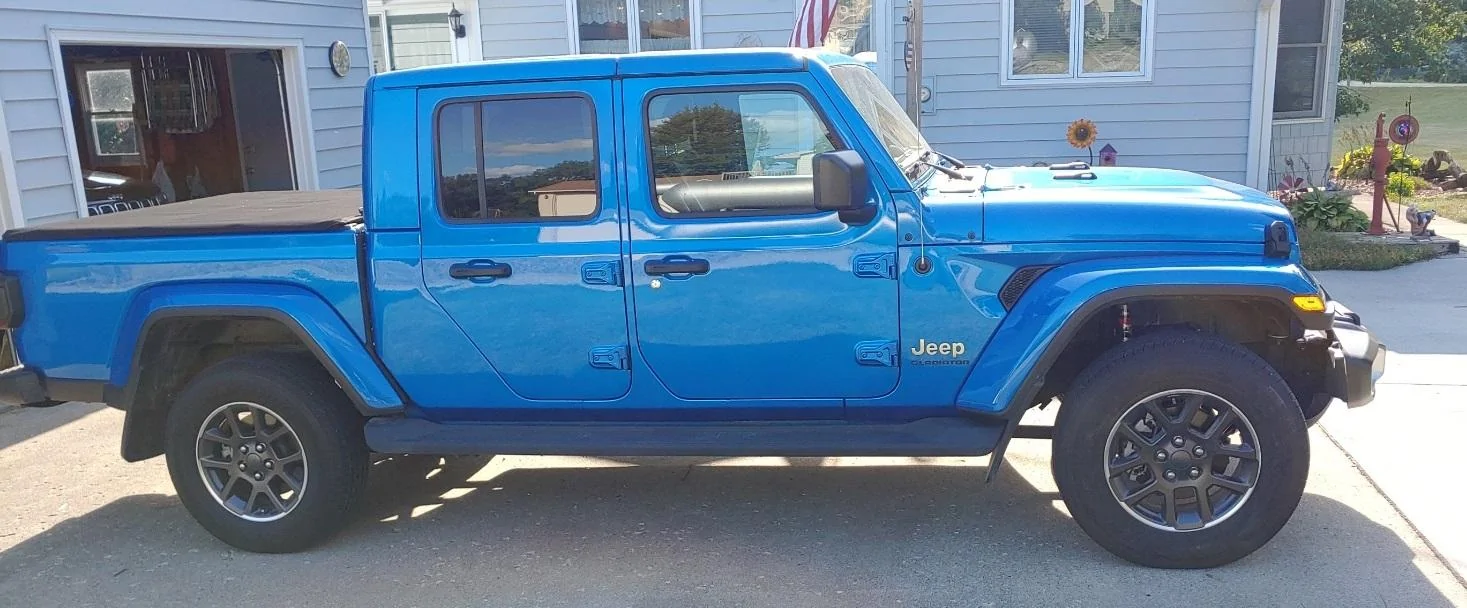

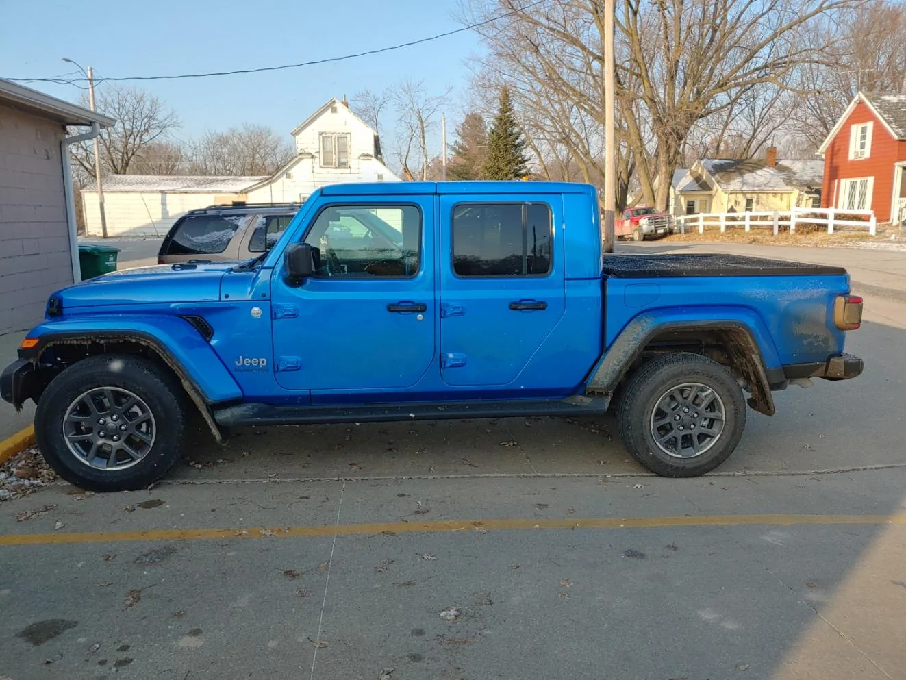

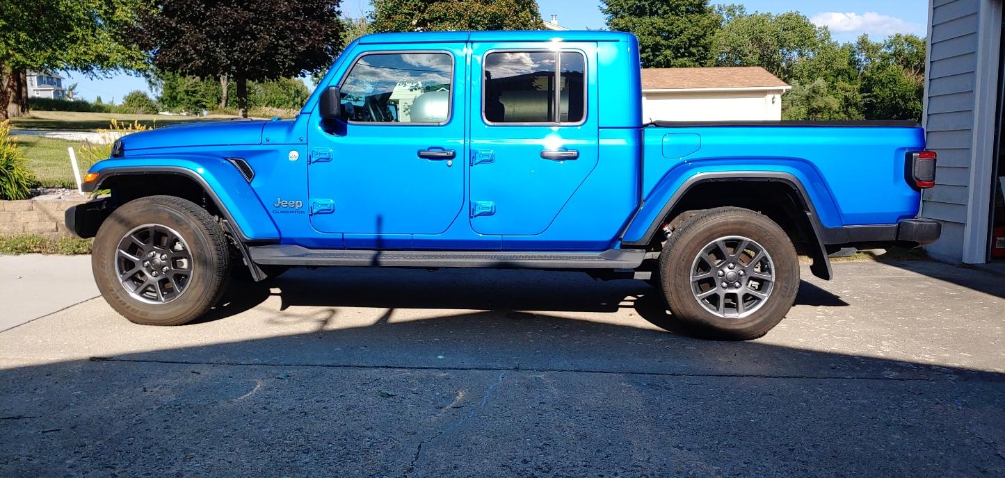

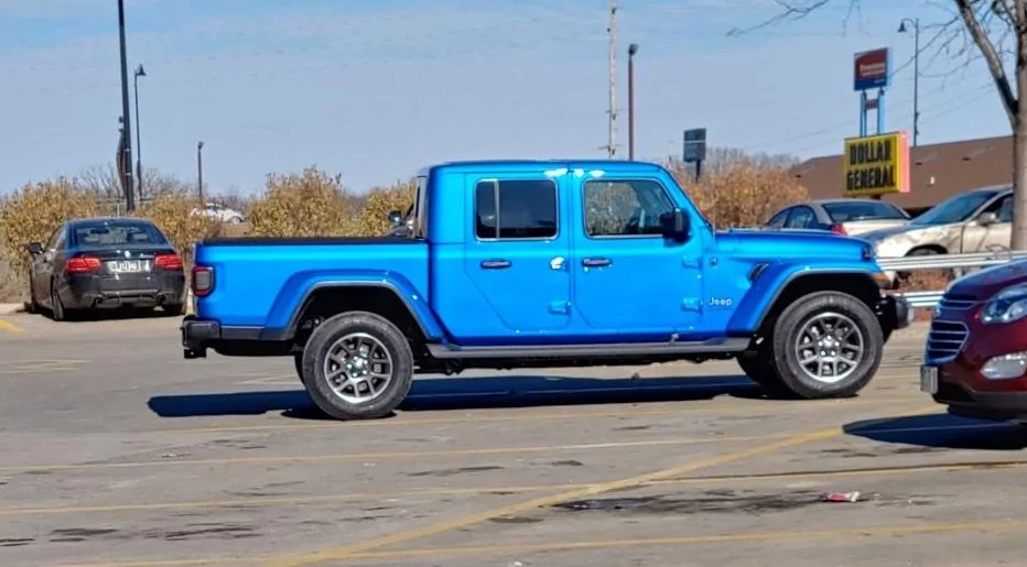

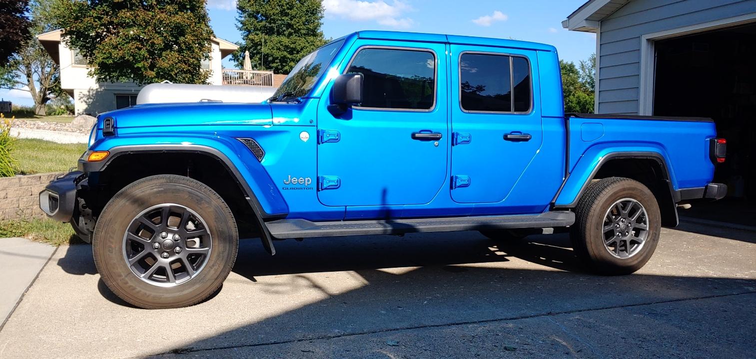

Here's pics of the truck as it sits now - but I could not find good "before" shots other than these - one was taken at a grocery store parking lot, and one at the local small town post office last winter. The last 4 are current.
Jeep Gladiator shocked by shock and spring replacement cost JT-at-hyv
Jeep Gladiator shocked by shock and spring replacement cost JT-with-snow-dirt
Then after the swap - I lost about a half inch in the rear and gained an inch up front.
Jeep Gladiator shocked by shock and spring replacement cost after-spring-swap-1
Jeep Gladiator shocked by shock and spring replacement cost after-spring-swap-2
Jeep Gladiator shocked by shock and spring replacement cost after-spring-swap-3
Jeep Gladiator shocked by shock and spring replacement cost after-spring-swap-4

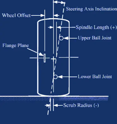

What do you mean by SAI?
40,483
53,972
Steering Axis Inclination. The axis, or line drawn through the ball joints, isn't straight up and down. So when you turn the wheels, it literally pushes the wheels down, raising the truck up. This helps cause the wheels to want to self-straighten after a turn.
Both wheels gain positive camber as they turn, causing them to want to return to center.
I'm an extremely "visual person" so pictures are my thing.
Jeep Gladiator shocked by shock and spring replacement cost steering-axis-inclination
