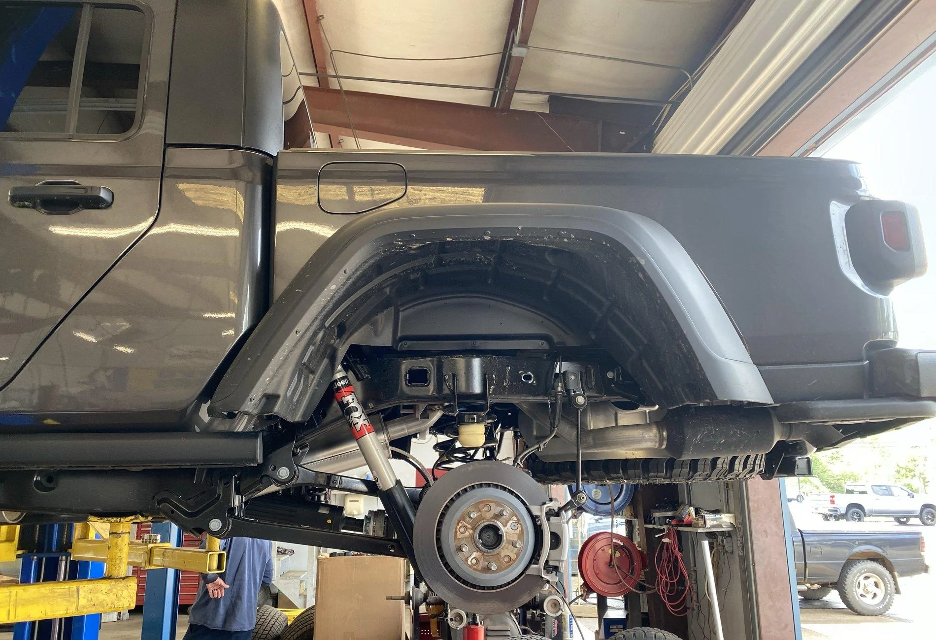

Silly question - Rubicon Fox shocks, the stock JTR shocks, the plastic sleeve has a cutout or opening - on the rear shocks, does that face to the front of the truck or to the rear?
I see no clearance issues either way, it would fit either way and not rub, but I assume that cutout is there for a reason?
Anyone have a pic of the Rubicon JT rear shock - or can say which way that opening or cutout should face - forward or to the back?
This was taken I was putting the spacer lift on... It looks like it faces the tire/wheel side, and not towards the inside of the truck.
If you need a specific front or back picture, let me know, I can go take one real quick.

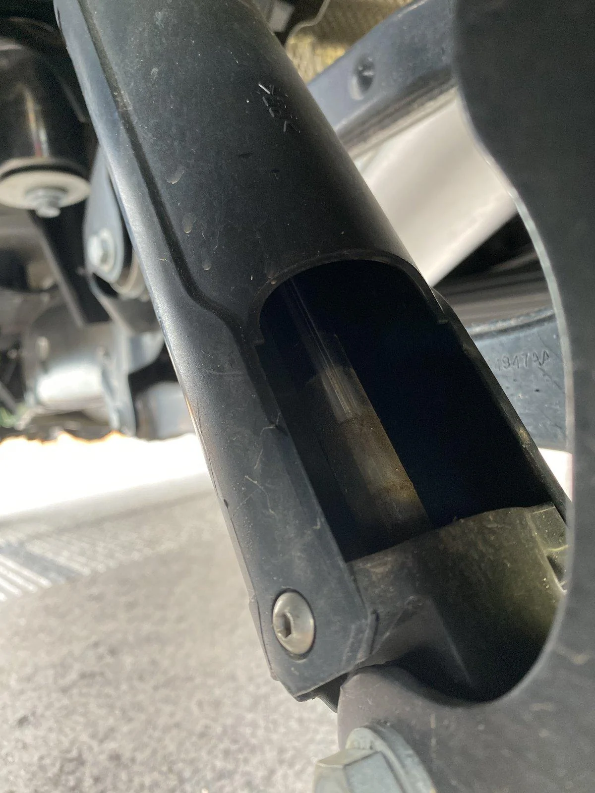

Thanks - I never thought of that upper part of the plastic.
I guess I was thinking of the opening at the very bottom of the plastic, next to where the bolt goes through. On the set I have, there's a side that's open, sort of a notch next to the mounting "loop" or "eye" so you can see the piston of the shock. Not sure the purpose of that or which way it should face.
Do you have a shot of the bottom end of the shock showing that opening in the sleeve?

This is from the back of the rear axle, looking towards the front of the truck...
The opening faces rearward towards the shock mounting bracket on the rear axle.
PERFECT! THANK YOU!! That's a great picture.
I don't need to take the bottoms of the shocks loose. (I suppose if I was wrong, looks like the plastic sleeve can be unbolted, turned, and put back. )
The fronts appeared to have the "cutout" as if to clear the brake sensor lines. The shocks weren't REAL close to them, but it made total sense to face the opening to the rear on the front shocks for that line.
I did the rear the same. I wasn't sure at first, it seemed that facing at that angle like that that water or stuff may build in there but there are holes in the bottom facing the front for drainage.
I got it right using logic.
The original Overland shocks are very different, more like standard truck shocks, with the upper part being a really light flexible plastic so there was no way to compare to what I was taking off. The "take-offs" I bought were not marked in any way. All I knew for sure was which end was up.
Thanks again - that's a big help.
