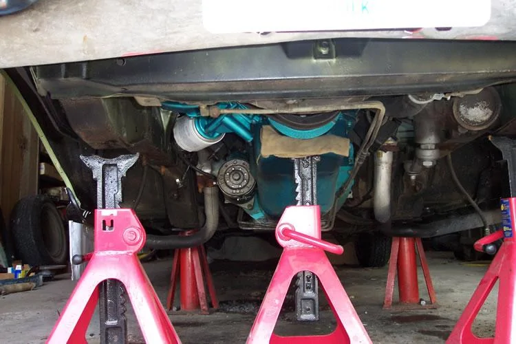

I had this car stripped completely down, hod to hold the engine up with a jack stand because I pulled the entire front suspension, cross member, steering, springs, all of it........... if it was part of the steering or suspension system at all, it was off the car.

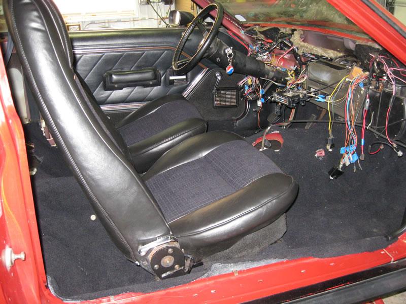

I LOVE electrical work - CANBUS is different, but I really do enjoy electric work. It was fun merging the Grand Cherokee PCM, PDC and other parts into the original wiring of this

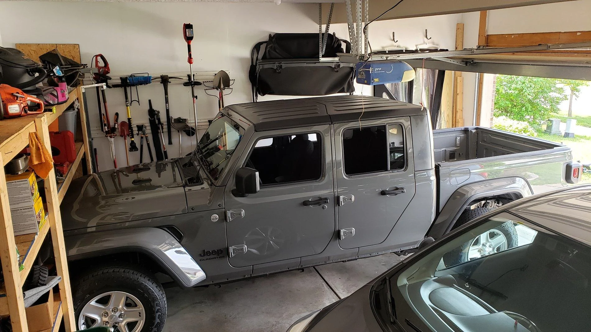

We keep our garage pretty tidy because we both park in it. I had to modify my homemade shelf when I bought the gladiator because it's so long so it just barely fits length wise.
I suggest starting in the morning around 7am when it's about 20 degrees cooler. It is a pretty easy install especially since our trucks are so new. I used a 2x4 about 3 to 4 foot long on the rear to pry each side of the axle down so the spring would pull out. I had my wife help me. On the rear swaybar end links, remove the top end that is bolted to the frame since it has a captive nut. Makes it slightly easier IMO. Wedge your 2x4 on top of the brake disc and under the bump stop. Easy pry down point.
I used a Milwaukee cordless 1/2" impact for about half of the fasteners and it saved alot of energy. So use them if you have them.

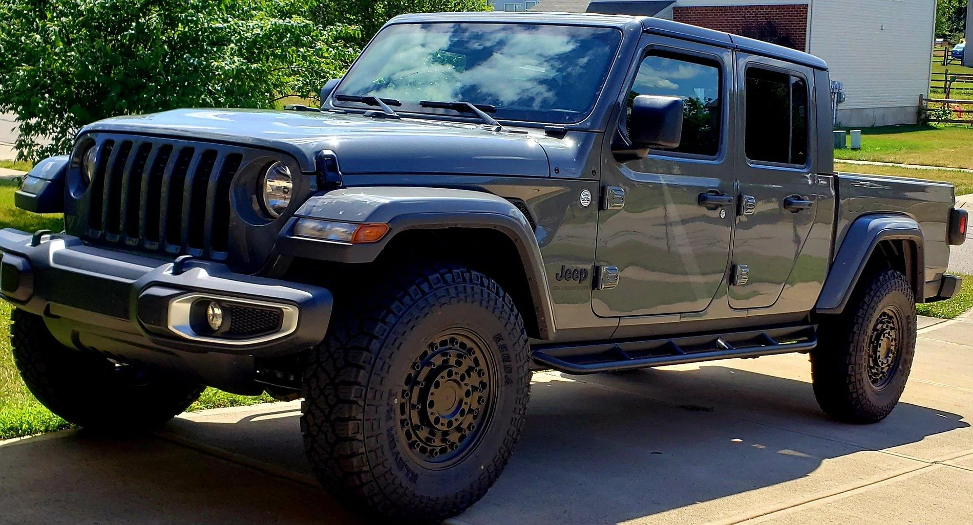

Front is done. Rubicon springs and shocks up front.
Gained about 1" at the axle.
Starting point -
15.25" from floor to bottom of front end of running boards
15.25" from floor to bottom of the 2" hole in the front receiver.
After -
16" from floor to bottom of front end of running boards
16.372" from floor to bottom of the 2" hole in the front receiver
That figures to about 1" at the axle.
Will measure again after rear is done and I've driven it a couple of miles.
More later, pics, etc. when all done and cleaned up and tools put away.
