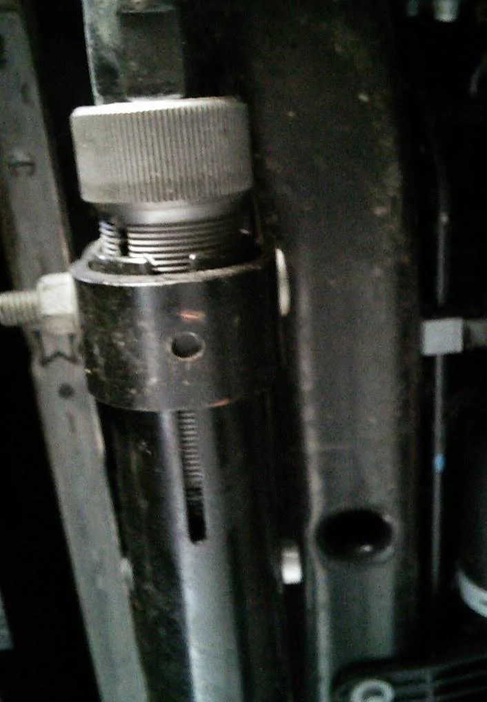

Quarter to half turn tighten. Look at the threads to turn the correct way the first time, unlike me.
HA - thanks, we've all been there! Even with all of the alignments I've done, it's not like I've never turned a tie rod sleeve the wrong way..............
Ah, left hand threads. Tricky. Not what I'd have expected to shorten it up.
