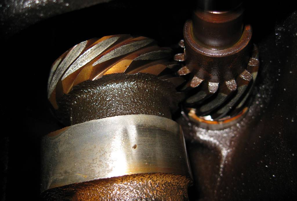

That'll tear up distributor drive and driven gears - won't "stretch" the timing chain. they don't stretch, they wear. Each pin and each hole wears, causing an effective change in length.
That is normal for 80K miles or so to have timing chain wear.
Because it's a sort of worm gear drive, the camshaft distributor drive gear has crazy advantage over the driven gear on the lower end of the distributor. Tension will tear up the gears, but not cause chain issues.
Making it worse is the fact that on some engines over the decades, the camshaft sprocket was lined with nylon - the teeth were nylon to make it run quieter, reduce chain against sprocket noise. The nylon wore down some, the chain wore, and in some cases, the nylon literally shed from the cam sprocket.
But I'd bet a steak dinner the timing chain wasn't the result of a tight distributor.......
it's like "my neighbor fell and broke her hip".
No, she didn't. Her hip broke causing the fall. Low bone density - weak hips, joint gives out, they fall.
Lack of oil changes, or excessively high oil pressure, or tight distributor, binding, etc. - will cut into the teeth. Yes, high oil pressure is a BAD thing, not good. It eats up oil pump drive components.
So the first thing excessive pressure or a tight distributor (which is the same net effect) will cause is gear wear. It would take a damned tight distributor to cause any damage because the resistance of the oil pump is really high if you've ever primed an older engine and felt the resistance as pressure built up as you primed it.

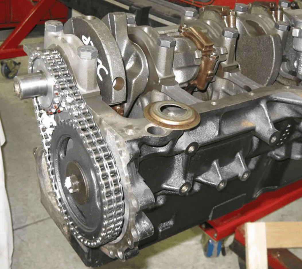

The 4.0, among others, used a double-roller design to make it quieter, smoother, reduce friction and heat and help reduce wear to some extent -
