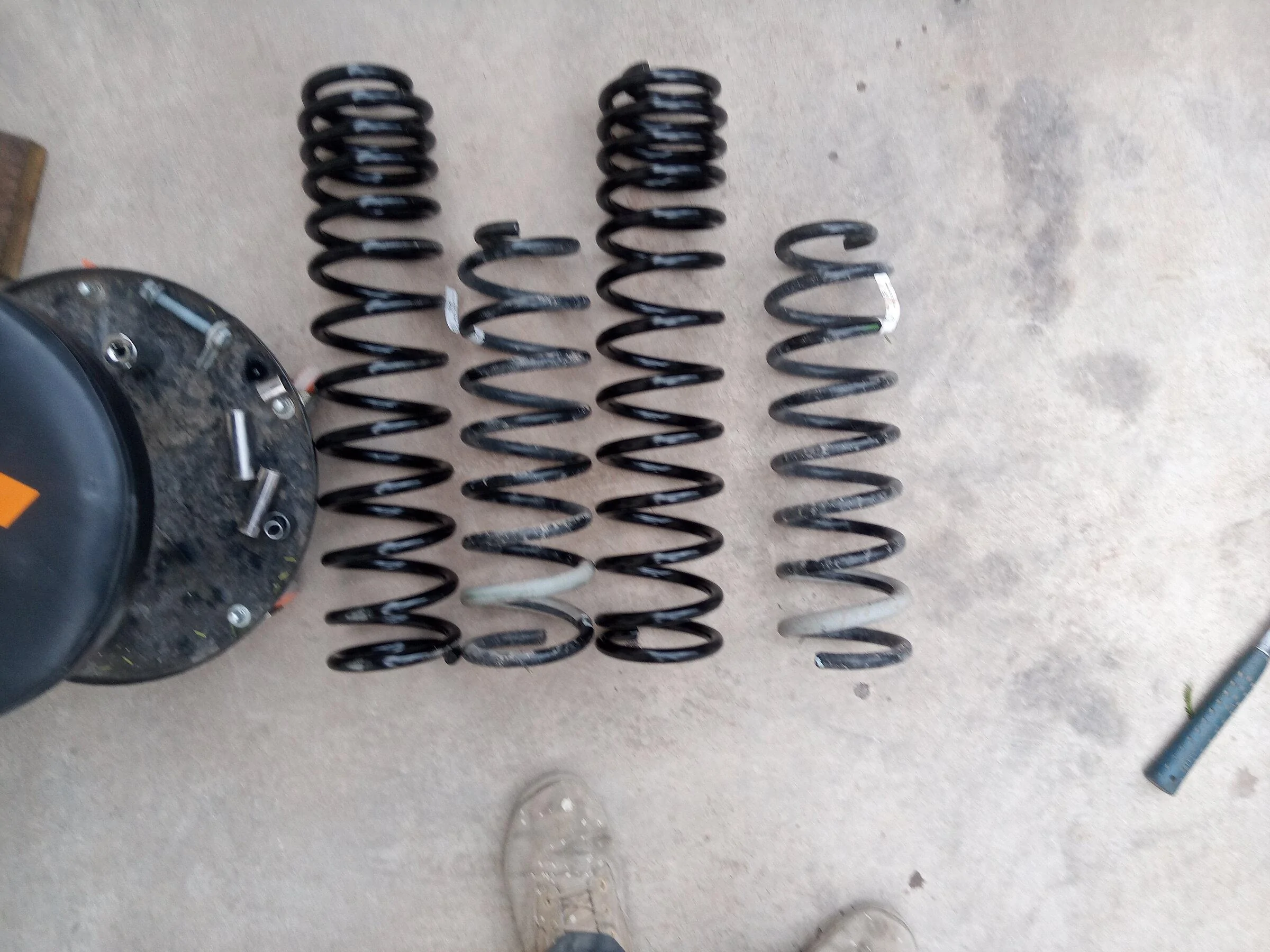

Rk 3" lift jtdr front springs VS oem
Jeep Gladiator Diesel coil spring rates IMG_20220115_150039
rharr
May 6, 2021
29
2,030
2,787
Tucson, AZ
Well they are a stiffer springs for sure, and it seems some of these mfrs are compensating short stiff springs with softer longer springs to give some preload. Different solutions for the same end result. I rather have some preload to keep everything in place on full droop
