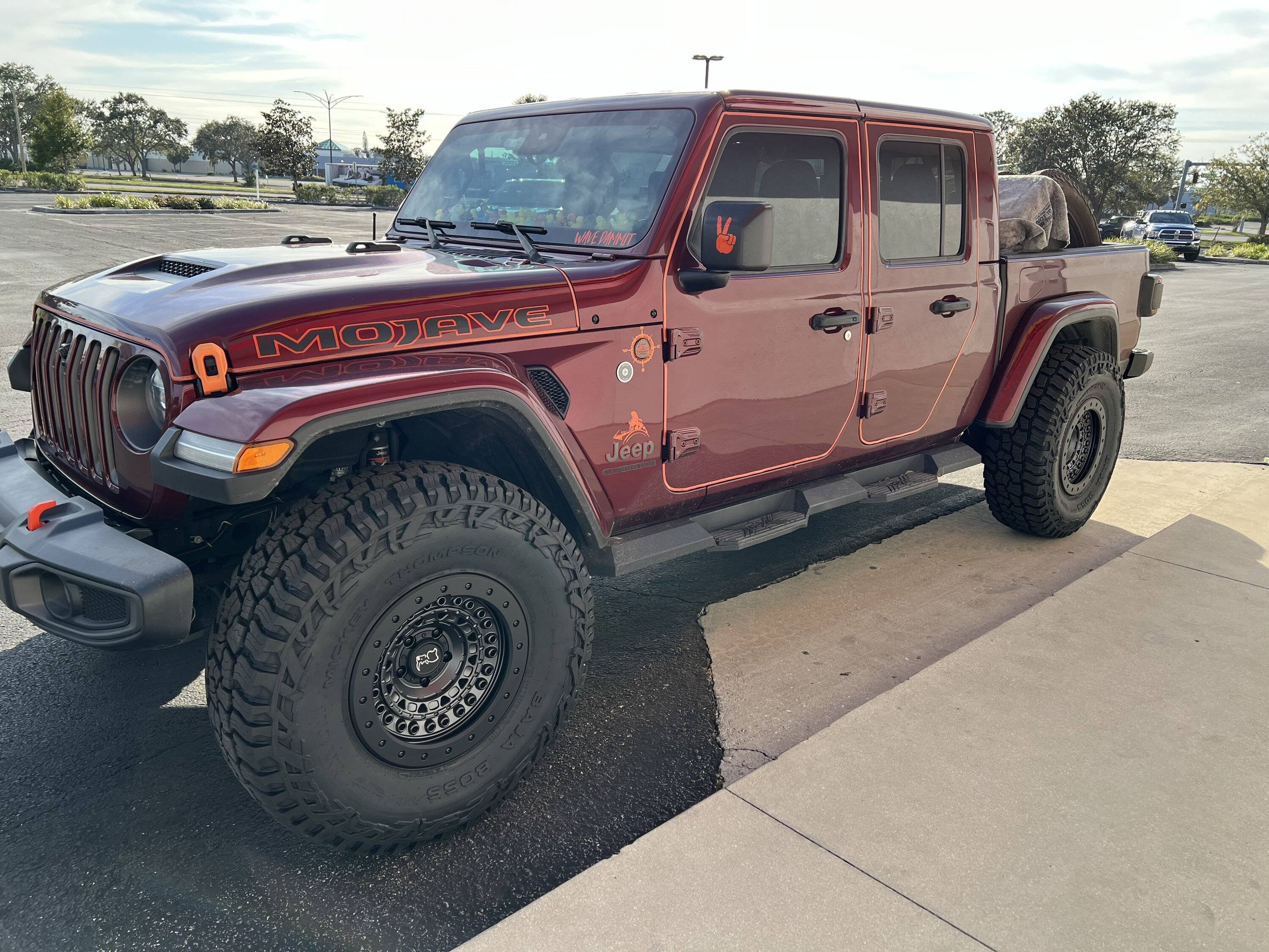

I have a '21 Mojave and am looking to put new tires/wheels on her. I want 37s, and was thinking of settling for 35s because of the extra expense involved, but am told regearing isn't strictly necessary, at least night right away.
That said, if I DO regear, I was between 4.88 and 5.13 and was wondering what advantages/disadvantages come with either.
For context, I live in Florida, so bad weather and hills aren't typically an issue. I do some off-roading, but I don't expect I'll be in Moab anytime soon either. I work from home so don't have much of a commute to contend with, but do find myself on the highways pretty regularly.

I did go with 37s--and may put a 2" spacer kit on--after all. Love them, don't regret it. Glad I chose them over the 35s.
Thanks for the input. I've heard 5.13 delivers more power, but the 4.88 is better on gas I guess. I'm not super hardcore offroad (yet, anyway) and am looking for some balance. Wish I could try it out before making a decision.
