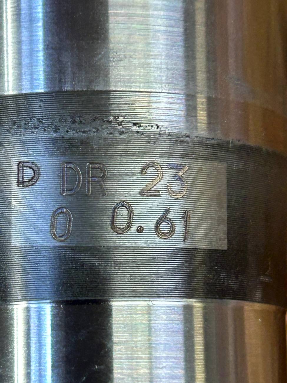

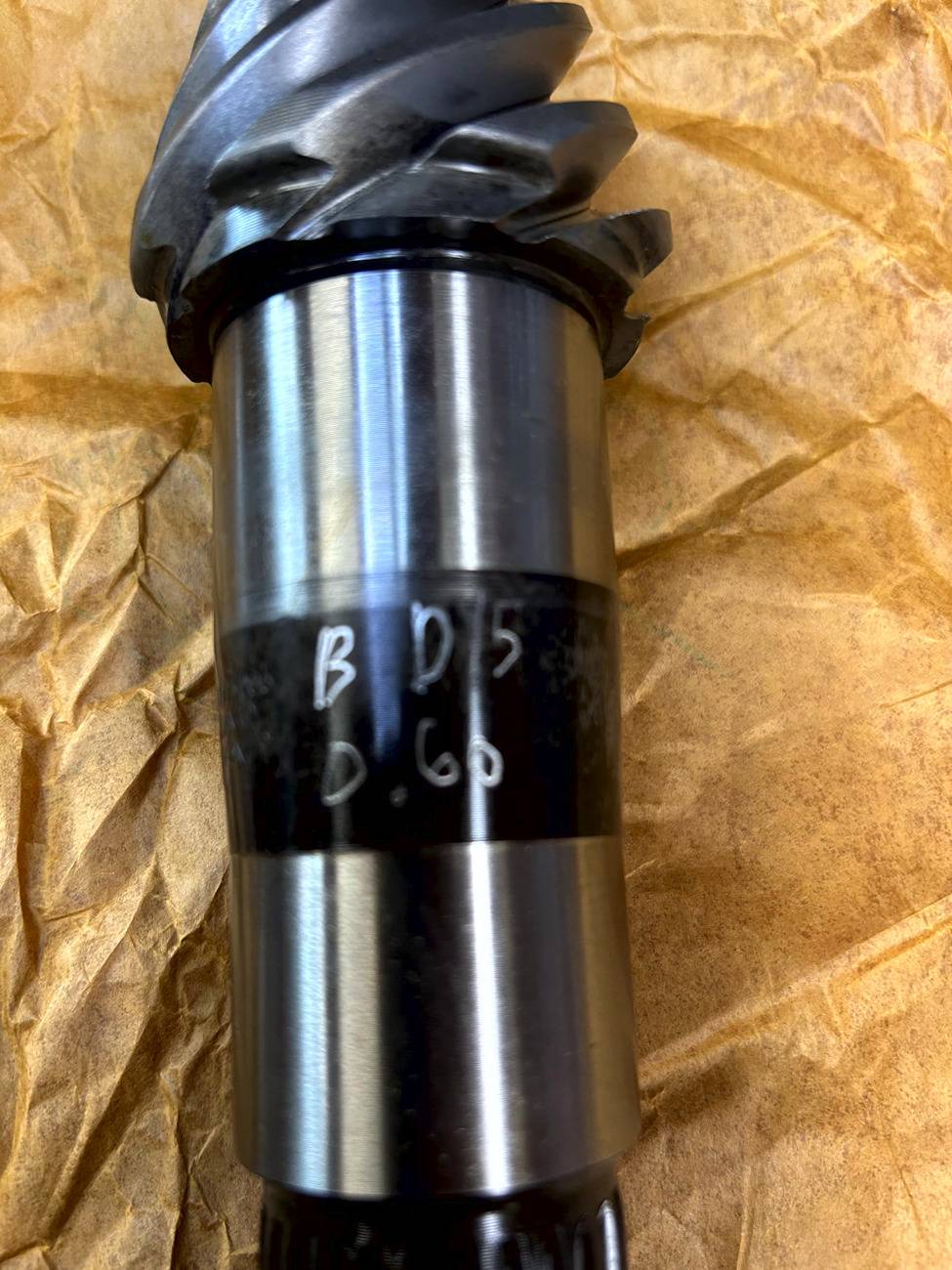

I am getting ready to install 5.13's in my JT axles. I am using Spicer gears and Master install kits. I have used various manufacturer in the past but I have found Spicer gears and install kits make the install much easier. These new Advantek pinions have different etching from what I am famailier with. Can someone shed some light on them?
I am more curious than anything, not worried about the actual set-up.
The M220 pinion is not actually etched.
All other markings are the typical Spicer part markings.

The "0" on the bottom left are the two 0-etched markings. When you pull your gears out of your Jeep, as long as they have the same 0 on the bottom/left you "should" be able to swap the new gears in with the same shim thickness as factory.

Thank you for the clarification.
