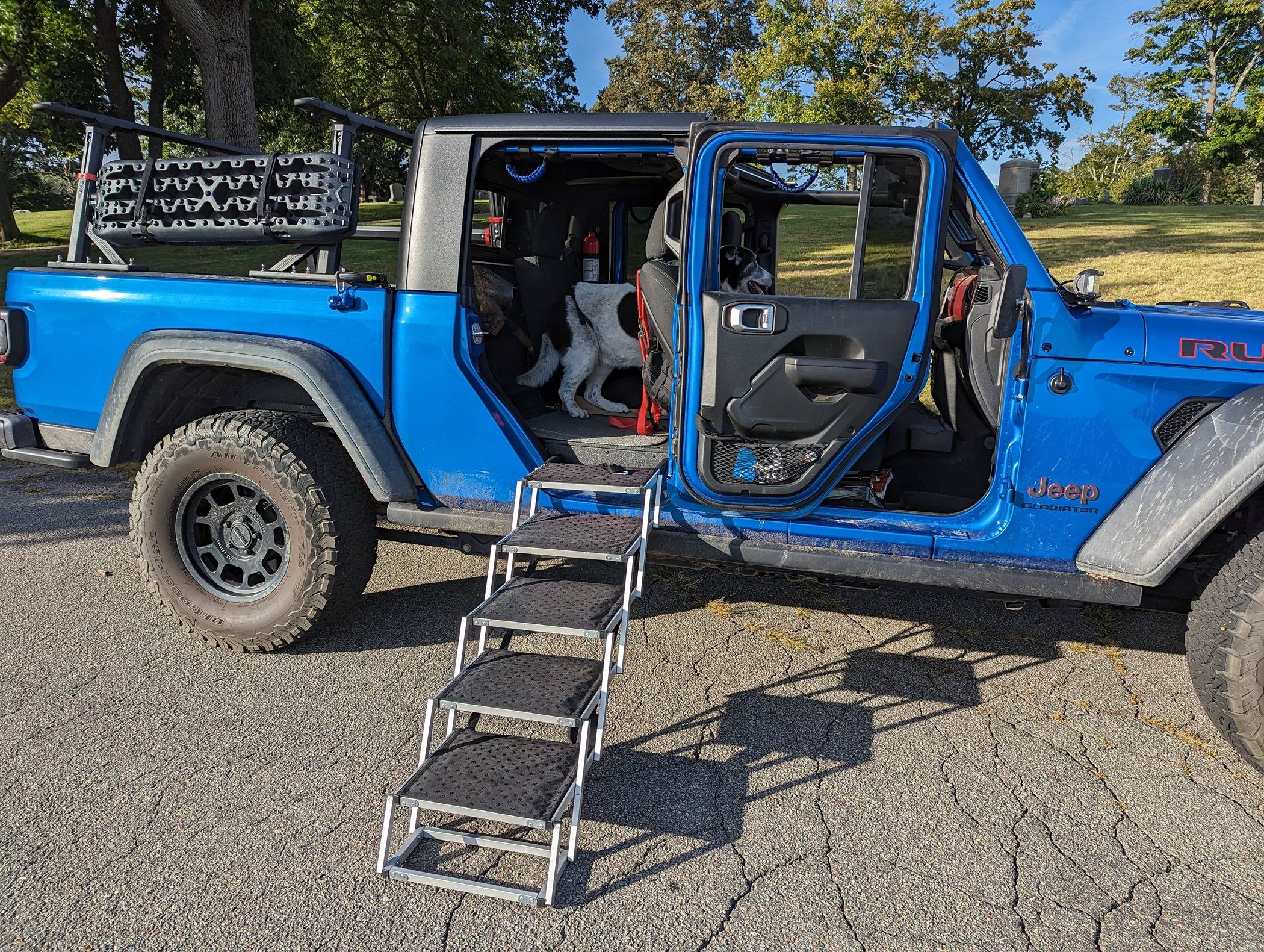

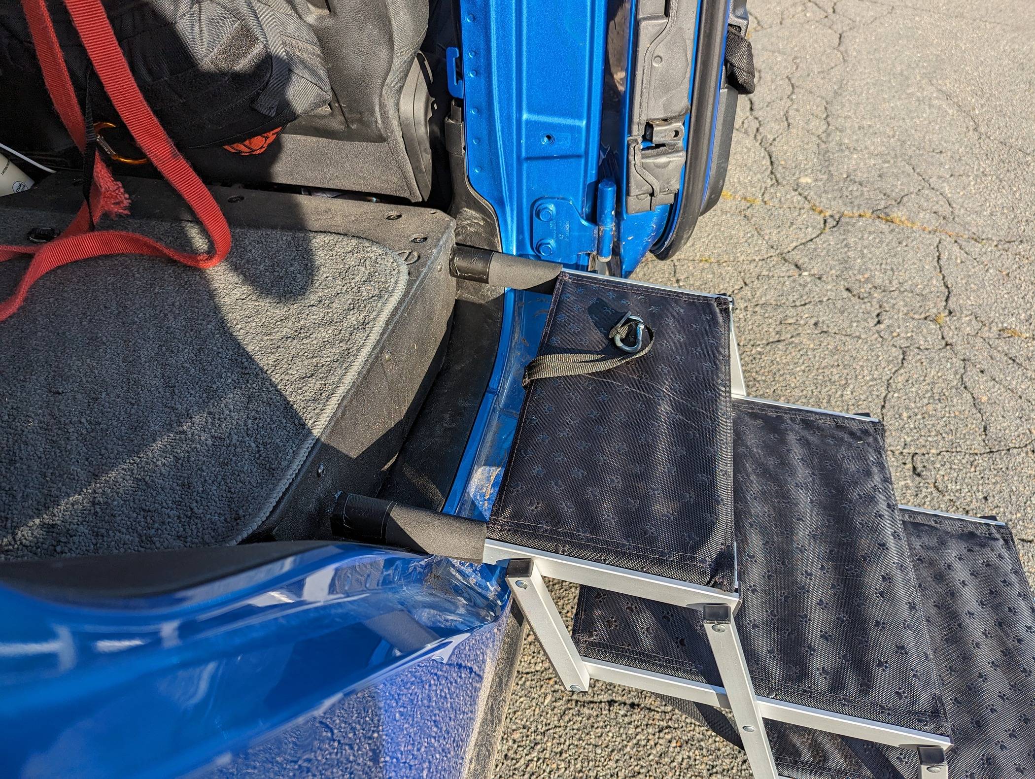

• SHW supplies short nylon straps to extend the Jeep's existing door limit straps. They're okay, but could be made from a nicer piece of webbing sewn into a loop. They also provide a cheap-o steel keyring to connect the two pieces of webbing together, however that ring distorted badly the very first time I opened the JT's door. I replaced the keyring with a ⅛" stainless steel quick-link, problem solved. Of course the factory limit stops need to be disconnected/removed.
I wonder if you could get a measurement of this webbing loop minus the quick link. With the dog stairs I use (with a Goose Gear, sorry Wes), I always leave the passenger rear door unhooked to allow the door to clear. If there's enough slack in the door wiring harness to open 90° or more, I'd love to get the ability to remote start and lock/unlock back.
We order JK loops replacement loops that are 6 loops long and then cut them down to only 2 loops. this makes it the correct length. Also, no need to apologize about Goose, its a great product. Some people don't need the drawers, and for your case it seems like the low platform is the way to go.

on a tangent, how big are those stairs folded up?
