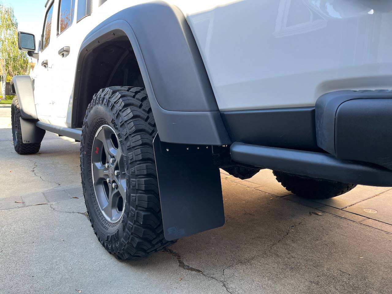

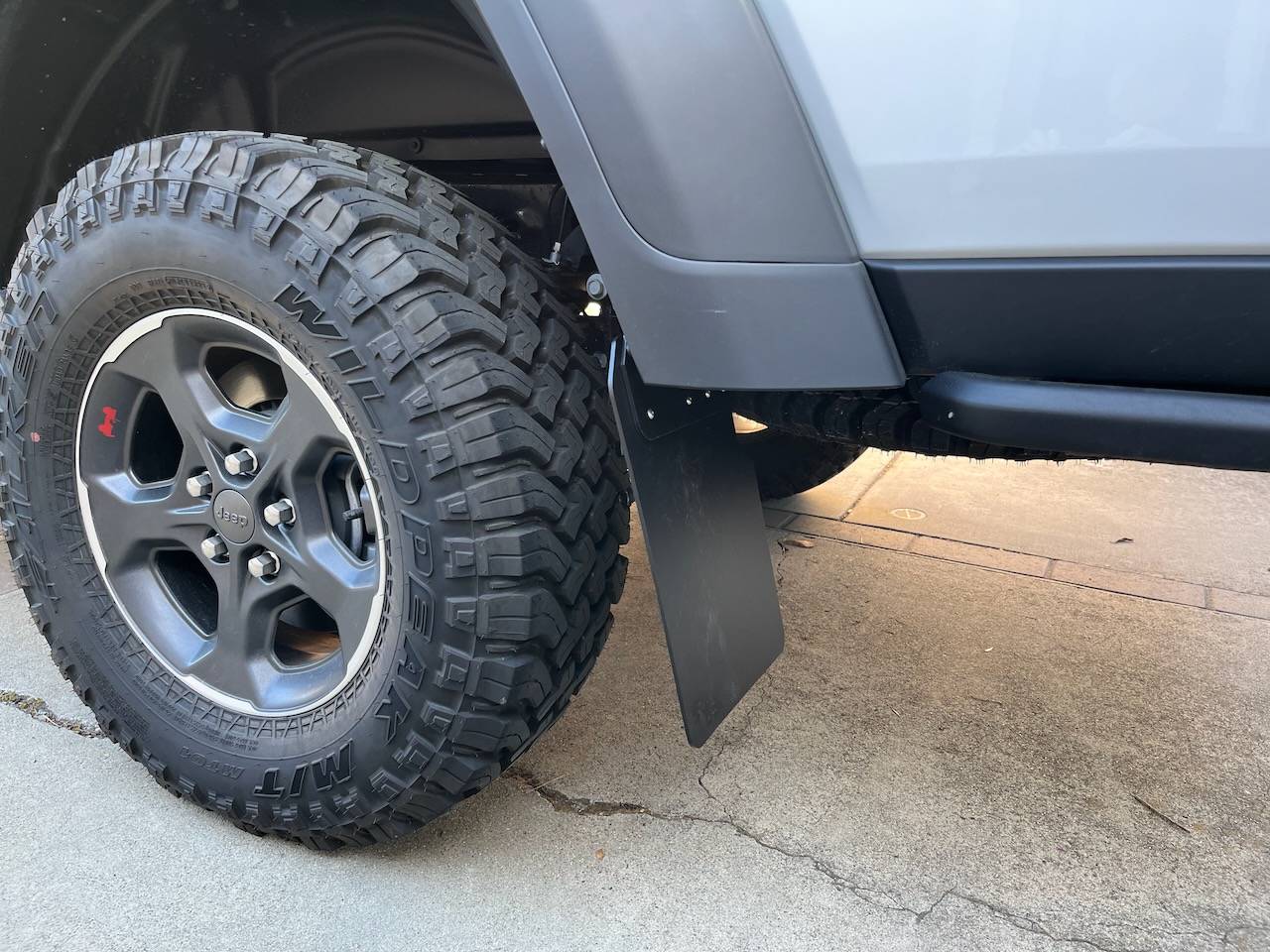

We are running Rokblokz mudguards, but I don't get the impression they are doing much. If they do, the Jeep is even worse in getting itself dirty than I thought. I have cleaned the Land Cruiser a few times after bad weather outings and I've never seen such a frigging mess as on this Gladiator.
