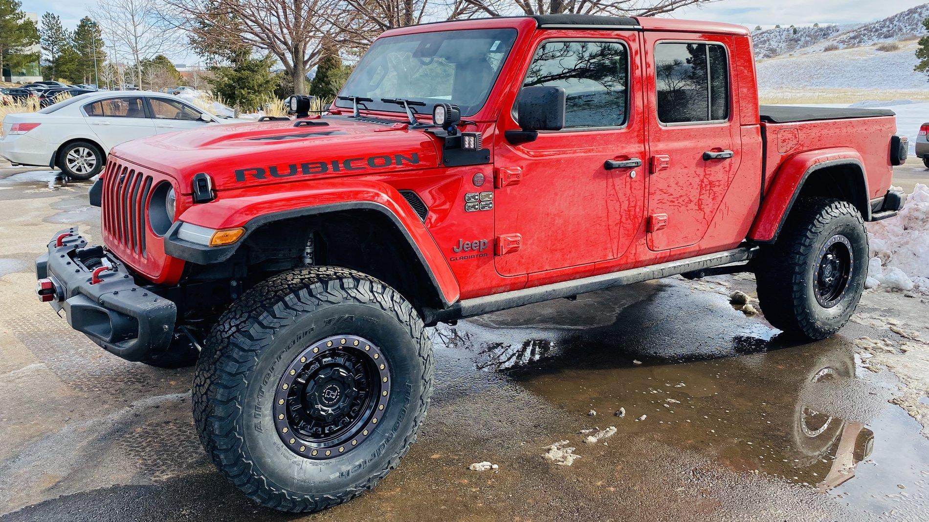

Have you disconnected the track bar to see if it self centers?
Disconnected track bar and now the axle is centered. Thanks for the tip!

I think you were given information and help. He told you to do more than just throw parts at it. You could have bent or damaged your axle tube, steering knuckles, axle Cs, LCA mounts, UCA mounts, trackbar mounts, steering box, drag link, tie rod, trackbar, or even internal components. The brackets could look fine but still be out of spec. If you mess it up you could end up driving like this
Jeep Gladiator Smacked a curb need advise 47580-925b5d8422d256434e676fbef28cd56b
You were advised to check the TooT (toe out on turns) and SAI (steering axis inclination), below are a couple links to read up on.

If the axle is not centered then either track bar bracket or the bar is damaged. Period.

The stock JT tie rod, track bar, and draglink are made of aluminum. The good news is they bend so the expensive parts are protected from damage when you smack a curb. The bad news is they bend and they're one-time use items.
The best news is you can replace the OEM stuff with a Synergy HD steering kit and a Steersmarts Yeti trackbar and it makes for a much better frontend. Tracks straight, smooth and confidence-inspiring. If you're really feeling adventurous you can also add a Synergy track bar and sector shaft brace and eliminate steering box wobble too.
All fixed. Thank you for those who offered the tips!

Synergy is the way to go! Glad you got it worked out :like:

WOW! Looking good and congrats on getting it sorted.
