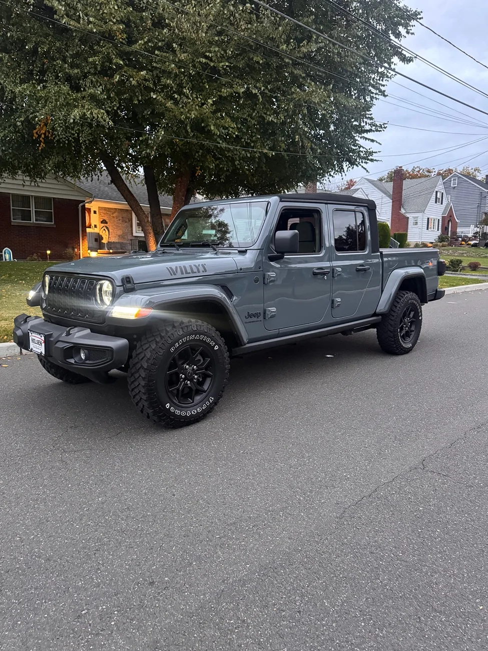

just picked up my 2024 jt willys! traded in my 20 wrangler sport 2.5 teraflex lift and 35s. this is my first gladiator so I’m trying to decide what lift to put in it. I definitely want to do a 3 to 3 1/2 inch lift. It’s a weekend warrior and still my daily driver so on top of it performing well I want it to also drive well i definitely also want lower and upper control arms track bar ect to make sure castor and everything is good. I was thinking about the Clayton or metalcloak lift im not opposed to other lift suggestions but I’m still deciding and their price differences are pretty significant if anybody has any feedback or information on lifts that would be really great. Also, I will be re-gearing because I will be running 37. I’m just not sure if I need driveshaft front and back or neither. and if you could show me your rig set up, that would be pretty cool, especially in the anvil color.
Jeep Gladiator need help picking a lift! IMG_3138

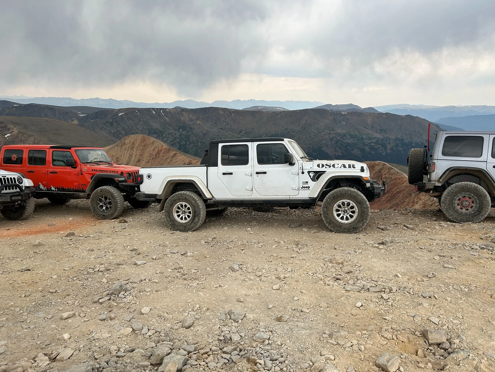

I have the 3.5" Metalcloak Game-Changer Lift, Rock Sport Shocks, new Adams front drive shaft, 4.88 gears, Front E locker, JL Tazer mini, RockTrix RT111 17" x 9" Wheels, 37" x 12.5" x 17" Toyo Open Country R/T Trail tires.
I love it.
Jeep Gladiator need help picking a lift! IMG_1109
