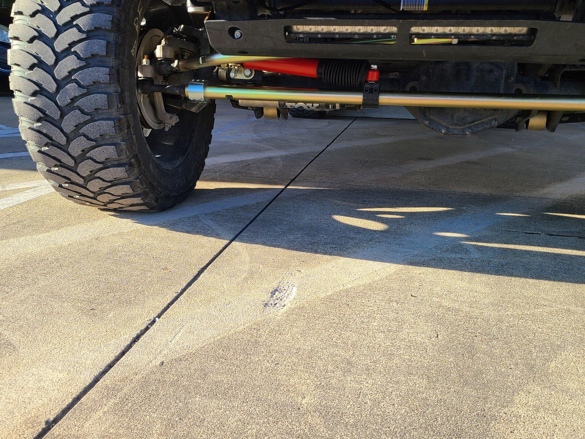

I'm running Metalcloak HD steering kit. I'm pleased with everything except for the Rocksport stabilizer...it is not very HD. I actually rigged up my Fox ts stabilizer and the Rocksport to work together.

I forgot to mention that looks good. Got a pic of the new stabilizer on?

You have to zoom in on that pic to see the Fox stabilizer between the axle and tie rod. I ordered a Synergy relocation tie rod clamp from Amazon for $60 and used it for the Fox stabilizer on the passenger side of the tie rod. I installed the high clearance rocksport in its designed location with the MC clamp in the middle of the tie rod.

Oh shit. I didnt realize you were running both stabilizers. Haha!

Yea, when I took the TS off and just ran with the Rocksport it didn't do very well. I've since changed tires and realized that I had 2 tires that were out of round and were contributing to DW.
