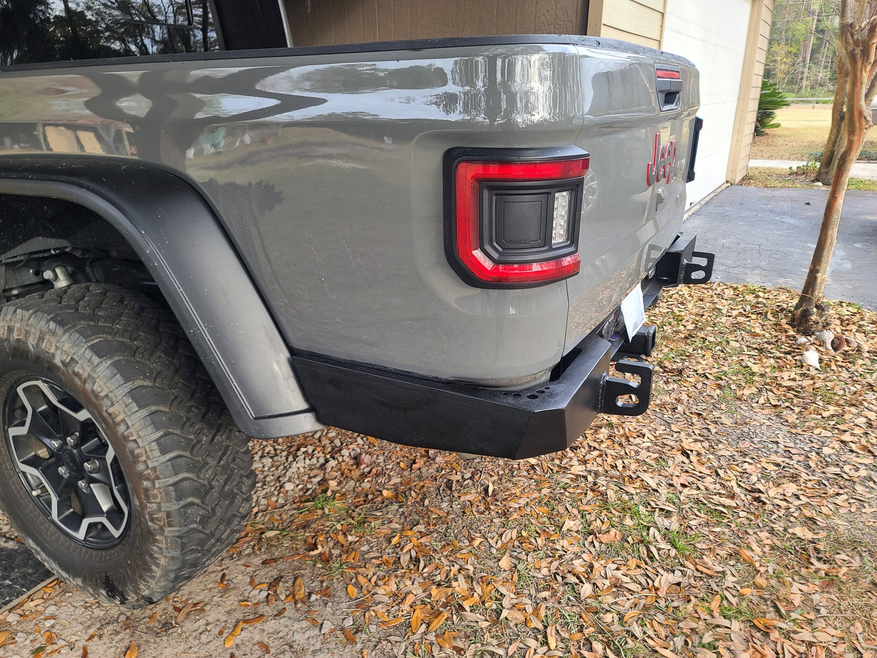

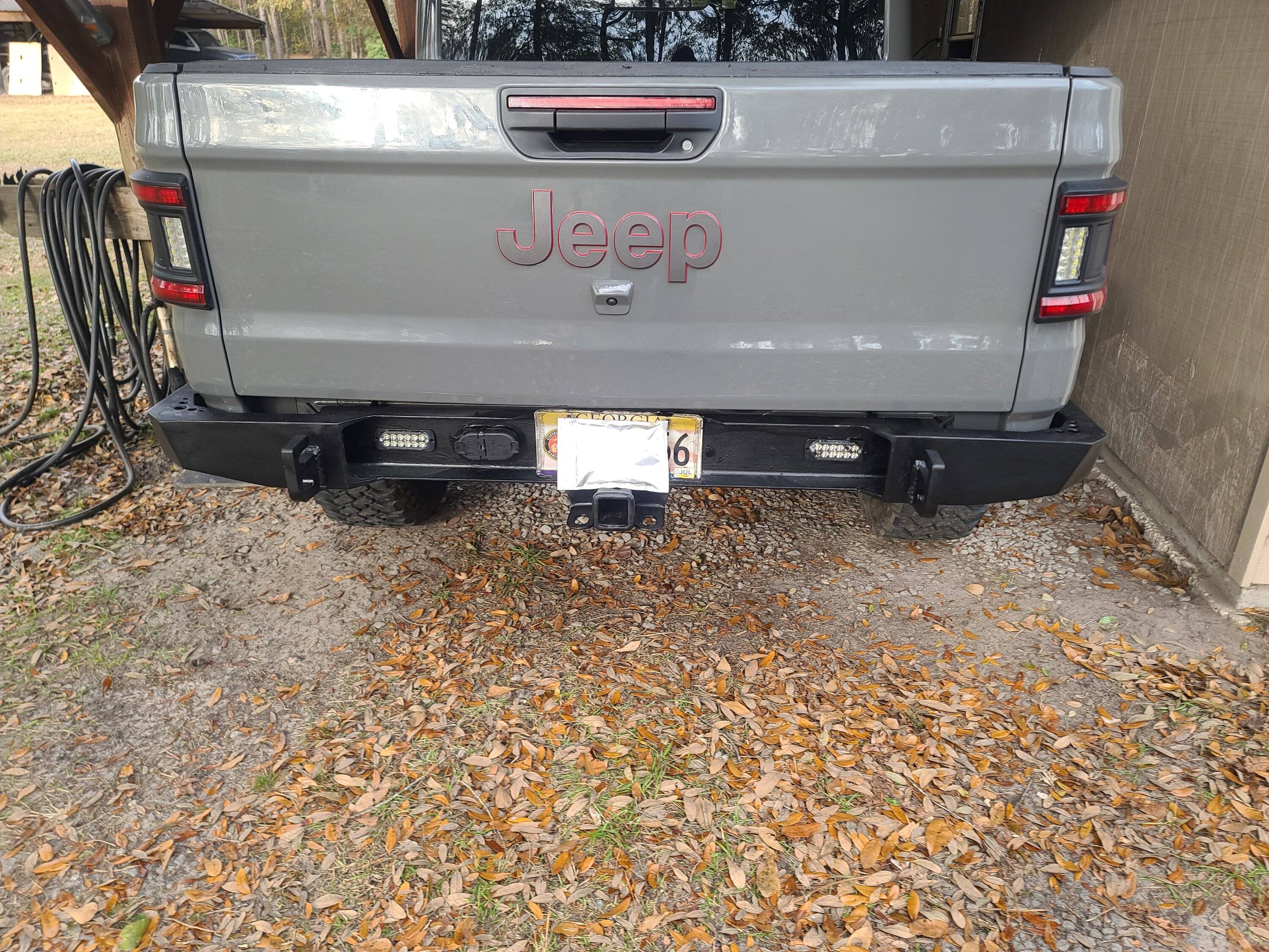

Got the JT fixed up with replacement bed, and instead of bobing I made an high clearance all steel bumper with integrated hitch.
Escape.idiocracy
Rich
Jan 23, 2022
1,566
1,824
PNW
Jt
Hitchhiker
Dude! This is like a teaser photo. Should make a thread with a bunch more photos- how did you do the frame tie in’s/tow points, side supports etc.
This looks really good!

Bumper started as 5 in channel, then nested frame rails to heavy angle, some 5/16 plate and few brackets and the hooks from Ballistic fab. I wanted to gain departure clearance. Gained 5 inches and can high life the truck from sides and rear that would do nothing but scratch the paint - which is rattle can rustolium bed liner
