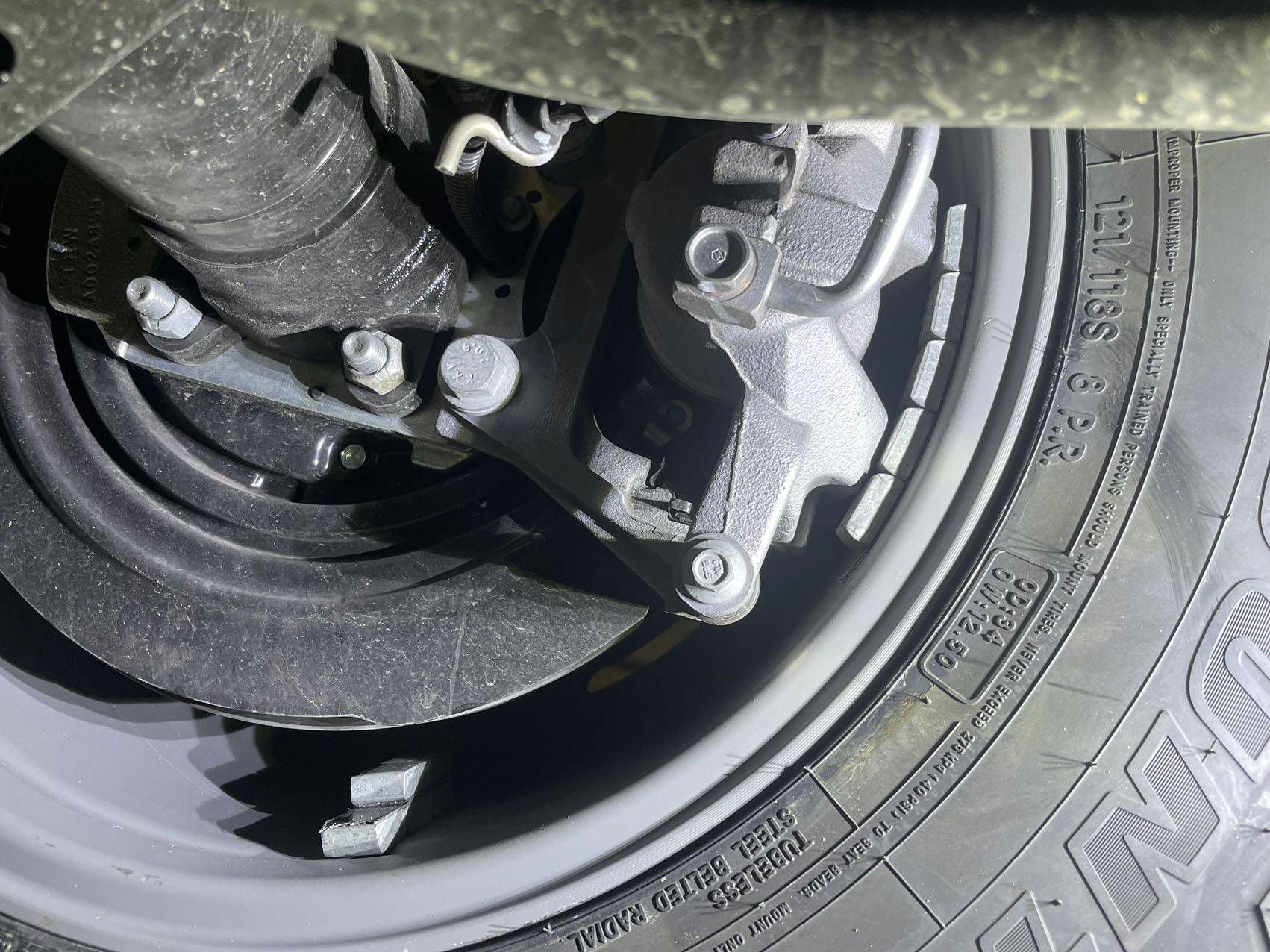

So pissed off! Weird noise after install new rims! Never heard it before. Anyone knows why?

This is why... WTF
I just had the same issue after Goodyear installed some tires on my JT. They swapped them for the thinner weights but it pissed me off that they didn't catch that.
WILDHOBO
Sep 24, 2021
74
11,755
17,892
2021 Gladiator Rubicon
Network Engineer
With todays clearances, I don’t know why tire shops use anything but thin weights to start with.
