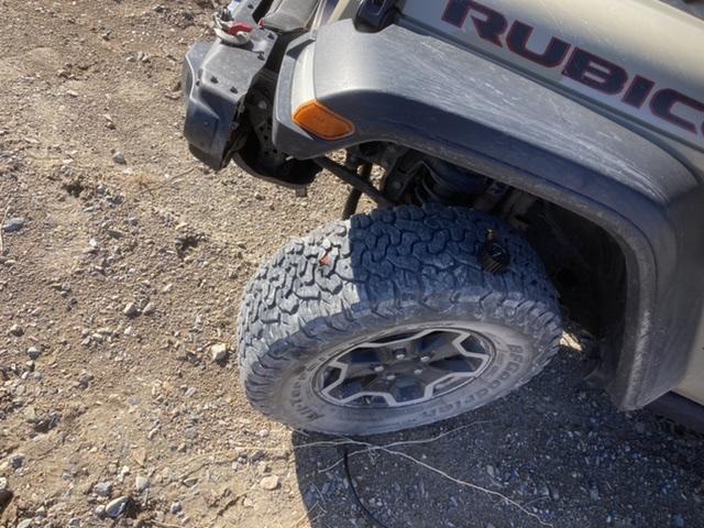

So, I ruined a tire in Death Valley, (punched a rock through the center of a BF Goodrich KO2). The Tread measures about 9/32. I was given a pro-rated refund for the damaged tire but the salesman refused to sell me one tire. He claimed that due to this being a 4x4 that the store assumes liability for damage to the 4x4 system due to the tires being mismatched in diameter (by 6/32, I think).
I Have driven 4x4 of all makes, and conditions, with many different tire sizes and combinations, as well as being a mechanic and do not believe this at all. I was unable to talk the manager out of this course and they wore me down and I bought 4 more tires.
Has anyone else heard of this and, if so, can you point me to the source?

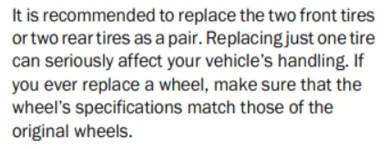

If it is their policy, I guess you have no choice. If it were actually important, it would be in the Owners Manual. I can't find anything in the manual other than:

If it was an issue, they would put it in the owners manual.
My wife drives a AWD 2021 Honda Ridgeline and there was a note about replacing all 4 if possible but if not possible, replace front or rear in matched pairs.
