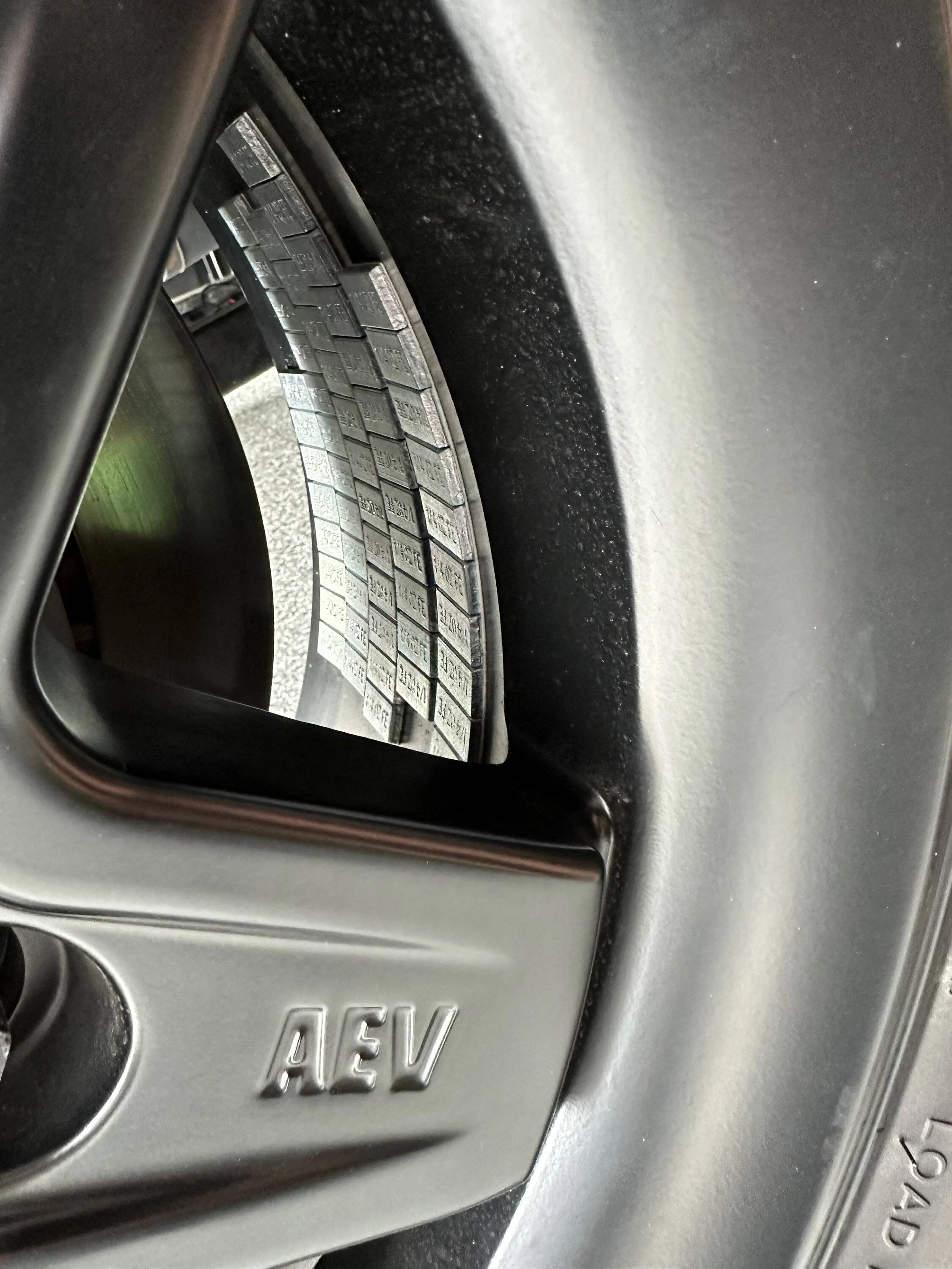

KM3 39x13.5x17 just took a tad of weight to get right. They rotated tire on rim several times. Will be replacing this tire for sure.
That's what I have as well, km3 39s. They just seem like really shitty balancing tires sadly. I've honestly been looking at installing some centramatic wheel balancers in concert with the dynamic balance to quiet the shimmy that comes and goes as they wear.
