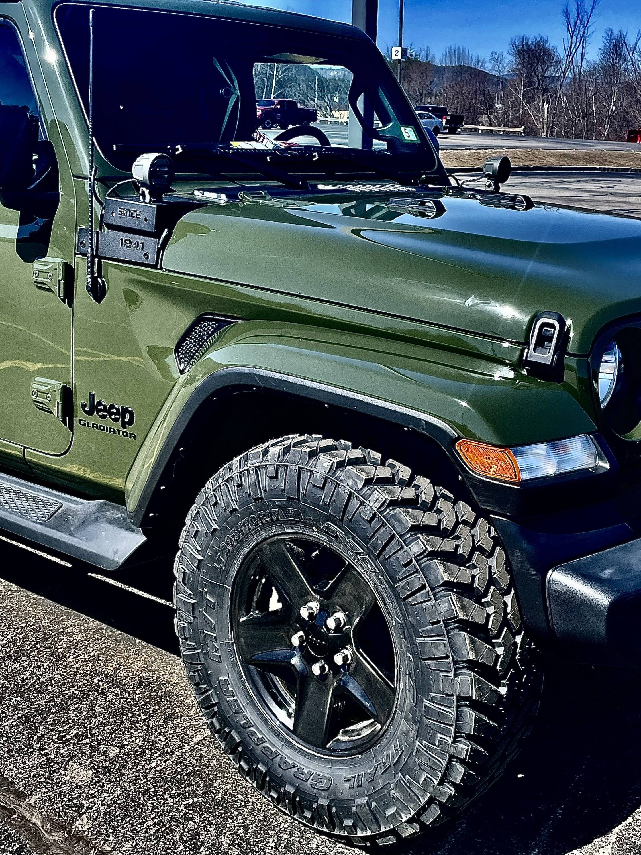

Mine was weak from the time I bought it dec of 21 I double tap the brake to bring it up . I told them this but they never looked at it during first year of nitemare issues . It’s still this way too. It really should be a recall like other said
