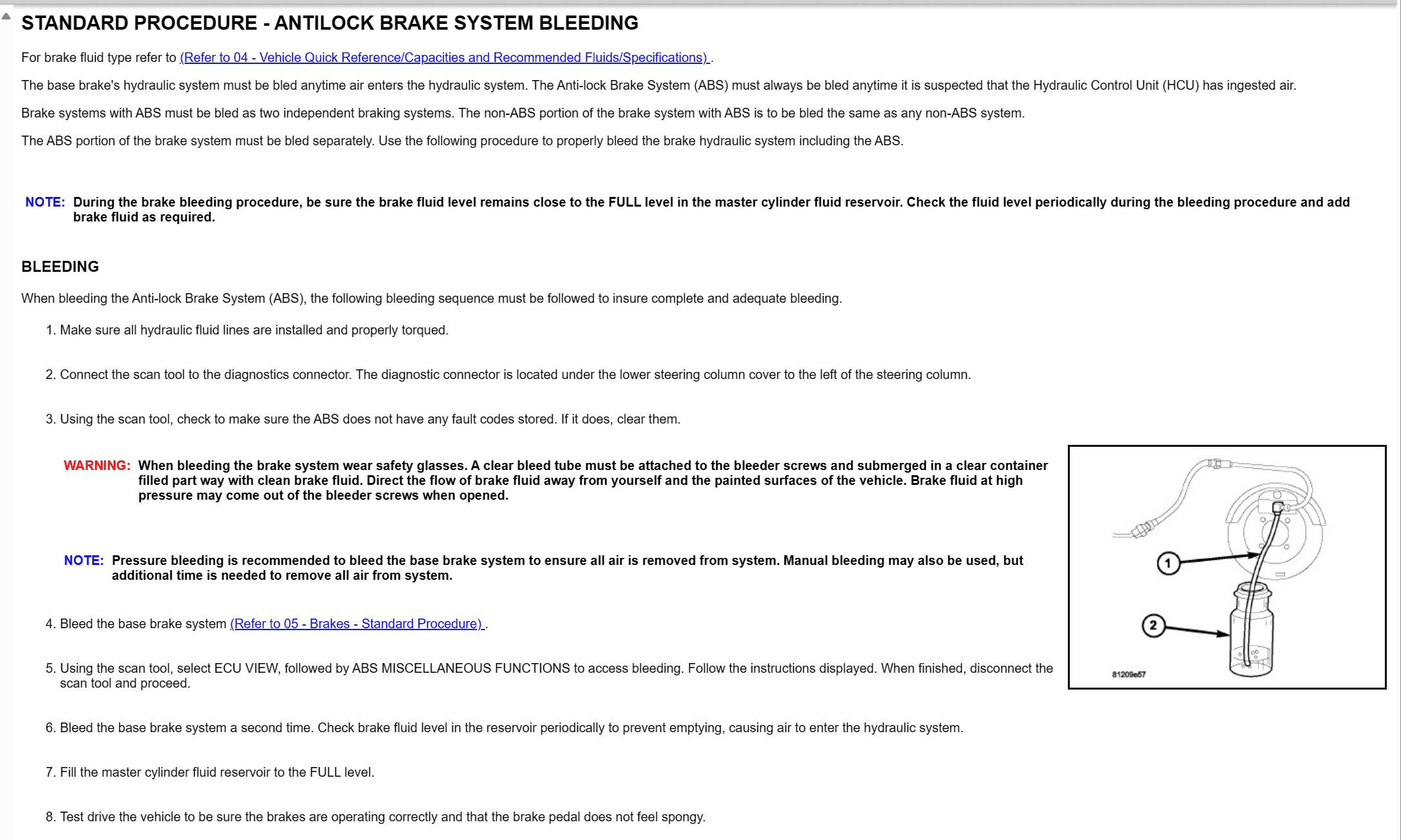

Changing brake fluid this weekend - sounds like I first do a normal fluid change and bleed.... then bleed one more time using AlfaOBD to trigger the "ABS Brake Bleed" function?

Opened the service USB since I am doing this today, figured I'd post the bleed page straight from it. If you bleed ABS they want you to do another "regular" bleed after:

Just to add my experiences to this thread, as I found this thread when trying to look for advice on working through similar issues posted here, and also this thread has some conflicting information/experiences from other owners that were probably provided with bad service/information by dealers.
I have a '23 JTRD. I installed a lift that required changing some extended brake lines. After doing the lift, I did a thorough standard bleed as I've always done on any other vehicle.
Ever since installing the lift, my brake pedal had felt mushy, though it did not seem to reduce available clamping power -- I could still lock the brakes up, though with the pedal nearly to the floor. Also the first pump of the pedal would require pressing the pedal much further than subsequent pumps. I started a habit of a short false pump on the brake pedal to get better engagement/pedal feedback. I finally had enough with the situation when running Rocky Gap -- I felt I had very little control when dropping off boulders in the rock garden as it was very difficult to precisely modulate the pedal.
I was confident that I'd bled the brakes properly, but this thread was my first introduction to the "ABS Pump Bleed". I also read a lot of the diesel-specific comments and wondered if this was just the nature of my truck, and also started second-guessing myself on whether the issue had been present before the lift install, etc. I decided it would be worth the effort to attempt to sort out the issue. So, I picked up a JSCAN license and did the following:
1. Another Standard Bleed. - No change/Improvement
2. ABS Pump Bleed procedure using JSCAN - If anything, made the issue WORSE!
2. Yet another standard bleed - OMG! Problem Sorted!!!
My brake pedal feels so much better now with perfectly positive engagement at the first tap, starts right at the top of the stroke, and doesn't fall to the floor with continuous pressure. So - this is not something ecodiesel owners need to live with - it appears simply that proper brake bleeding in this vehicle is more difficult than others I have experience with and a standard bleed likely won't resolve issues with air in the lines/components. Also, make sure the follow the ENTIRE procedure posted by ecidiego (post #41) - It may seem like an excessive amount of brake bleeding, but my issue didn't resolve until another round of normal brake bleeding after doing the ABS bleed procedure.
