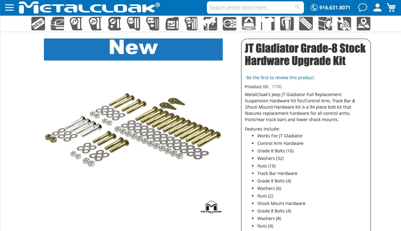

Bought these because the Grimm Off-Road Kit has been on back order since forever. But I over looked that all these bolts are Grade 8 while the factory bolts are Grade 10.9. The max torque values are significantly lower on these Grade 8 bolts.
Is it safe to assume that, if I followed Grade 8 torque values I would be way below factory spec. If I followed factory spec, I break these bolts.
What should I do?
Jeep Gladiator Sorry... I'm an idiot... Grade 8 is not the same as Grade 8.8 Screen Shot 2023-10-17 at 8.43.41 PM

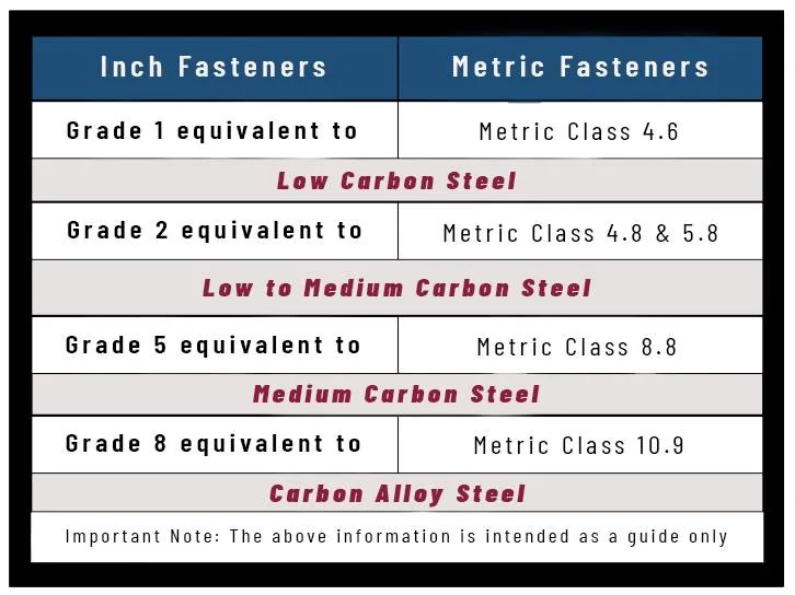

I believe SAE (or imperial or whatever you want to call it) grade 8 is roughly equivalent to metric 10.9.
Might have to buy some new wrenches
DAMN YOU SAE... DAMN YOU TO HELL!!!
Jeep Gladiator Sorry... I'm an idiot... Grade 8 is not the same as Grade 8.8 Inch-vs-Metric-Strength-Grades-Chart-

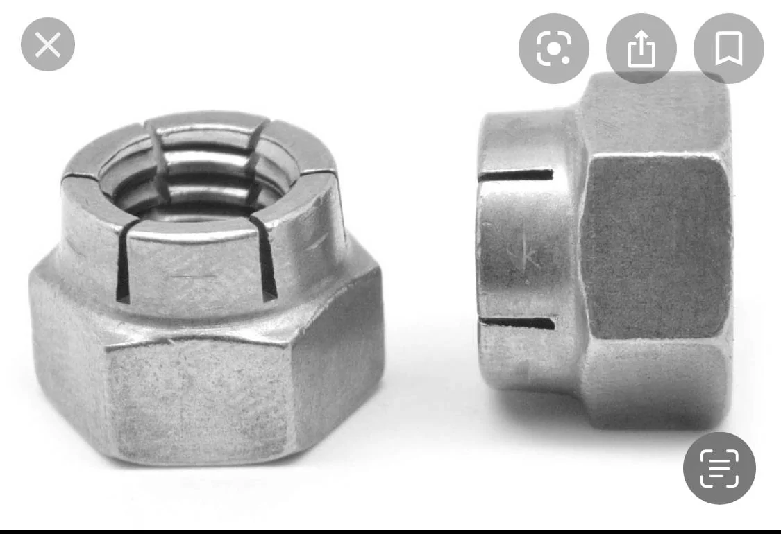

Mark the nut/bolt with a paint pen…. ???
Super extra paranoid after the paint pen…. Buy flexloc nuts. ? $10-12 a piece but hands down best nuts out there.
Jeep Gladiator Sorry... I'm an idiot... Grade 8 is not the same as Grade 8.8 IMG_1835
