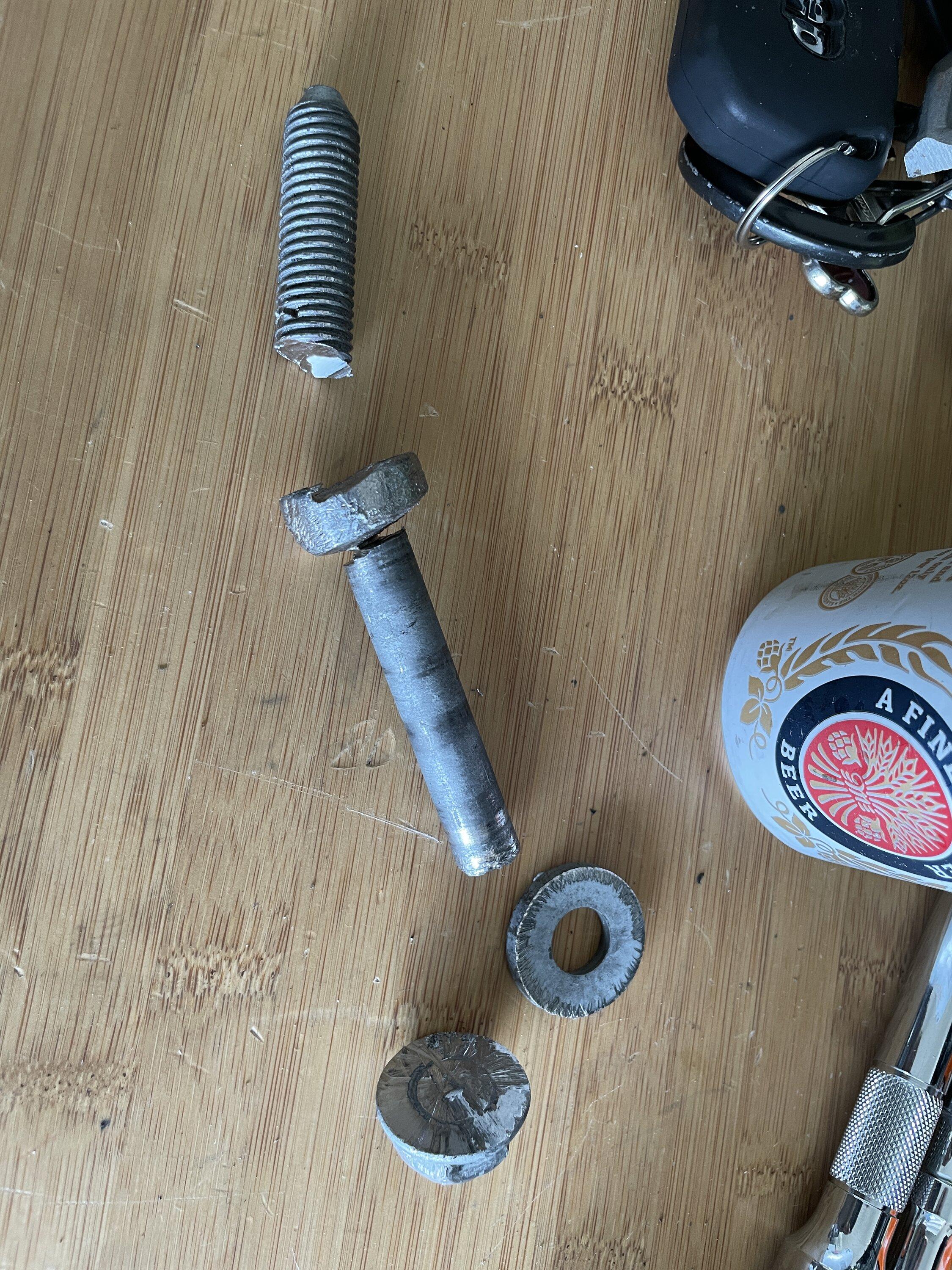

Well. After about 6 hours laying across the engine bay with a compact sawzall, 21 Milwaukee 6-inch 24tpi sawblades, and a lot of cold beer in the 102 Texas heat while my dad sat on a bucket slowly rotating the spinning upper shock bolt I was finally able to cut out the spinning press nut..
From top to bottom in the pic is the threaded portion of the bolt that made it through before the push nut broke loose in the shock tower. The mangled mess still attached to the smooth portion is the f-ing press nut that broke free of its mount and was spinning freely. Then the mangled washer and bolt head.
So damn tedious! There is a small black collar left in the shock tower leftover that’s just spins and spins and spins.
I just can’t believe that FCA decided to use that shitty push/press nut setup. I felt sick the whole time taking a sawzall to my $65k JT with 3100-ish miles on it just because I wanted to change the shocks. Not to mention that I was cutting around brake lines and the main wiring harness. Man it was work.
I ran a new 14mm bolt through there and put a washer and nut behind it and was able to torque it down to 80 ft lbs. Rattling is gone and shock is mounted sturdier than before.
A word of advice when torquing down your upper shock bolts…take your time and be careful. It is not a welded nut in the frame. That push nut (at least on my Mojave) was way too delicate for my liking.
It’s a Jeep thing I guess.
Damn. Sorry you had to go through that. Nice work making it better though.

Weird, most any other bolt on the Gladiator suspension is a all thread bolt so this kind of thing does not happen. Glad to see you got through it.
Do you by chance have the part number for the m14 bolt? I did the same thing this past weekend. Called the dealer, but they get me a m12 bolt for a regular jeep, not mojave m14. So stuck trying to find the correct part number. Thanks
