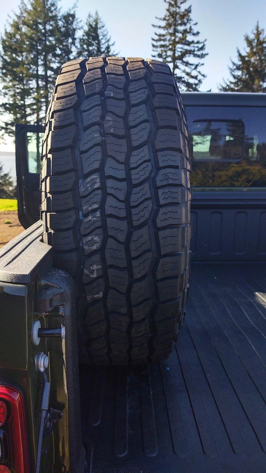

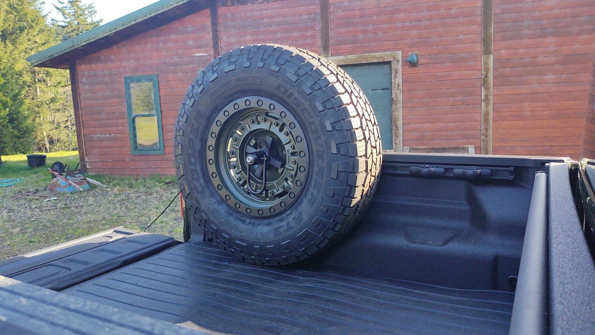

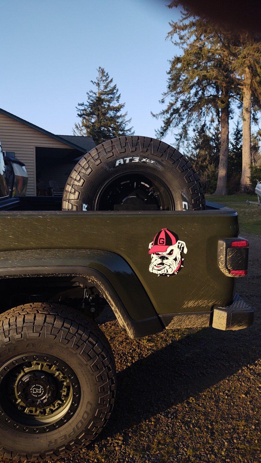

This works for Me-If You look at the rear window of the Gladiator a Good Portion is Blacked out anyway and this Mount in No Way blacks it out. WILCO Bed Mount. No Problems Works WELL!
Jeep Gladiator Spare Tire Mounting Options? IMG_20210326_185222555
Jeep Gladiator Spare Tire Mounting Options? IMG_20210326_171835799_HDR
Jeep Gladiator Spare Tire Mounting Options? IMG_20210326_171903272
