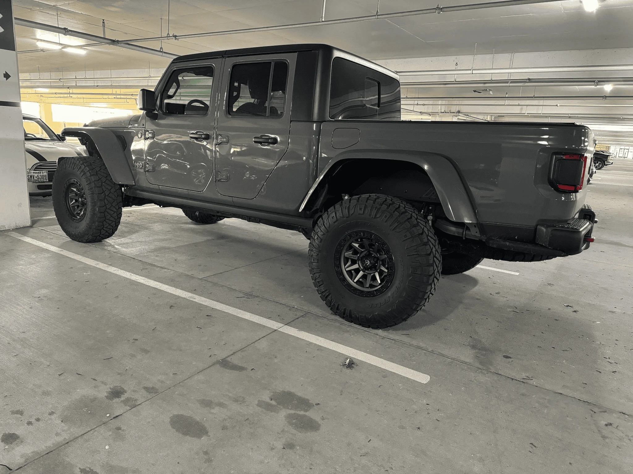

I would lean on “need” I am not sure what your setup entails- I am running longer shocks- compressed: 17.91, extended 28.41” zero bump stop pads/extensions, with a 3/4” daystar spacer…. 37x12.5’s 17x8.5 et0
The fatty rubs…. by rubs I mean touches…. The inner liners (this is with the bump joust removed)- full stuff….
The “touching” of tire to inner liner is so minimal, that even when bound up it’s not worth adding bump stops or pulling the liners…..
Bottom line- if more uptravel space is needed and pulling the liners would do it- then do it…. Otherwise? If not needed, why?

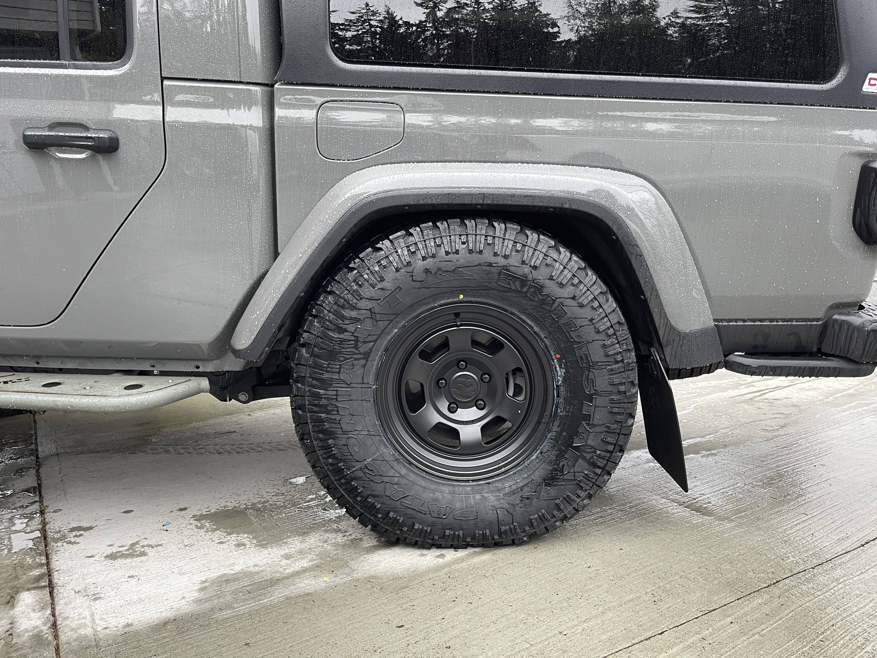

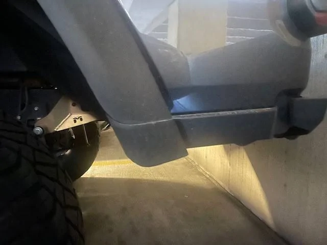

I had the same concern about the exposed body holes, so I cut out part of the rear lower and trimmed it as best I could.
Jeep Gladiator Split rear fenders? Fender

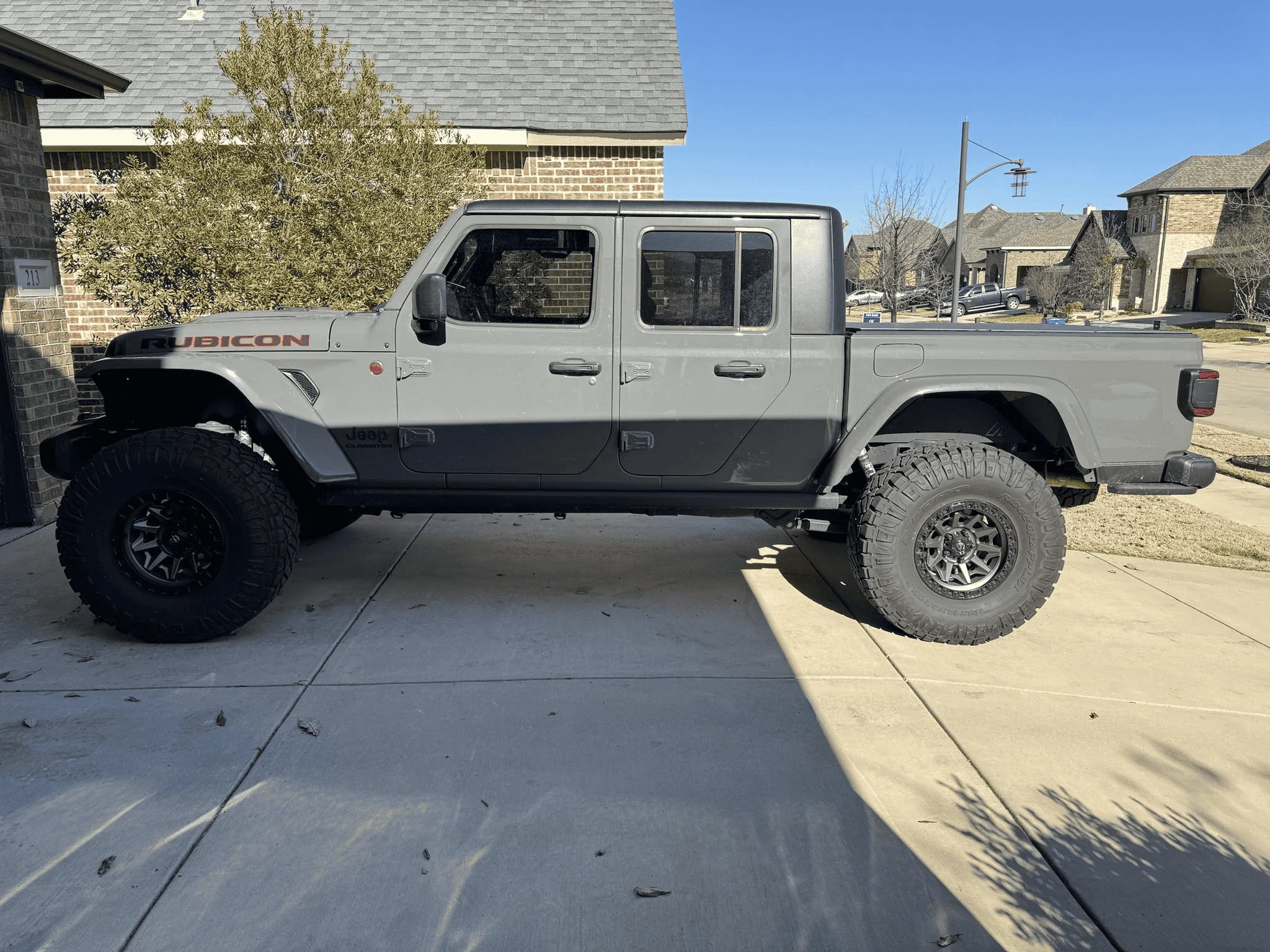

Went ahead and just did it, too much half finished projects in the garage. I like it, tons of room, pretty sure I could fit 40s now (currently on 38s with a 2.5" lift)
Jeep Gladiator Split rear fenders? 1704995637077
Jeep Gladiator Split rear fenders? 1704995652953
