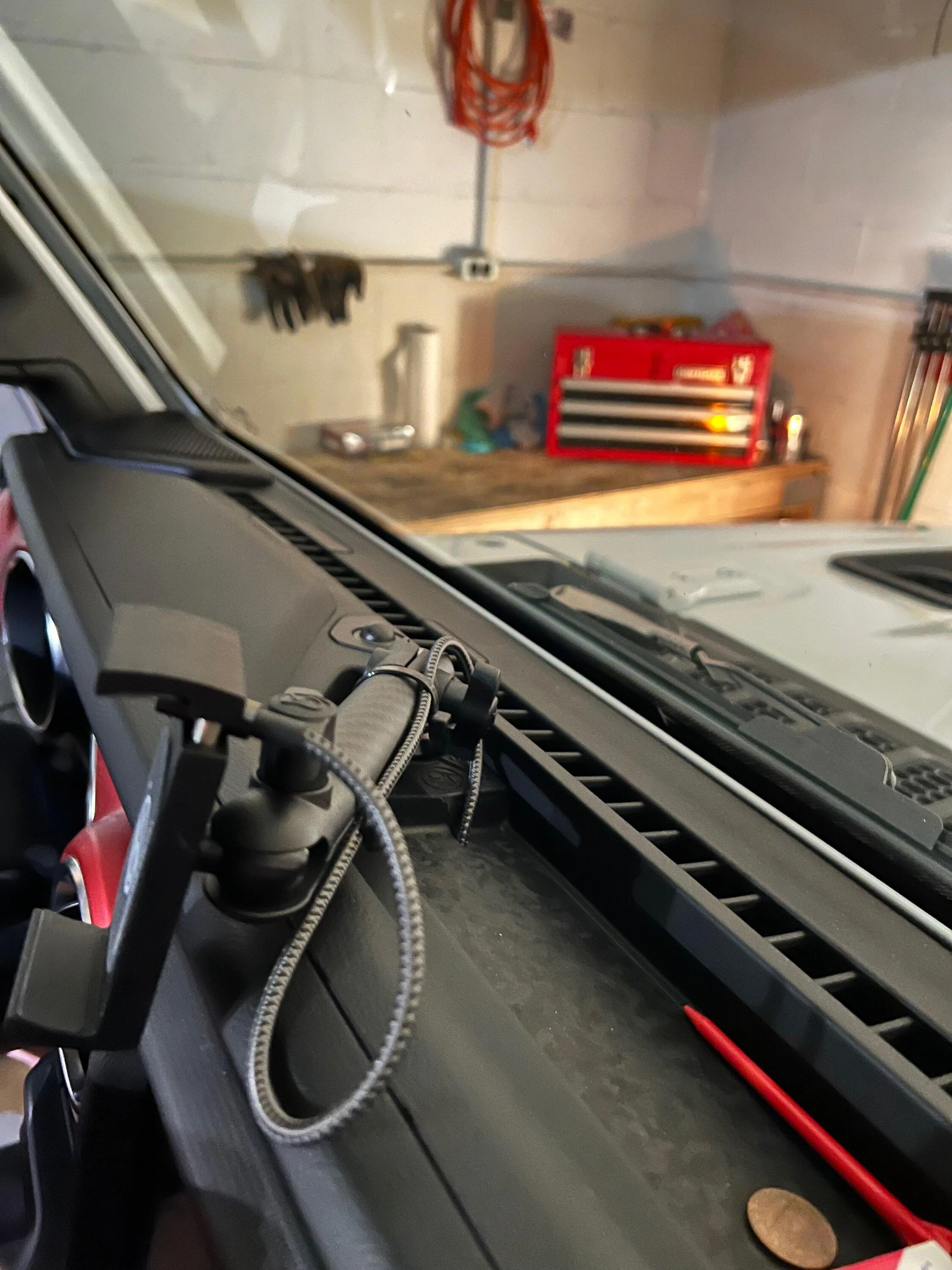

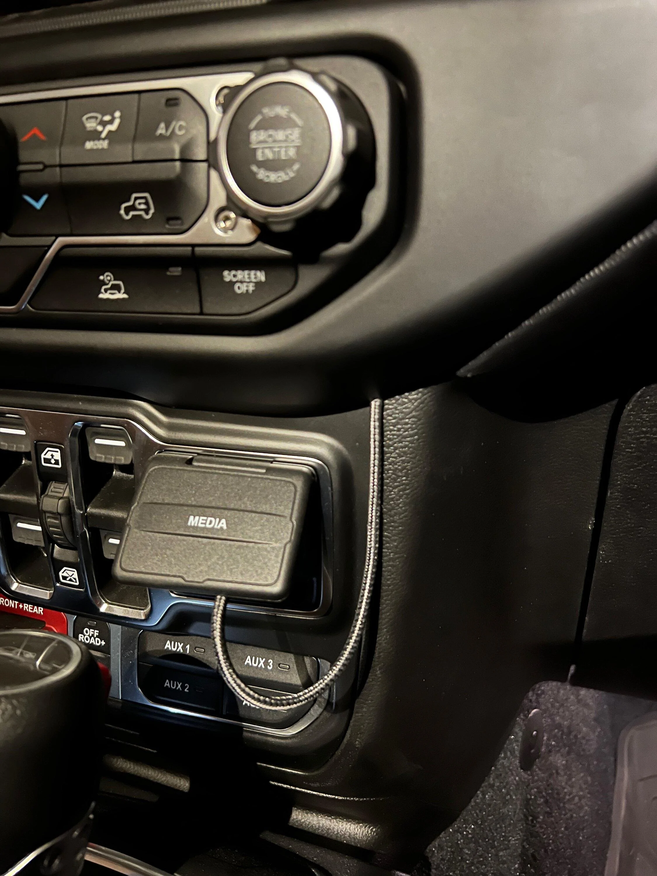

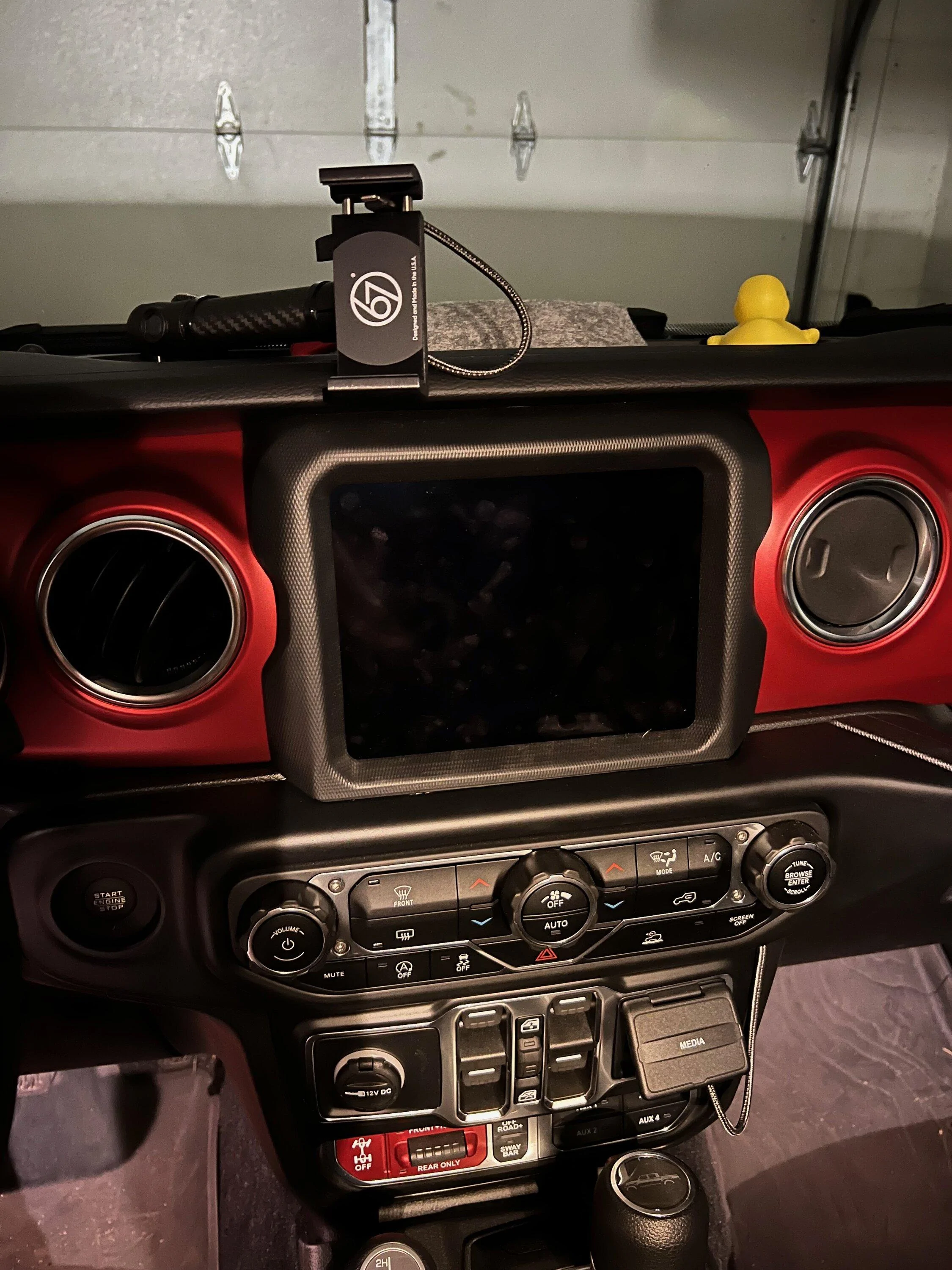

I didn’t move the media port, but I did route a cable from the media port behind the HVAC console and UConnect screen, then cut a hole out of the dash tray and ran my cable to my phone mount there. Not as clean as installing a port up too but it’s way better than having a cable swinging around and I figured I’d have less issues this way. Can share pics later—took me about 45 minutes to do.

Yes, pics please. I’m having a hard time visualizing for some reason. Thanks.
Here you go. You have to pop out the HVAC panel, unscrew the UConnect cover and pop it out, then unscrew the panel itself, but from there it's super easy to run a cable and you can access the bottom of the coin tray deal directly.
