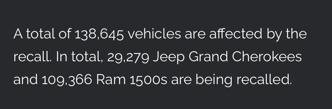

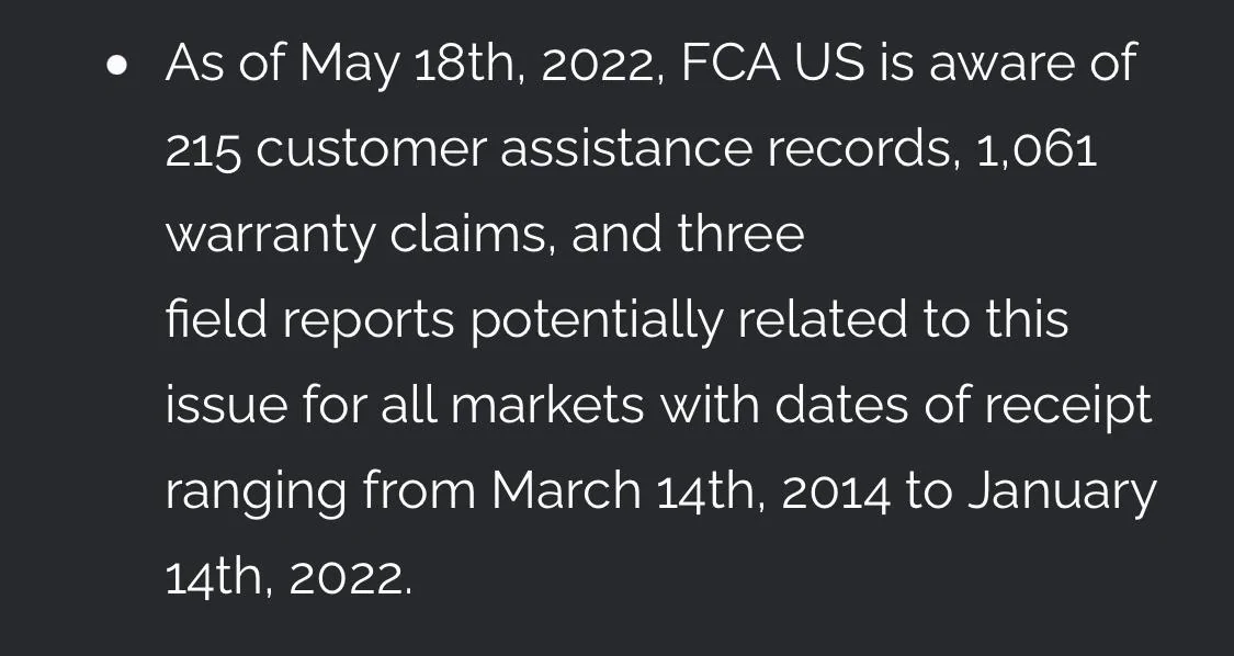

Jeep and Ram have recently released stats related to the gen2 ecodiesel recall for the CP4 HPFP. There are 138,645 vehicles in the recall and reports of 1279 failures. So can one deduce that the known failure rate is just shy of 1%? .9225 to be precise.
Jeep Gladiator Statistics for 3.0 failure rate 802F3403-4376-4BBC-8DE7-A7102AA131F1
Jeep Gladiator Statistics for 3.0 failure rate 8267A5EA-63C7-4973-B770-62D3A14B3F86
