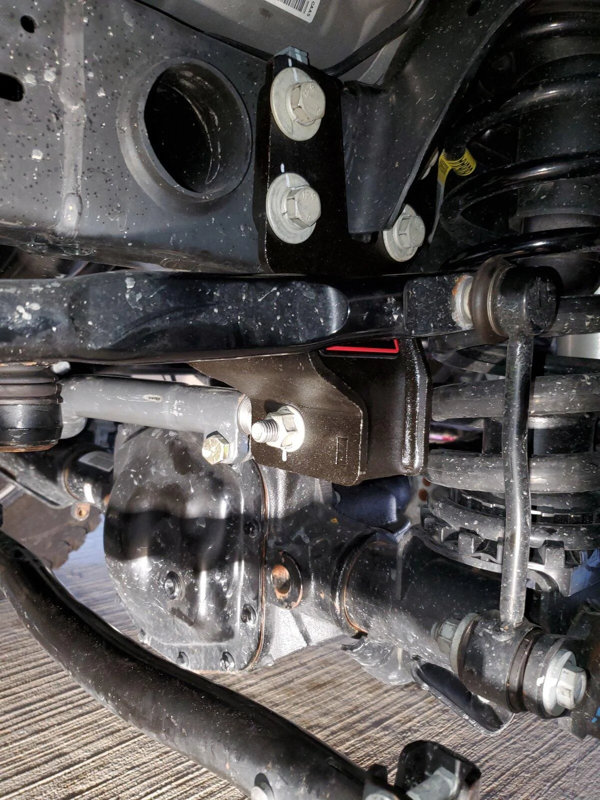

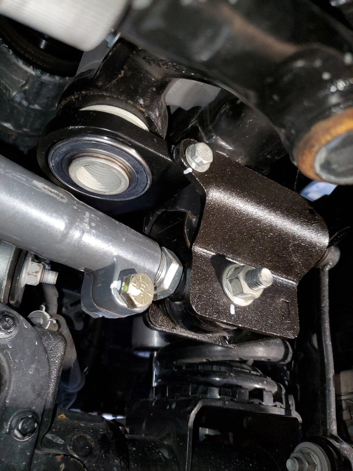

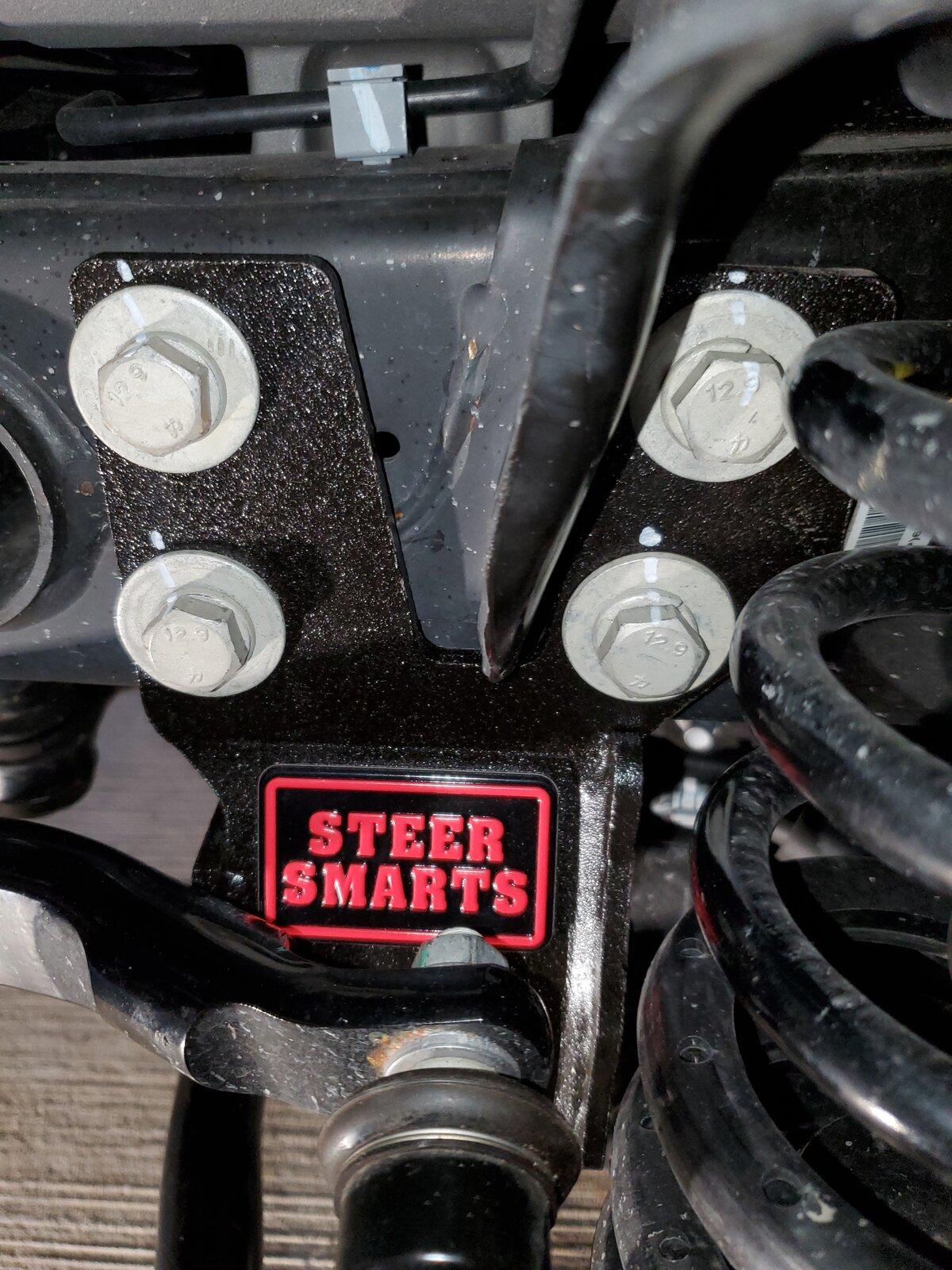

Picked up this brace and slapped it on in about an hour. Install was really smooth, but here is a pro tip: read the instructions! I had to flip the track bar bolt around and re-torque. The flip gives the now longer bolts clearance on the axle side during full compression. I really liked this 1/4" thick design with a sealed bearing supporrting the sector shaft, so I bought it to try.

First impressions: front end feels very solid now, I did not have to do as much correcting and everything is quiet and smooth. The real test will be on the interstate tomorrow.

I was considering the Synergy brace and recently found the Steer Smarts ... I like the idea of a bearing vs bushing. It seems like a simple process to remove that bracket and press in a new bearing if ever needed.
That is what sold me on it. Also if it eats bearings it is only 5 Minute swap to change it to a new one. We will see.

2020 Gladiator
