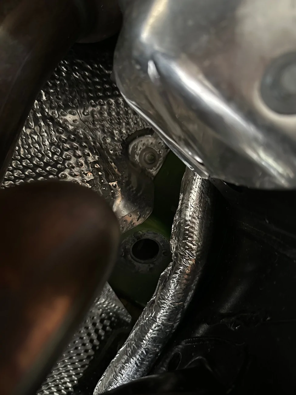

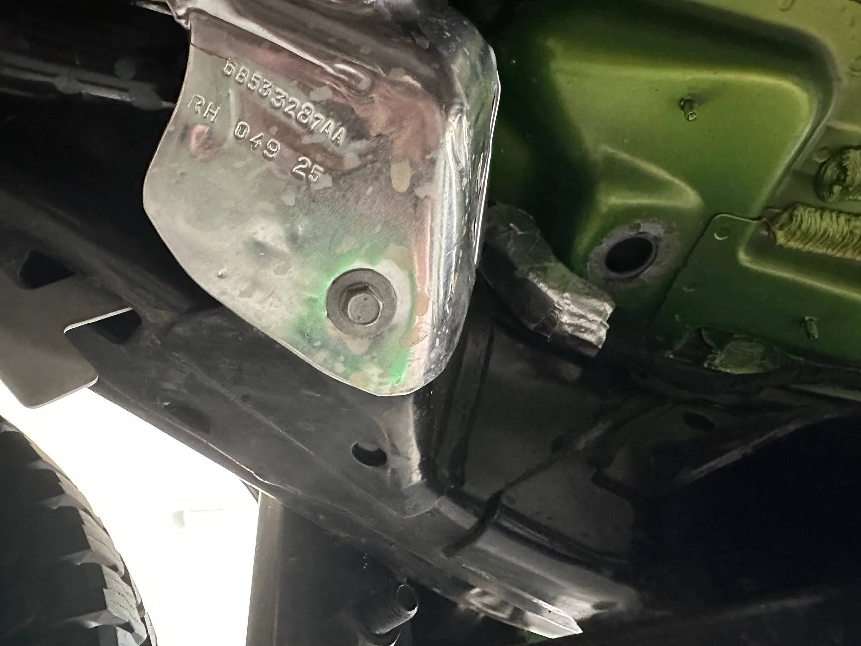

So I’m still trying to chase a wind noise I get over 20mph that sounds like a hiss inside my cabin. To me it sounds like how air comes through vents went using defrost on low for the windshield but no climate is on. I took it to dealer and they heard it but didn’t seem to want to do much about it unless I want them to tear apart the dash one day or something.
Anyway I was looking toward firewall and while under the jeep I noticed these two open holes. I assume it’s bare around them due to maybe being used as a way to hold the vehicle during assembly. But does anyone else have these holes open and bare metal under their trucks? They are behind the passenger and driver wheel well.

anyone care to look under theirs?
Yes. They are there as described.

Not sure about the holes. One way to chase a noise is to use some painter's tape. Try putting some over the holes and then driving.
I also has a leaky front window seal. I systematically taped a couple of feet at a time on the window/seal edge and drove it until I narrowed down the section that has not been sealed properly.
