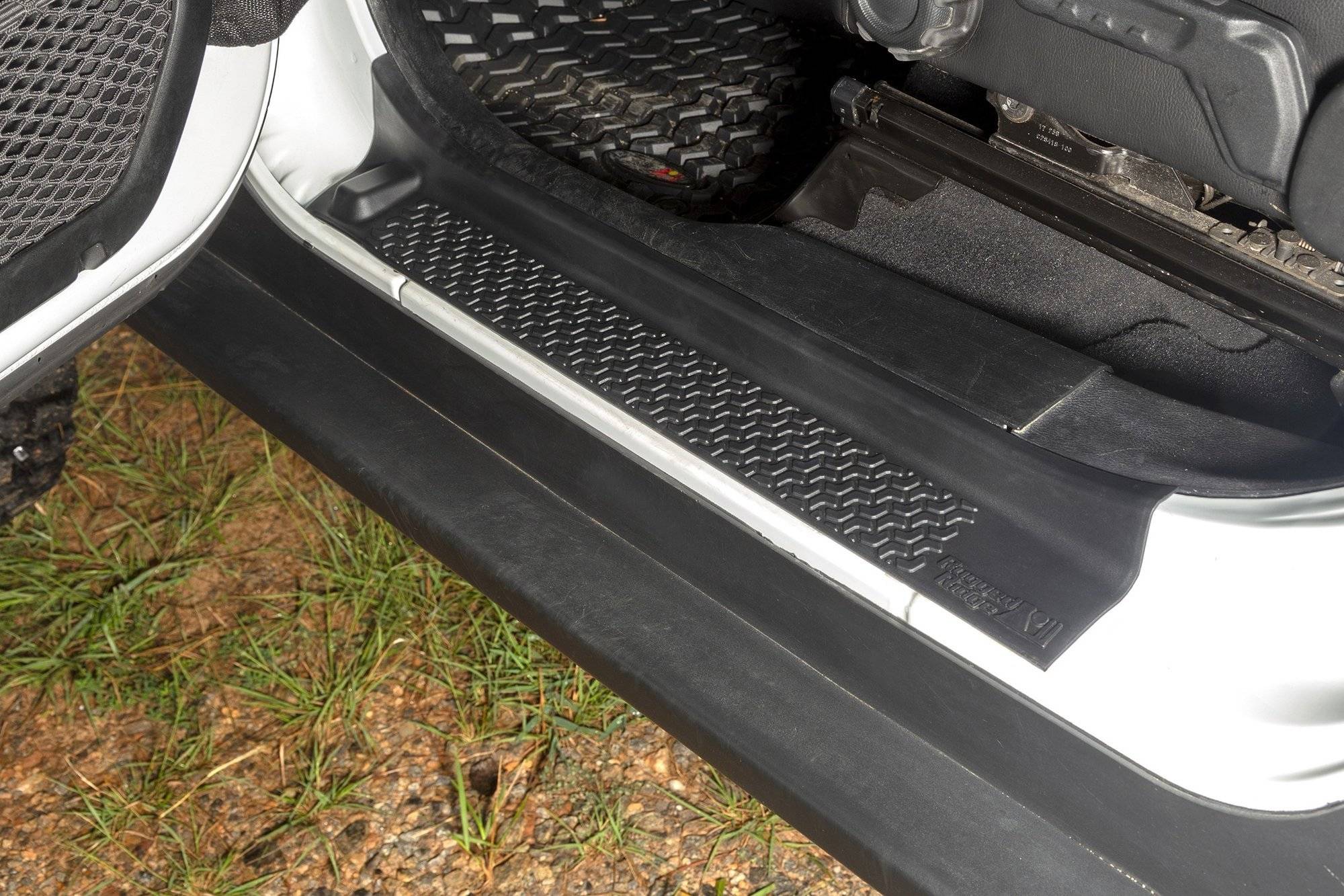

Have door sill guards installed by chance?
No, just drove it off the lot Friday evening. Which guards are you referring to?

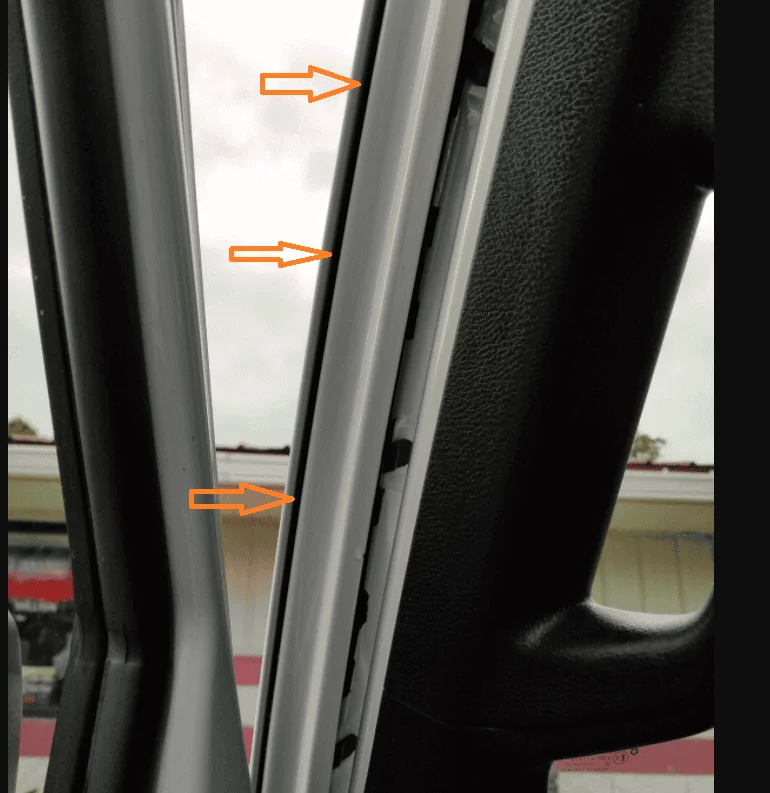

Check the gap on the back side of the A-pillars (see pic below). I had to fill this gap with automotive foam tape to fix my wind noise. Before filling the gap, it sounded like I had a window just barely cracked open.
To see if this is your problem, simply cover this area with blue painter's tape and see if the noise goes away.
