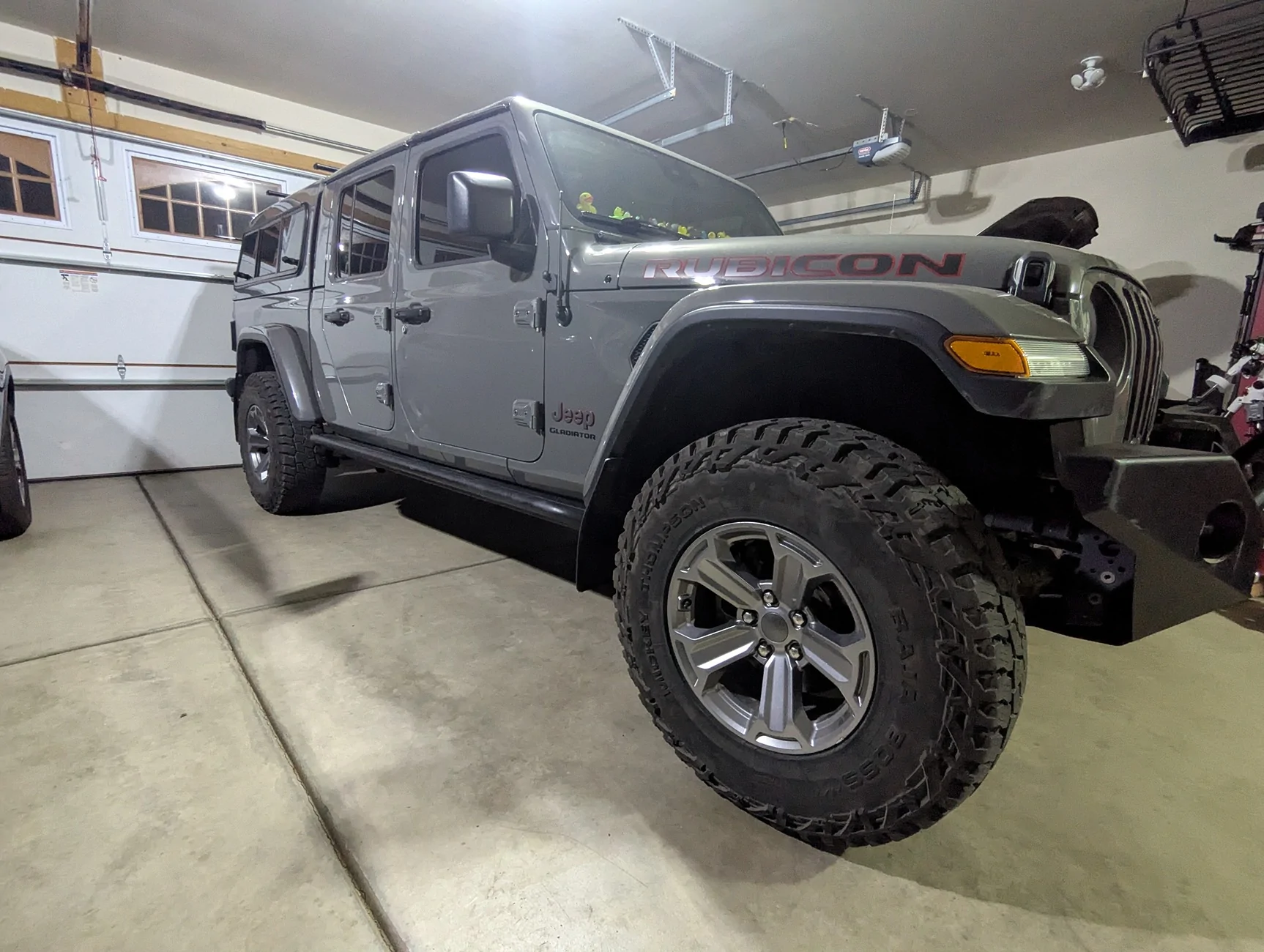

Do you have pictures?
Thinking about getting those 1” springs just the front ones, wanna know the actual lift you gain.
Was and still is 1" gain. Here's a picture I took right after the install.
Jeep Gladiator Stock Height Suspension Upgrade for JTR 1000005710
