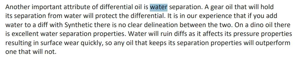

Here is what they say about gear oil selection:
https://eastcoastgearsupply.com/files/PDF Files/ecgs-gear-oil-recommendation1.pdf
That one is all over the place.

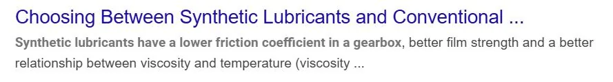

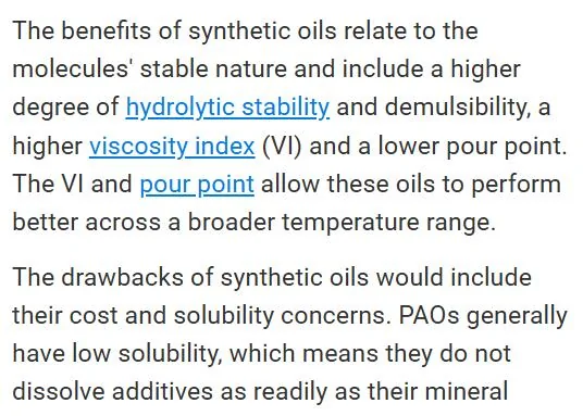

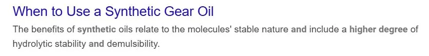

And they are dead wrong about this specific area - science proves them wrong, as do actual machinery experts -
Jeep Gladiator Gear Oil Upgrade For Towing 1746121420916-r2
Regular non-synthetic will absolutely emulsify - take in the water and not separate easily. Synthetic resists emulsification. I don't know where they heck they got that info. I've seen many - dozens if not hundreds, of differentials and manual transmissions with an emulsion in them - and it lasts.
Jeep Gladiator Gear Oil Upgrade For Towing 1746121645902-jo
Generally speaking, synthetics hold their viscosity better than non-synthetic.
Jeep Gladiator Gear Oil Upgrade For Towing 1746121237702-ta
Jeep Gladiator Gear Oil Upgrade For Towing 1746121260547-41
