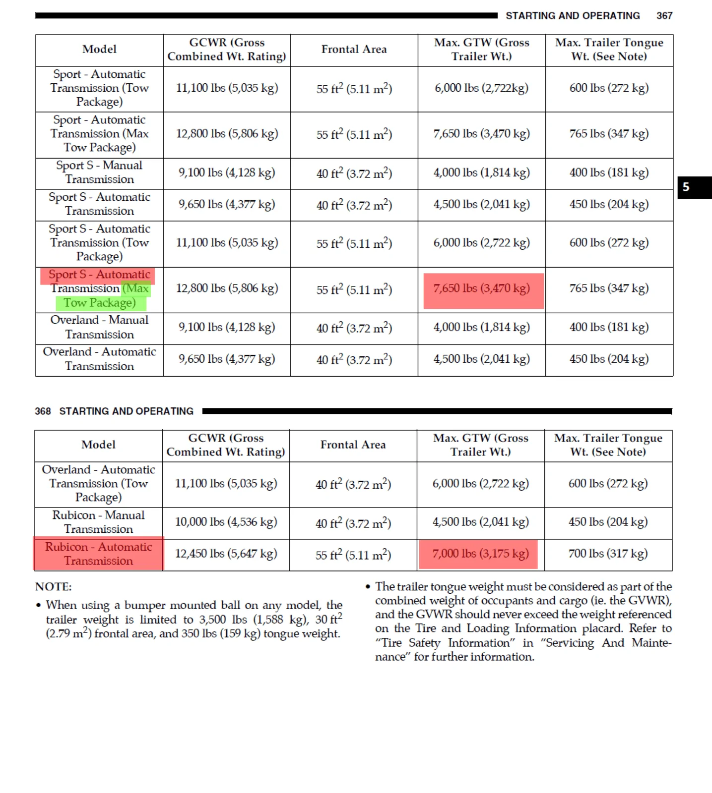

Look at the GCWR
12,800 for the sport max
12,450 for the Rubicon

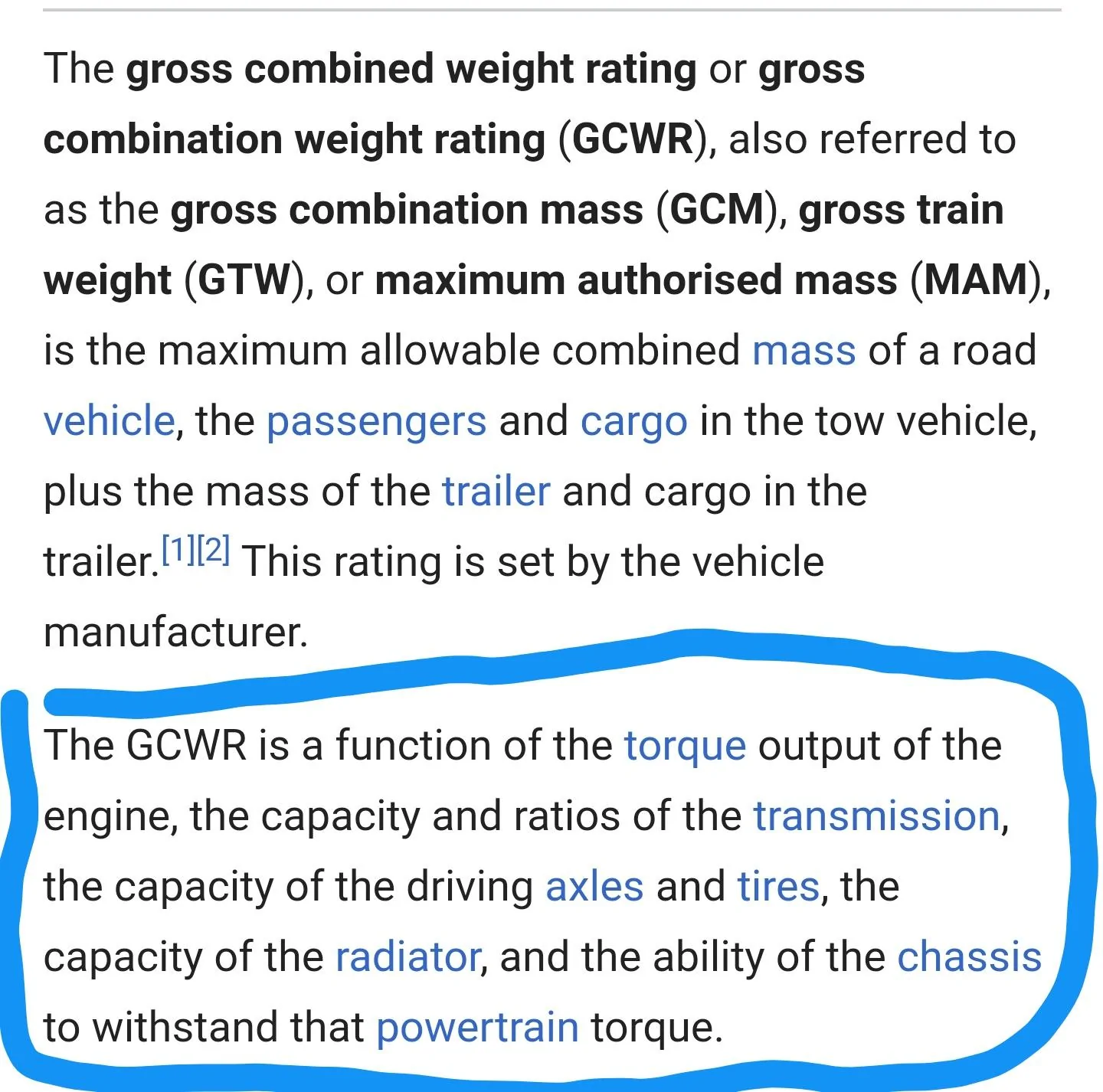

Using the explanation of GCWR from the screenshot it can be inferred the lower combined weight of the Rubicon is due to the increase in tire size. This 350 lb loss in combined capacity needs to be removed from the Rubicons tow capacity loss to come up with roughly 300lbs of additional curb weight. The max tounge weight difference is 65lbs. The springs don't really factor into the tow capacity.

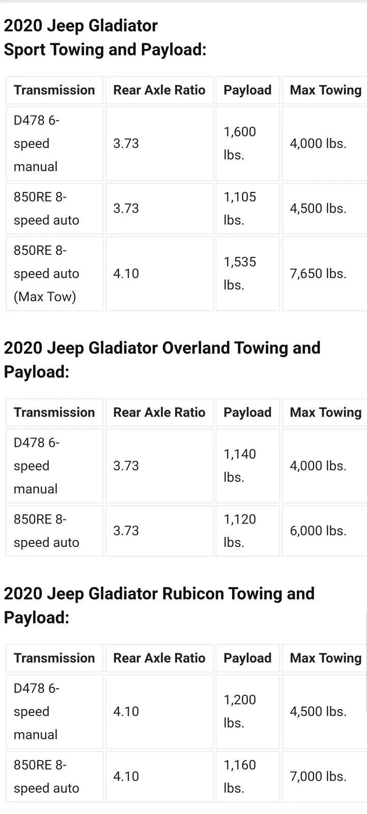

But if you want to look at what springs do affect look at the difference between the max tow and Rubicon as far as payload.

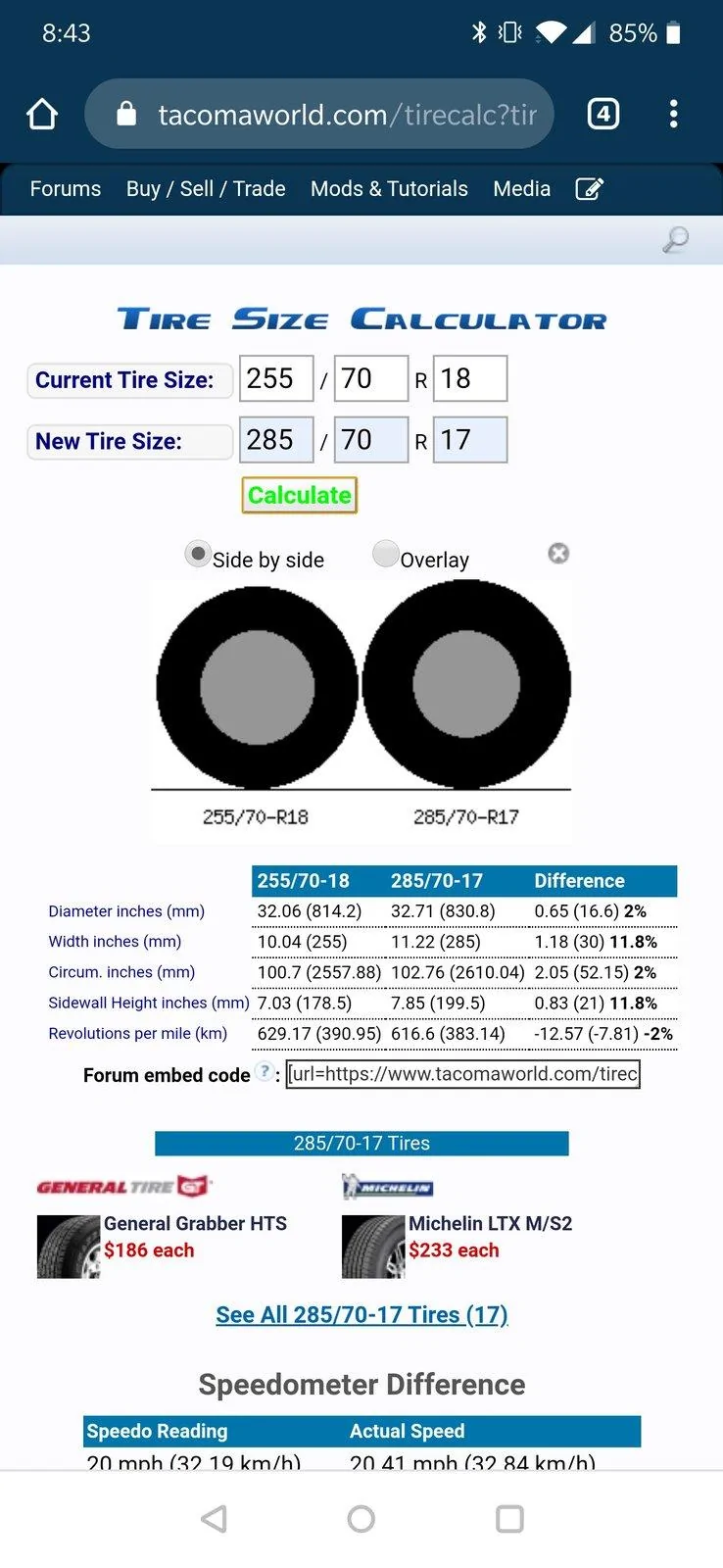

It's actually worse than you think.
Jeep Gladiator Tire Size, Gear Ratio, Affect on Payload/Towing Screenshot_20191108-204314
https://www.tacomaworld.com/tirecalc?tires=255-70r18-285-70r17
40,491
53,989
If these are 285/70R17 as you predict then there's hardly any diameter difference, it's mostly width or footprint in that respect. More aggressive tread for sure.
