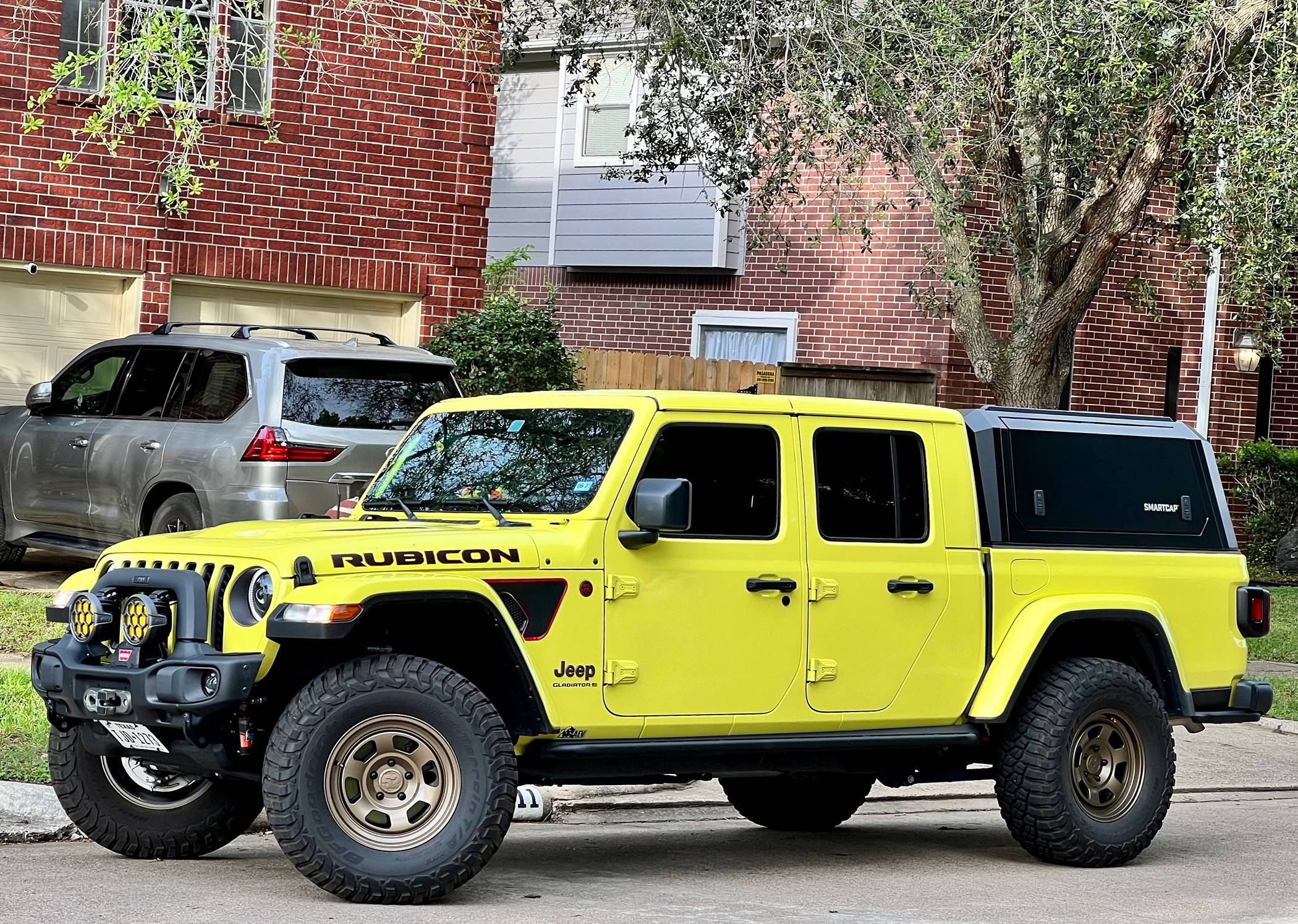

I had a Mojave and liked the ride a lot but traded for a 392 that was a blast but wanted a a Gladiator again so i bought a 2023 Rubicon Gladiator then put a daystar 1 1/2” spacer in front and ordered Fox 2.5 elite performance adjustable reservoir shocks for 0-1.5” lift . My Rubicon eye to eye sitting measurement is 21” front and 22” rear. I love the ride.
Wow, a JT Overland, then a Mojave, then a JL 392, then a JT Rubicon all in 4 years? The man loves his Jeeps!

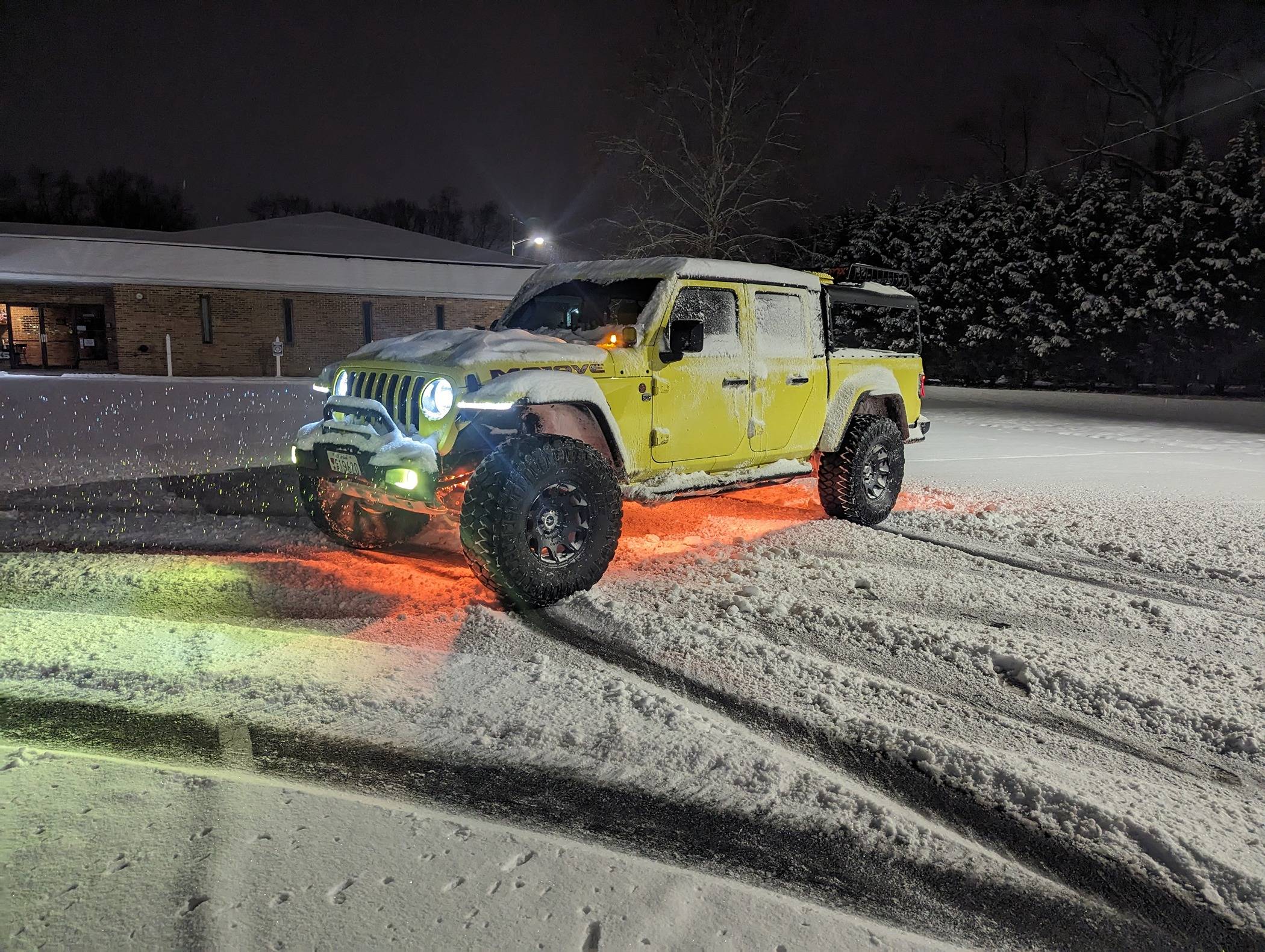

Looking at your truck........are you on 35s?

Time to get that bish on 37s LOL

Everyone knows the gladiator looks better on 37s.
Fuckin A brother........especially when in HVY. Since you went with mud, I went with snow
