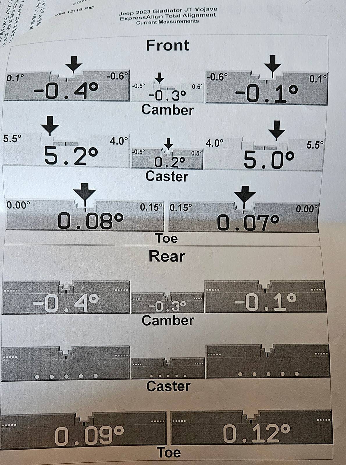

Update
Dealer ended up replacing the drag link, though the tech wasn't super confident it was bad but agreed that he could feel the movement. I went ahead and ordered the mopar control arms and had them ready for them to install with the new drag link. They performed an alignment and I made a request to get the results.
Stock Mojave with mopar lift kit control arms netted me 5.2/5.0 caster.
The truck feels better. So that is good. I can live with its current characteristics. But it does still have some wander, just less. I have a Fox TS SS that will be going on soon. and I think I'm going to try and adjust the gearing box next. If I decide to tinker past that. I think I'll try a trackbar brace.
