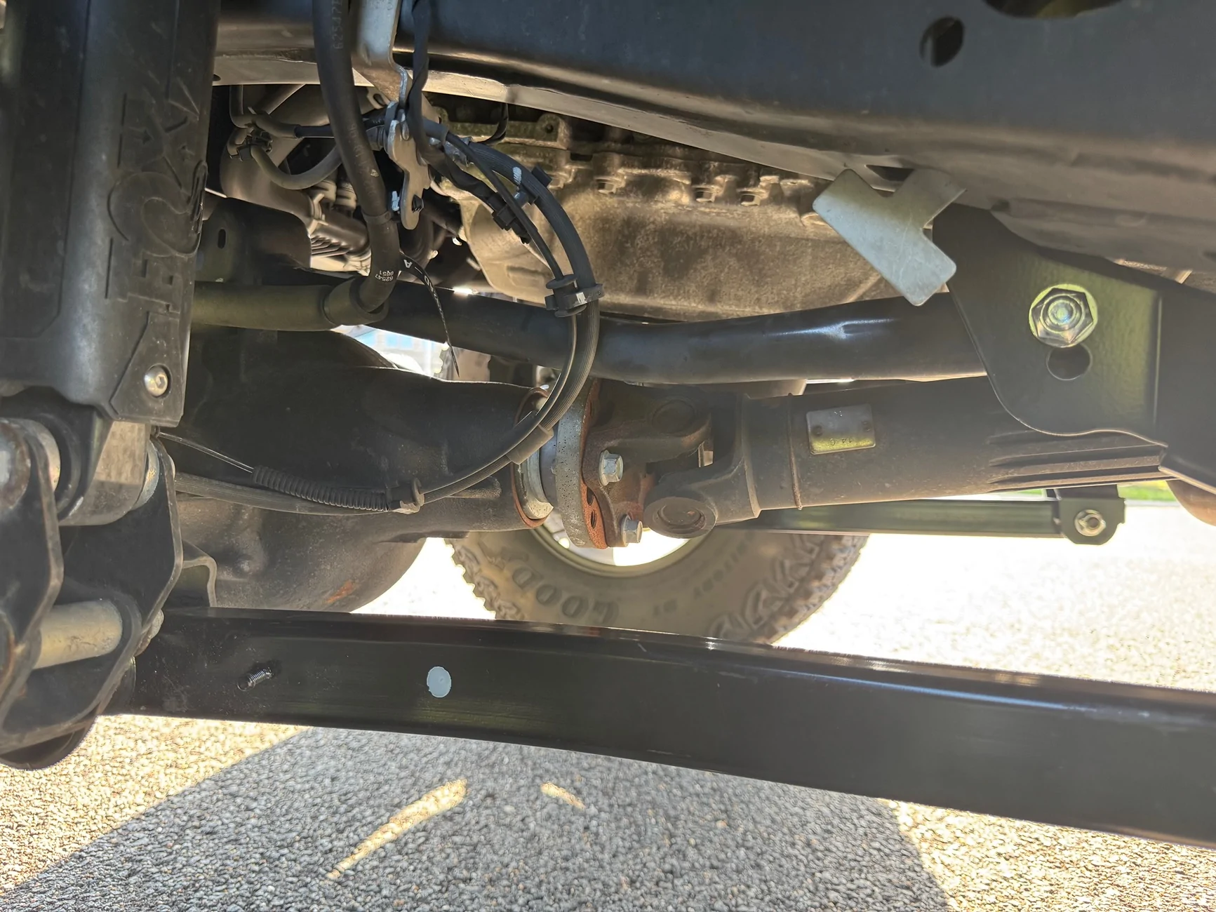

BLUF: Vibration after installation of JKS Geometry Correction Bracket.
I have a bit of a Franken lift on my ‘01 Willys consisting of Rubicon Springs/Shocks, 2in Teraflex spacers up front along with Mopar lower control arms and 1in Teraflex spacer out back for about a 2.5in/1in lift front to rear.
Wanting to improve steering feel, ride and address occasional DW I installed a set JKS Geometry Correction Brackets, and reinstalled the original lower control arms. I have the upper control arms in the top hole of the bracket.
Immediately upon test drive I could feel vibration at ~1800 RPM and ~2300 RPM regardless of speed.
I did not feel any driveline vibration before the geo brackets.
Could the geo brackets have induced driveline vibration with such a small lift? Would I feel higher NVH with the geo brackets?

Checking everything again with the drop brackets. Completely missed that the driver side exhaust loop is touching the drop bracket. Loosened the exhaust flange bolts on either side of the y-pipe and was able to gain about an 1/8in of gap. Still too close so still rattles in some situations, but definitely improved.
But to add insult to all of this, I broke one of the flange bolts.
