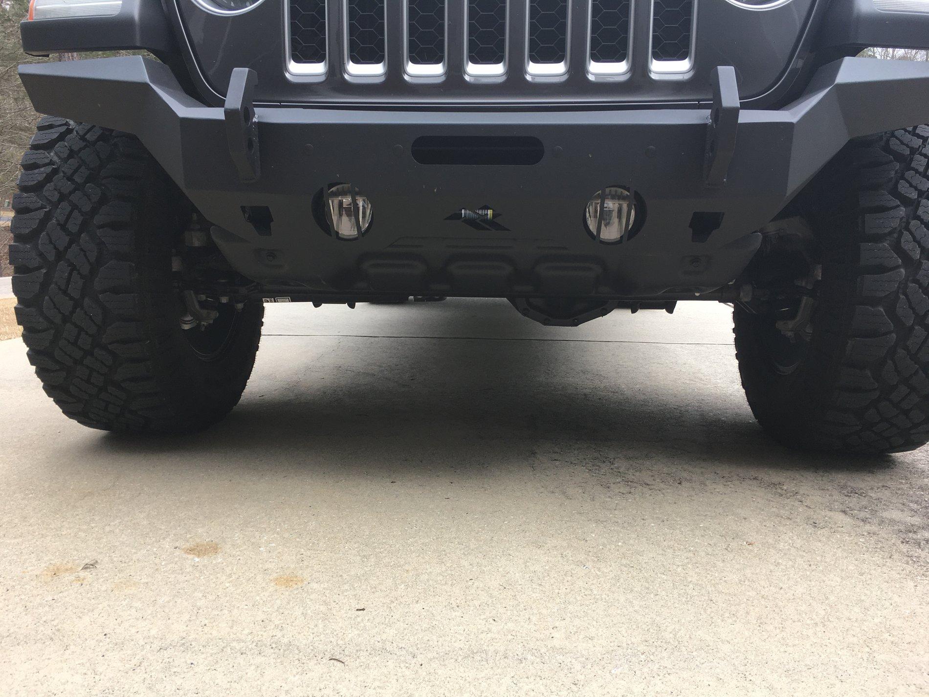

I recently purchased a rubicon PPOS front bumper with factory steel skid plate from someone here on the forum. I am trying to install these on a JT Sport S. The bumper installs just fine - fogs work - all is well there.

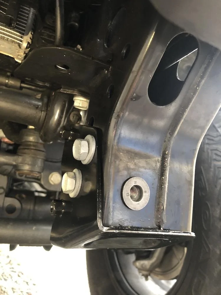

I think the problem I am having is that the Sport and Overland trims don't have a small angled mount point right above the bottom of the frame rail where the steel skid plate mounting brackets are located. These angled mount points are standard on Rubicons, but missing on the others so I don't think there's any way to mount the JTR factory skid on a Sport S or Overland.

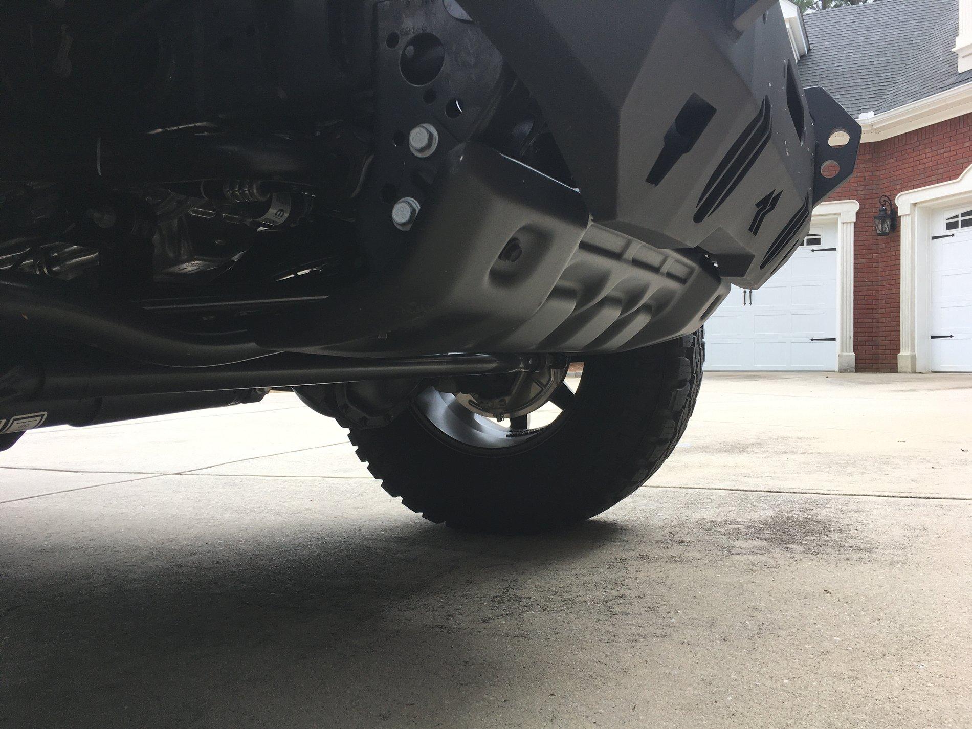

Here is the parts list that I installed a plastic bumper Rubi Skid plate on my Overland.
Jeep Gladiator Stock Rubicon Skid Plate on Sport S 1BAEB901-7FA9-4D34-B828-EF4519BF0360

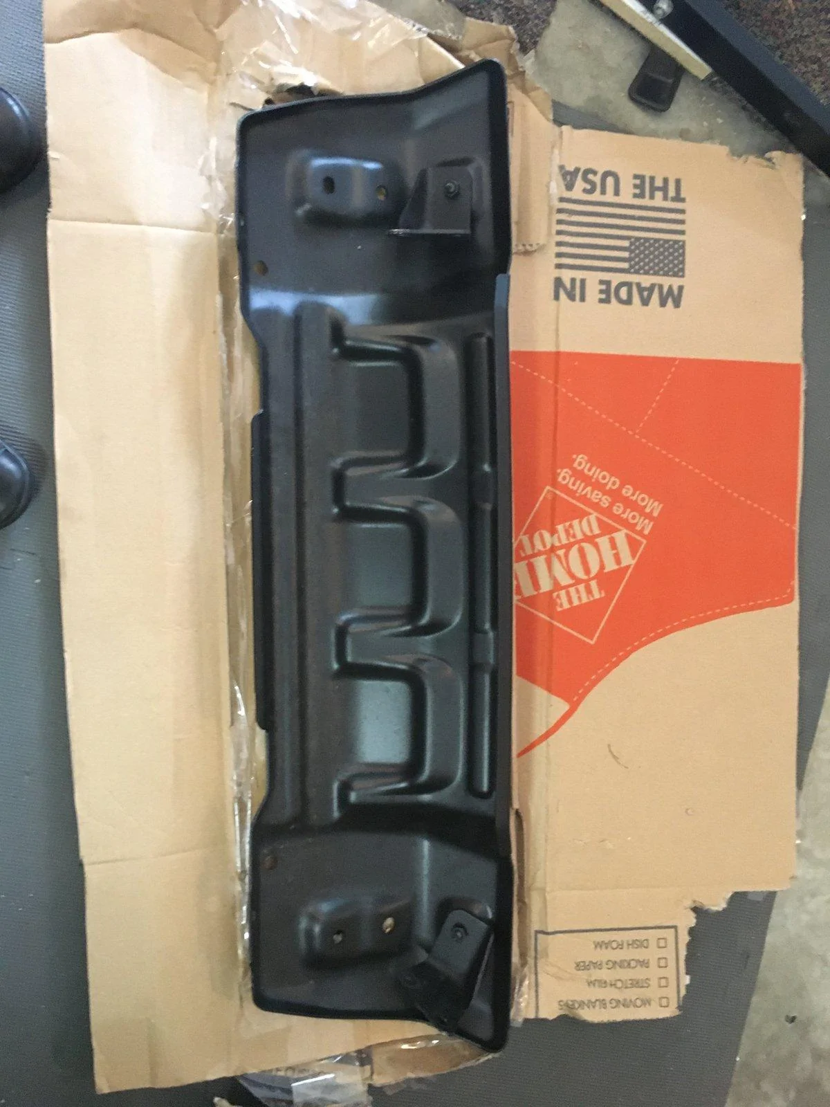

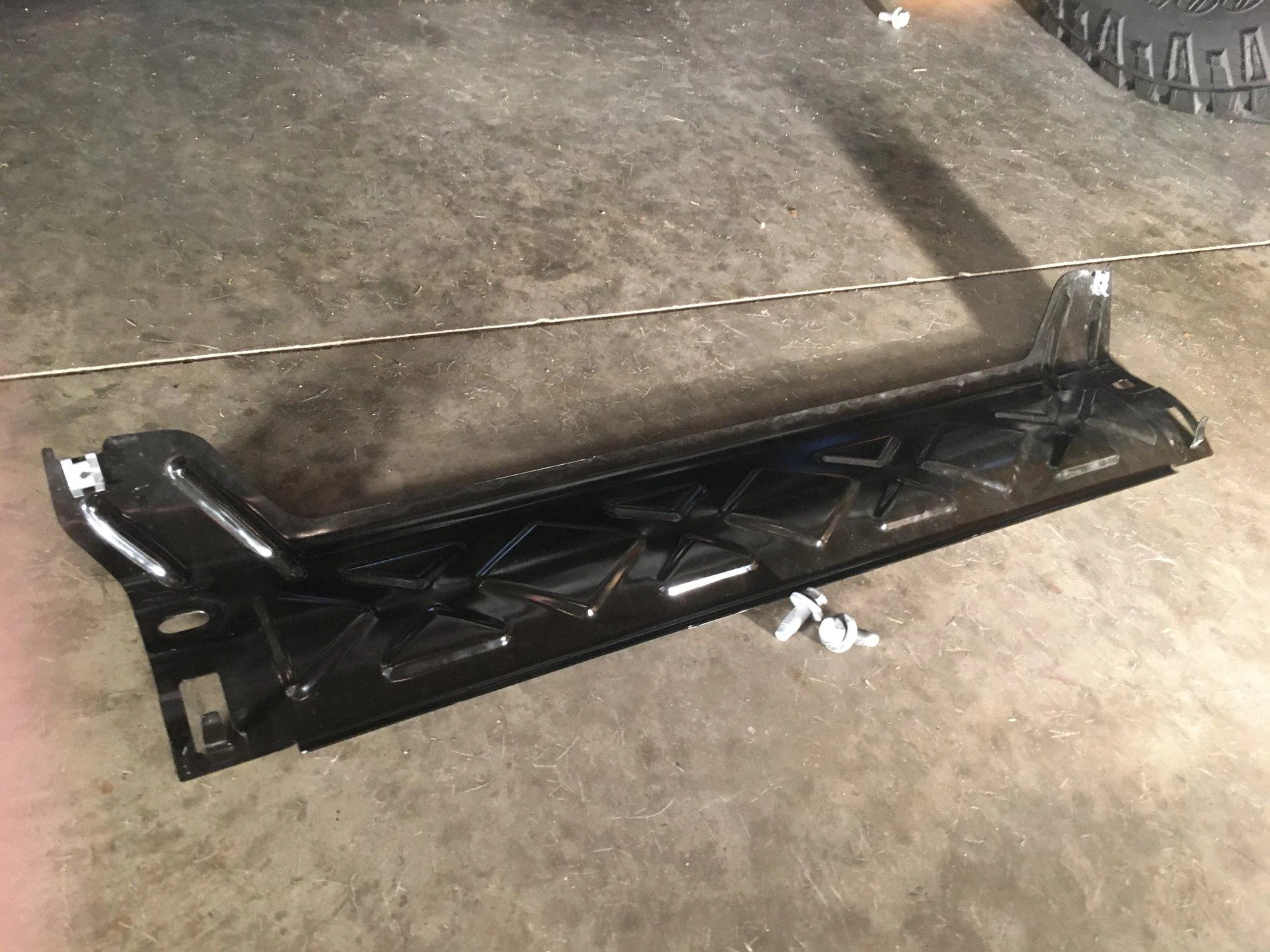

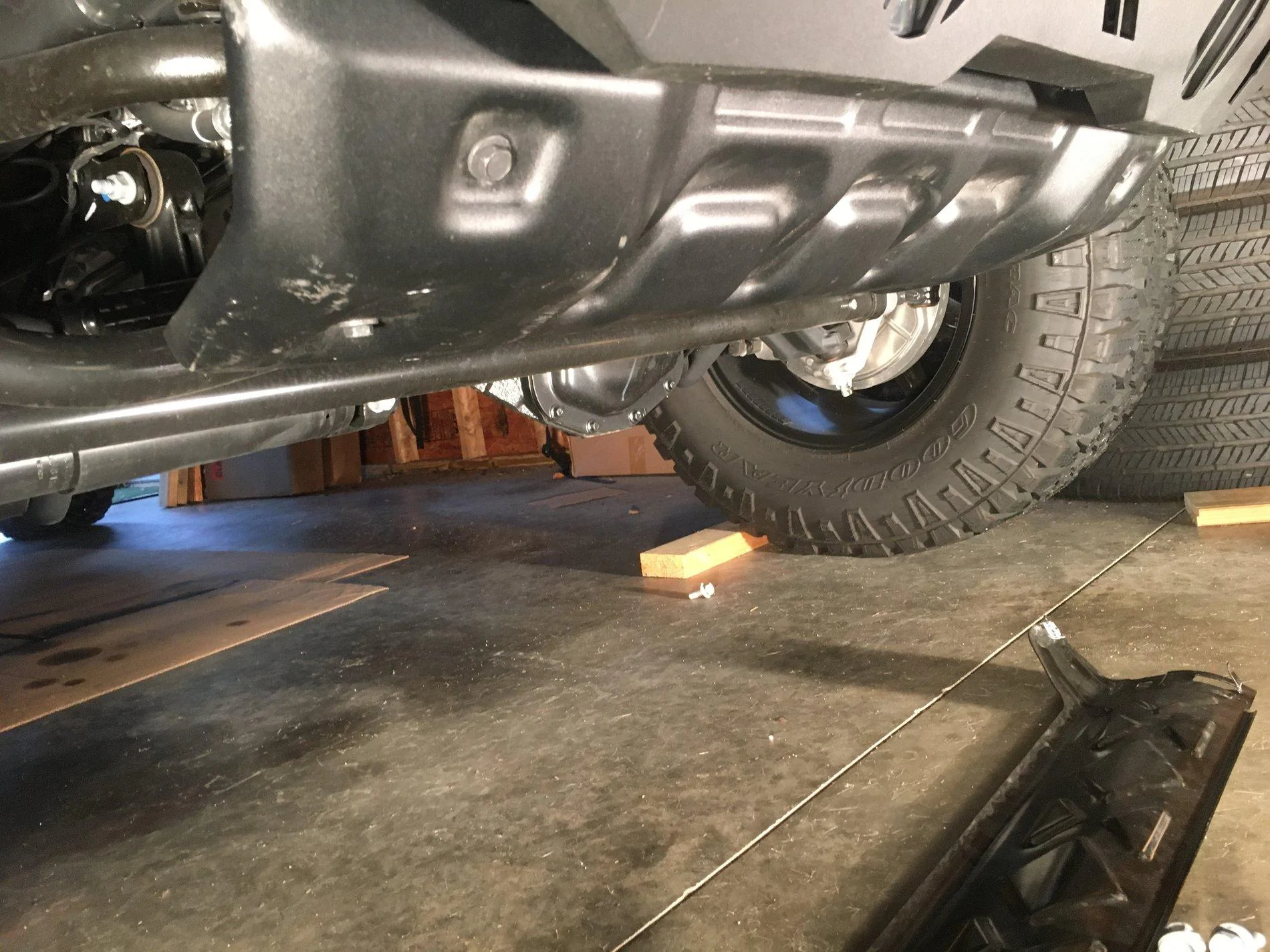

Here is what I just ordered from:
my mopar parts .com
Part Number Part Name Price Quantity Total
68353836AB Skid Plate Bracket, Right $8.27 1 $8.27
68353837AB Skid Plate Bracket, Left $8.27 1 $8.27
6104414AA Hex Head Bolt And Coned Washer $2.70 8 $21.60
6511076AA Nut/Rivet $2.70 8 $21.60
6512587AA Screw $1.13 2 $2.26
Subtotal: $62.00
Estimated Standard Shipping:$11.91
Total: $73.91
You can recycle the 2 cross member bolts.
