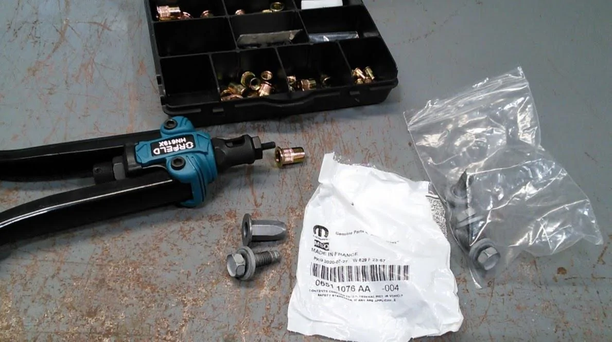

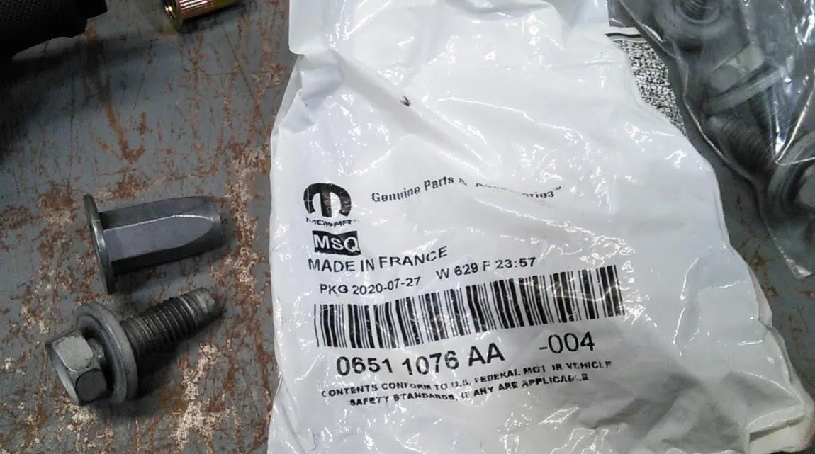

Jeep Gladiator Installing Stock Rubicon Skid Plate on Sport IMG_20220721_101635

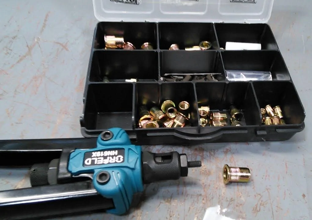

This is what I call a "rivnut" (and they are easily found on Amazon using that term!)
You absolutely will need the tool to set them because they turn in the hole otherwise. There's no way to hold them. ideally, you drill a hole the size specified for the size you are using and they fit the hole snugly so when you use the tool to set or "rivet" them, they fit tight and shouldn't turn.
They are perfectly round. The holes in the frame are hex (I'm all too familiar with that crazy area on these - mounting a receiver, then taking it off and mounting a bumper and winch and skid plate, then taking the skid plate off to mount a different receiver, then mounting the skid plate again and then taking it all back off again to trade my truck in - and now I'll do it all over again on the new one - and i have the hex "nutserts" on hand in my collection of stuff.
Jeep Gladiator Installing Stock Rubicon Skid Plate on Sport IMG_20220721_101658
Comparison -
Jeep Gladiator Installing Stock Rubicon Skid Plate on Sport IMG_20220721_101624
In any case, the bolts used are M10 And that's a heck of a large "rivnut" and will take some muscle and a decent tool to set. Don't use aluminum - it's going into a high strength steel frame and aluminum in steel may not work so well in an area that gets wet a lot.

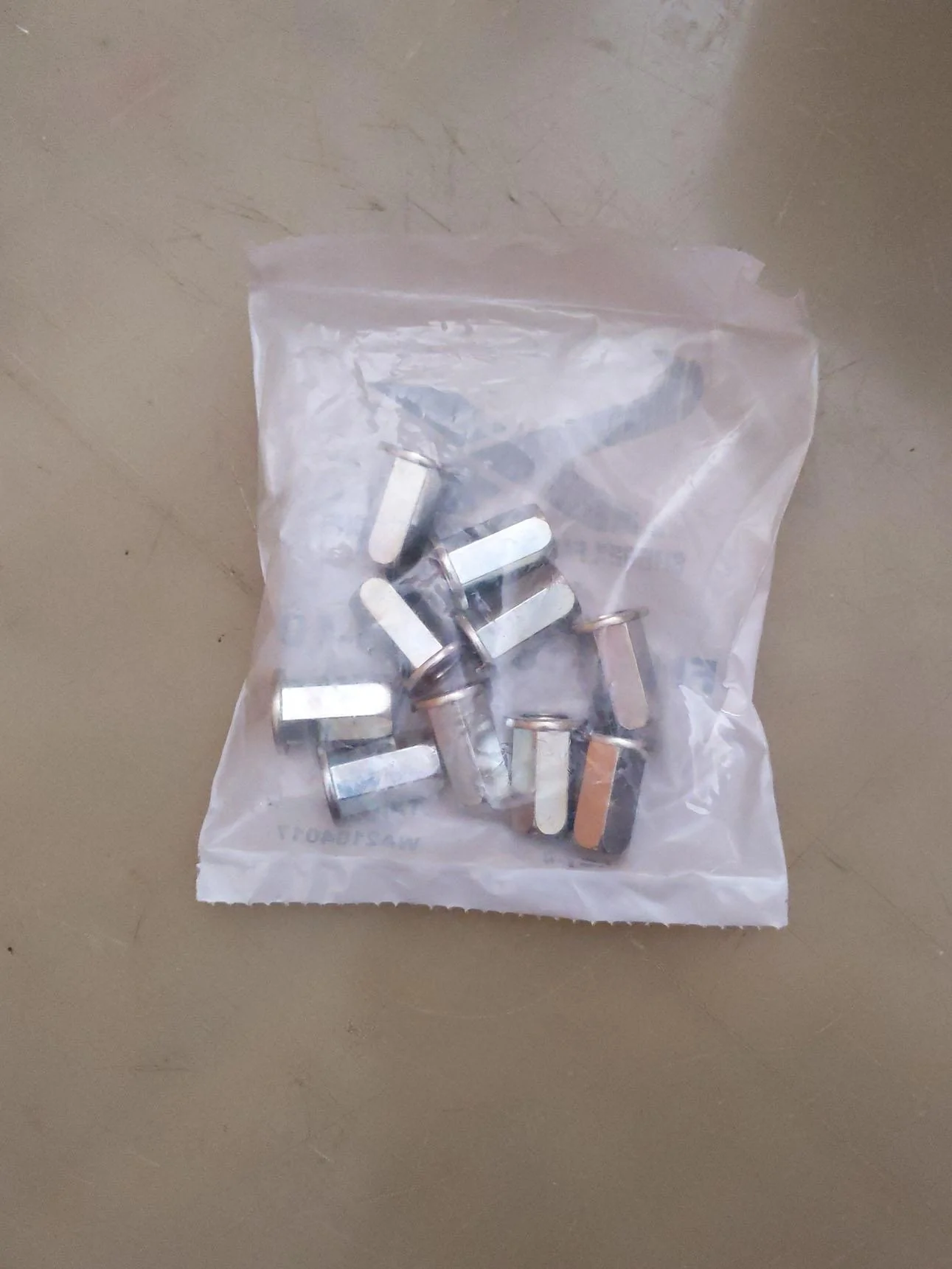

These shipped quick. They look like they will work, but the zinc plating "for mild corrosion resistance" seems to indicate the possibility of corrosion. Given the difficulty of removing them once installed, I'll probably pass and pay for the factory rivnuts that seem to be corrosion proof. It looks like my free skid plate is going to cost about $130 for the hardware to install.
