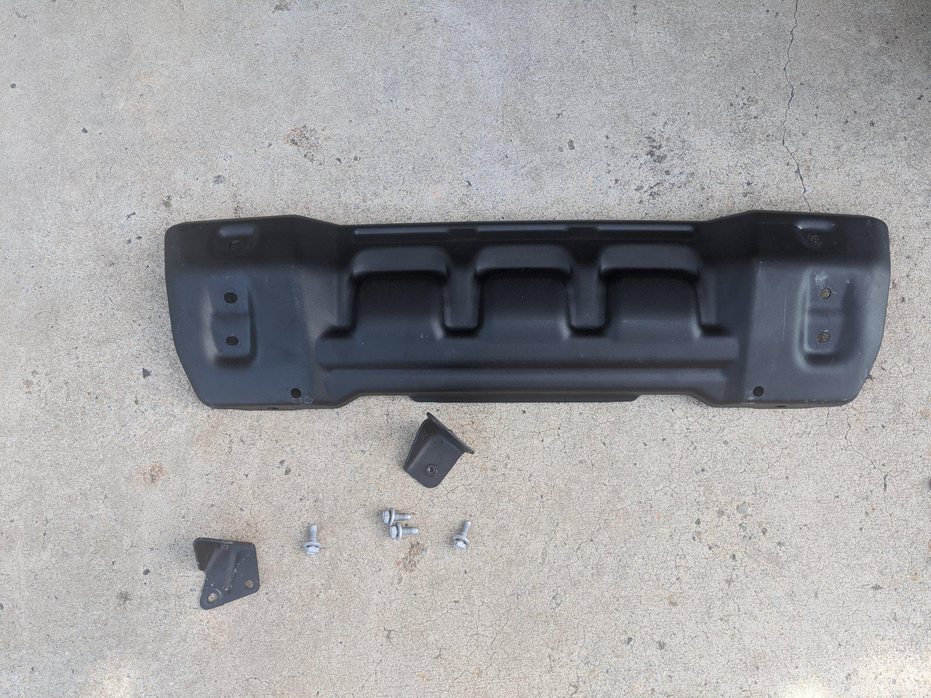

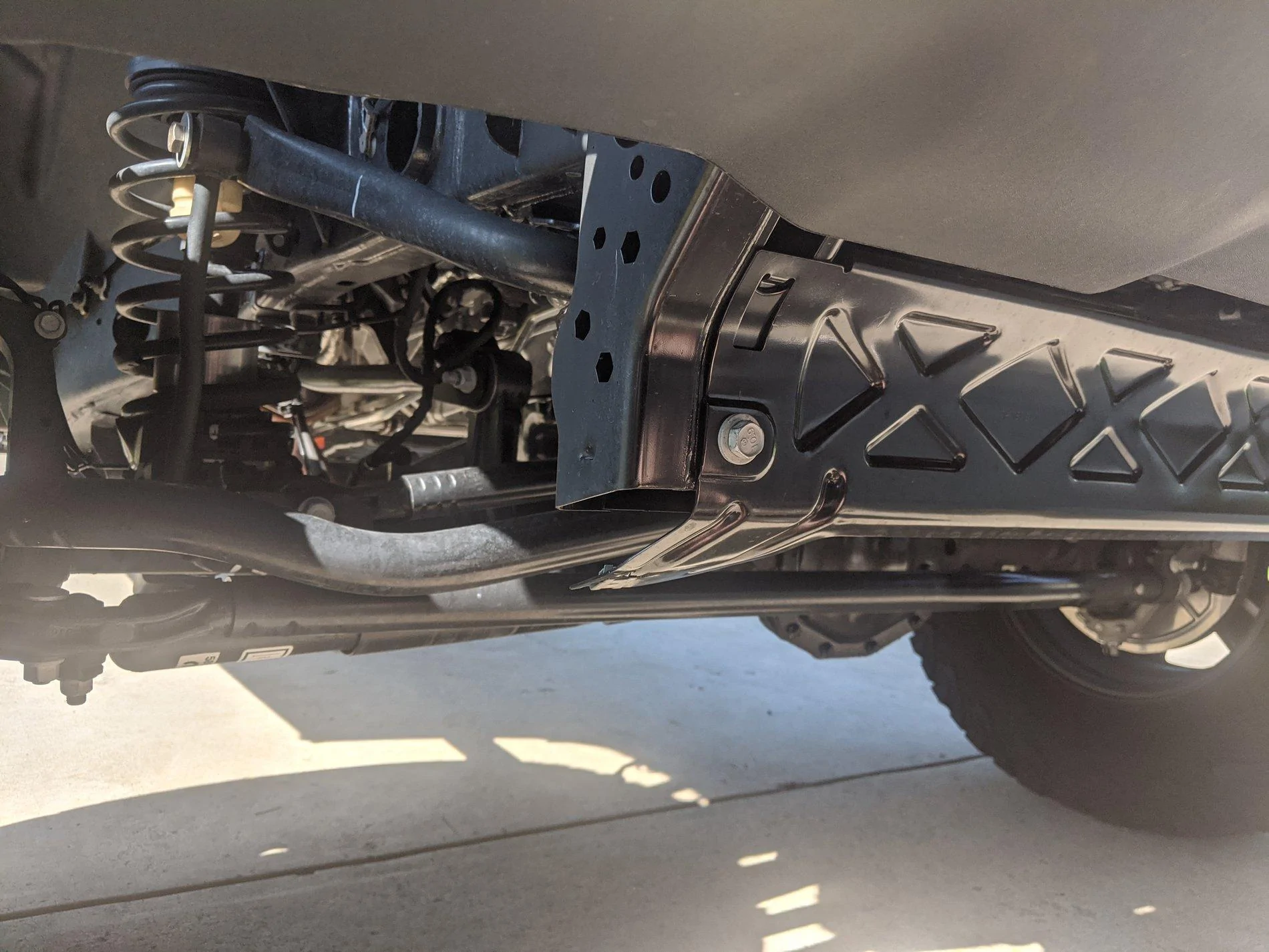

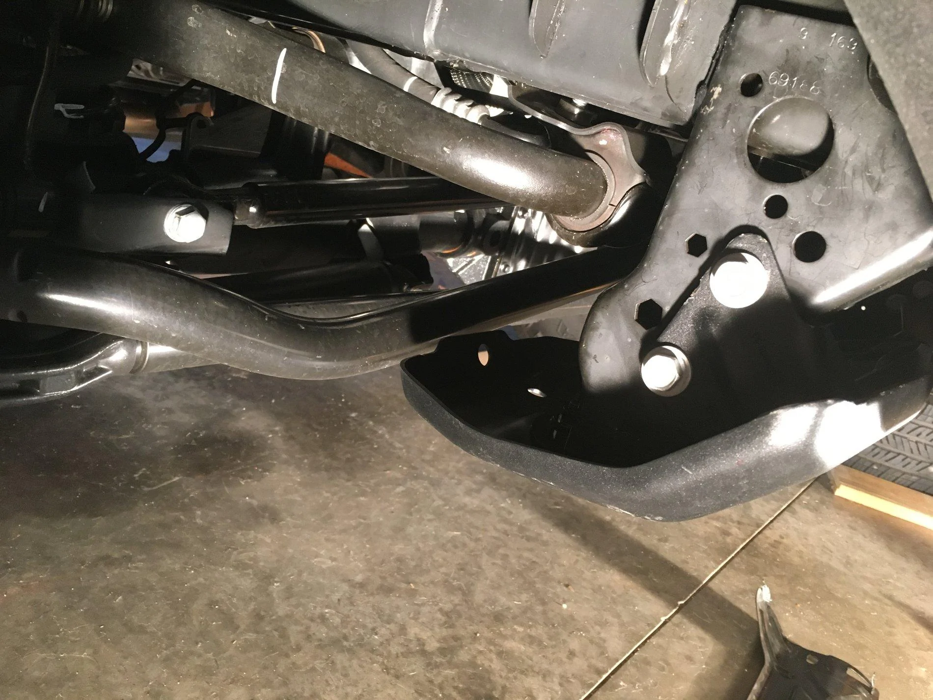

I need a little clarity because someone told me yesterday all I needed was the brackets I have. I am about to install one of these skids on my JT sport and want to make sure I got everything. Pictures included if what mine looks like with the plastic skid removed, also do i need to remove the black aluminum piece behind the plastic skid. Thanks for any help
Do you have 4 brackets? If not, looks like you are missing rivnuts, 2 brackets, and more bolts for the other brackets.
See the parts list in the Overcon.
and pics are posted.

No. You need top and bottom brackets, nuts and revnuts.

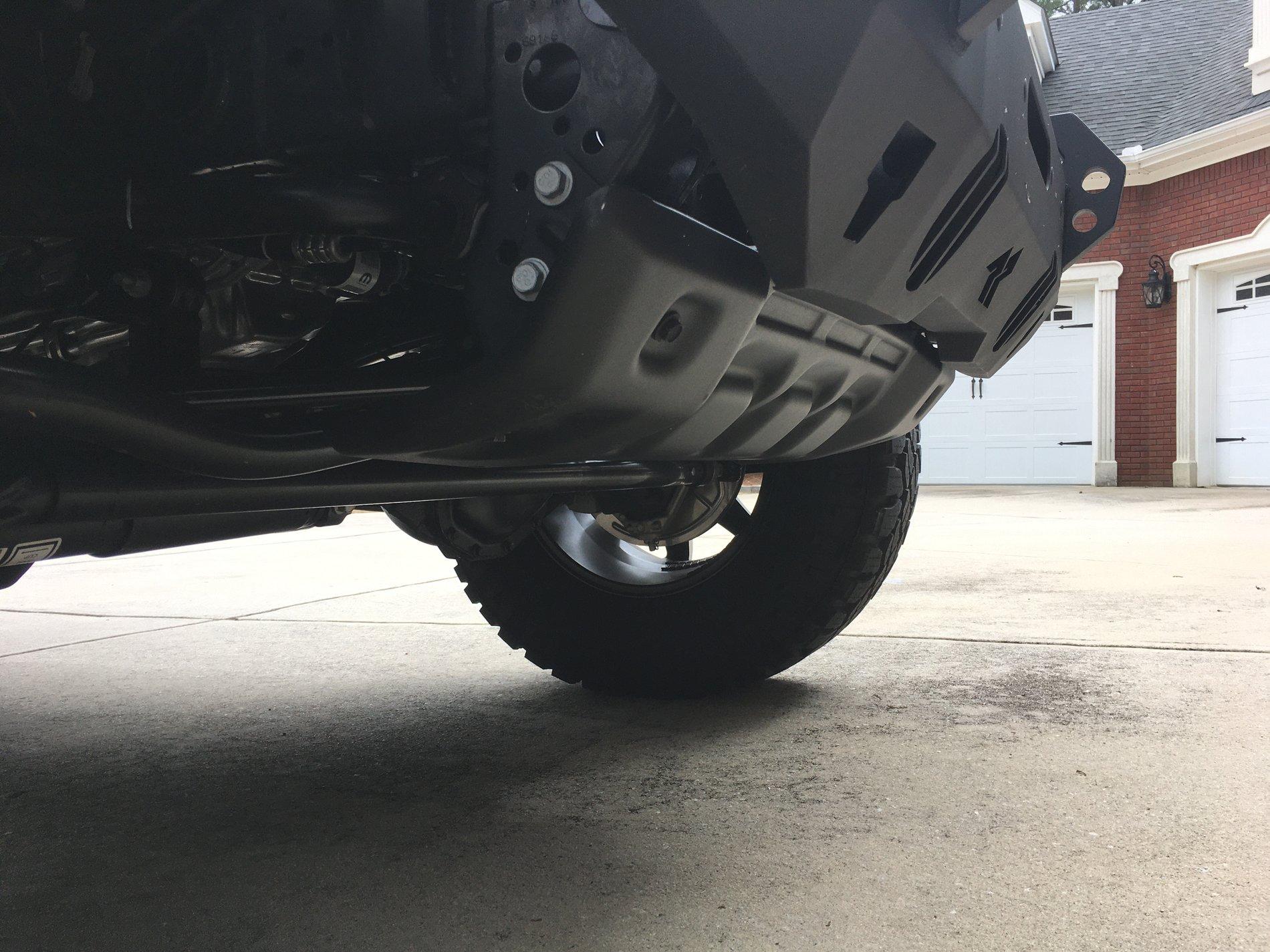

This thread turned out very helpful today. I was able to use it for reference and get my plate installed along with the bumper. Thank you to everyone who participated!
Jeep Gladiator Installing Stock Rubicon Skid Plate on Sport C1DF073E-30F0-4BBE-AC71-C2F228D0030E
I need to install mine. Where did you source all the bolts and stuff or did you get everything with the skid.
Got all the bolts and two of the brackets from morris 4x4. The two upper brackets (red boxed ones from page one of thread) came with another skid i got a while back. Kinda worked out.
The links on page one should be pretty much all you need
