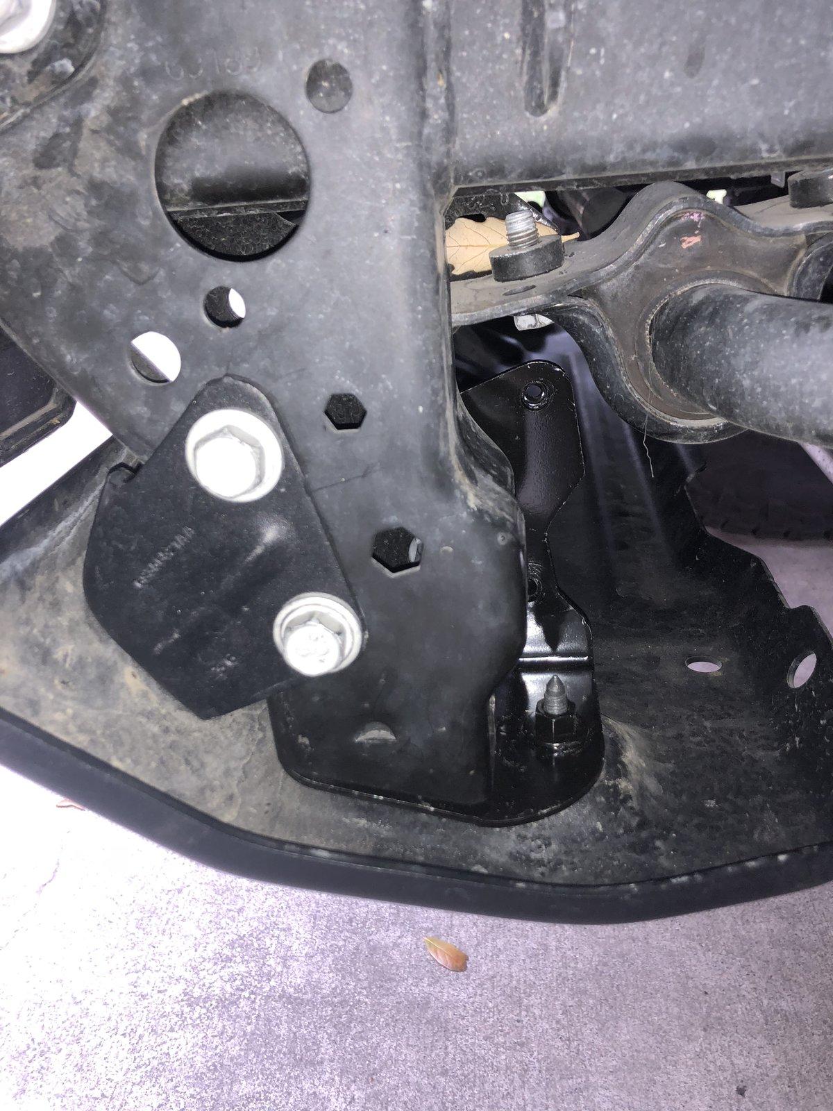

Crap, didn’t realize there is a rear bracket. Explains the rear holes! Do you have the part number or link to the rear bracket?
Ok finally got the back brackets, rivet nuts all in and installed. Turns out I had the skid plate on backwards! There should be a gap between the back of the plastic rubicon bumper and the front of the metal skid plate. Thanks for all the info!

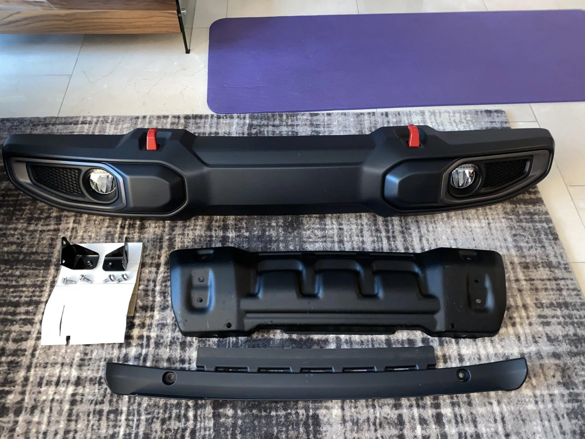

Hi guys: Is this all of the hardware necessary to install the stock Rubi plastic bumper and skid plate? I want to sell this as a package, but definitely don't want to misrepresent anything if something is missing. If you get a second, please let me know. Thanks.

Looks like you're missing one of the sets of brackets - the skid plate installs with two brackets on each side. (See GladiatoRic picture above)

@natepdx is correct, it is missing the back brackets that they re-used on your steel bumper, the hardware for the same and the plastic push rivets for the filler panel.

When I was taking the brackets in the picture off, I saw another set of brackets, but I left them on because I wasn't sure if I'd still need them to install the skid plate that goes with the steel bumper (right now I just had the steel bumper installed without the skid plate). I'm going to try to install the skid plate myself, but I still need to order it, and figure out what i need for it hardware wise. Do you happen to know?
Thanks for the info. Ok, well I just won't say that everything needed is included then. Do you know if I will need the filler panel when I install the skid plate that goes with the steel bumper?

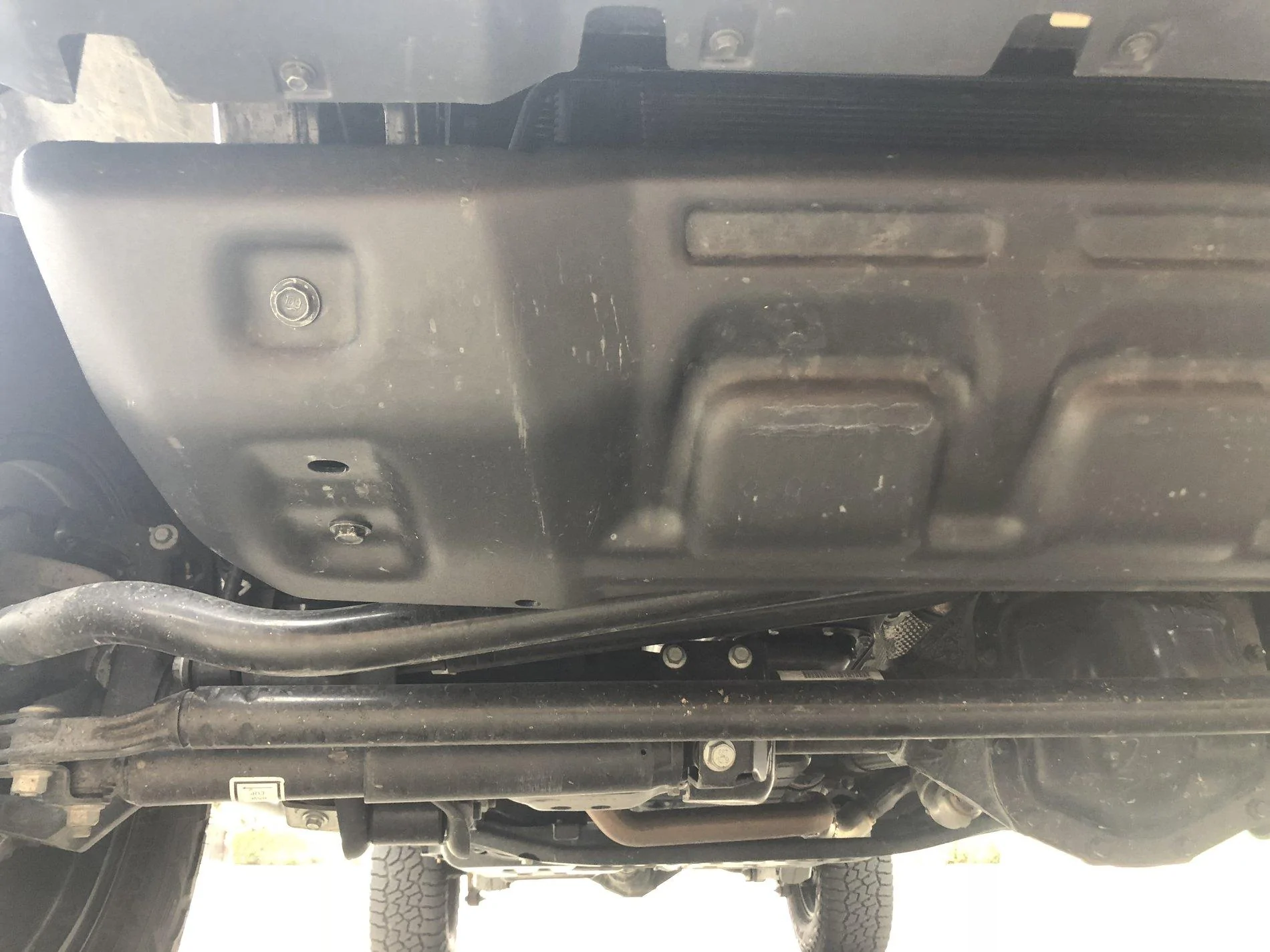

I need a little clarity because someone told me yesterday all I needed was the brackets I have. I am about to install one of these skids on my JT sport and want to make sure I got everything. Pictures included if what mine looks like with the plastic skid removed, also do i need to remove the black aluminum piece behind the plastic skid. Thanks for any help

The black aluminum piece provides the brackets and support for the plastic air dam. I believe that needs to come off to install the Rubicon skid plate. I had to remove it from my Overland when I installed a front hitch receiver.
