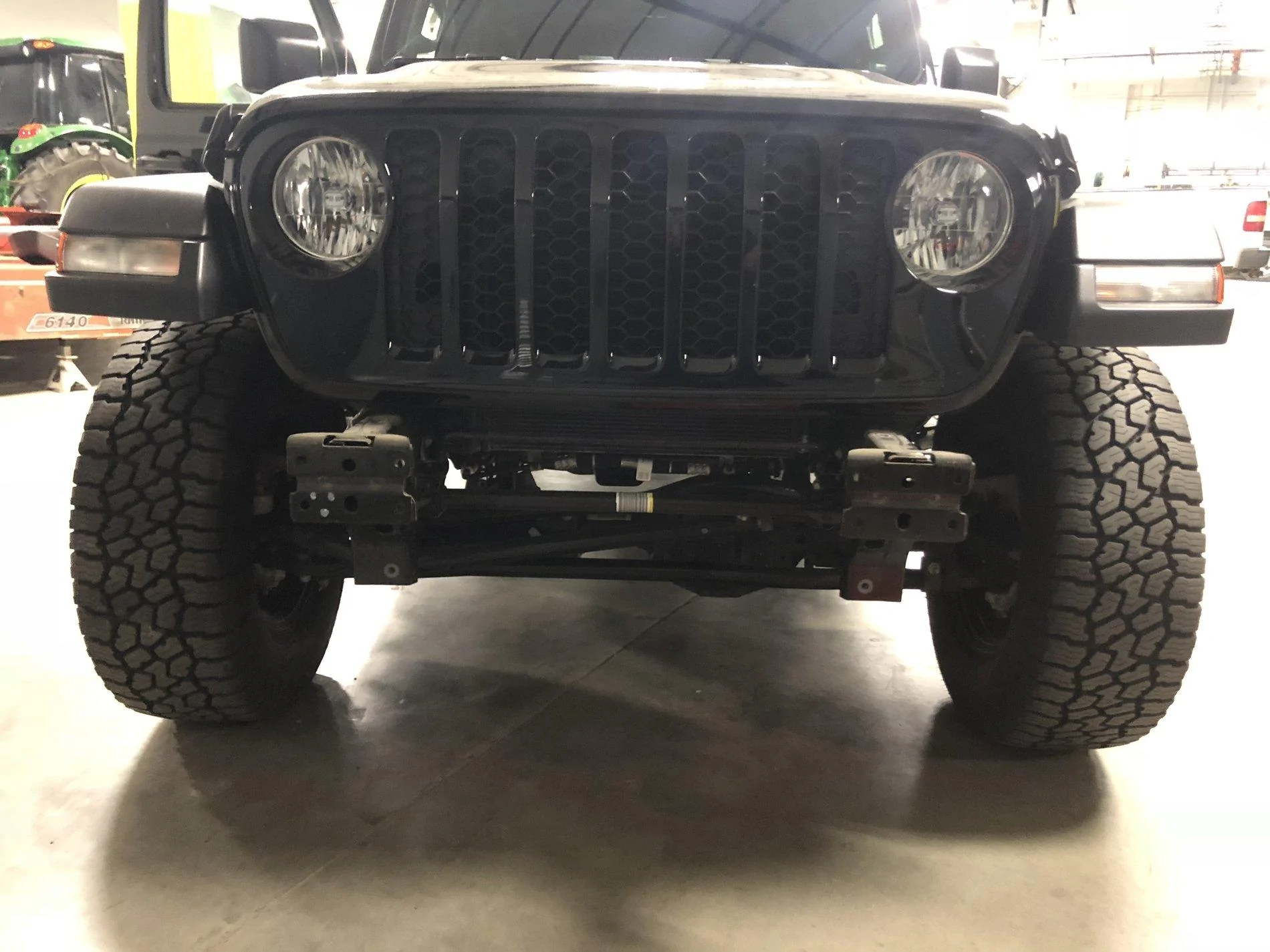

Here are three photos:
1. Front view of Gladiator with the bumper off. The red box shows the bracket in question.

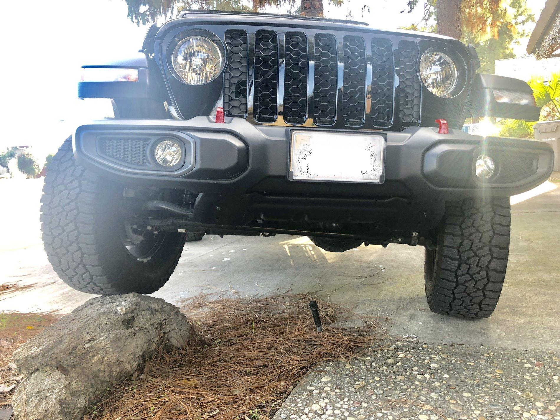

2. A comparison of the two skid plates. The one that works with the steel bumper on the top and the one for the factory skid plate is the bottom. Both are oriented in the same direction: JT front toward the bottom. Here you can see the difference... I put a red box around the spot where the bracket is used to attach this skid plate. (The rear mount point is the same for both skid plates... See the blue circle.

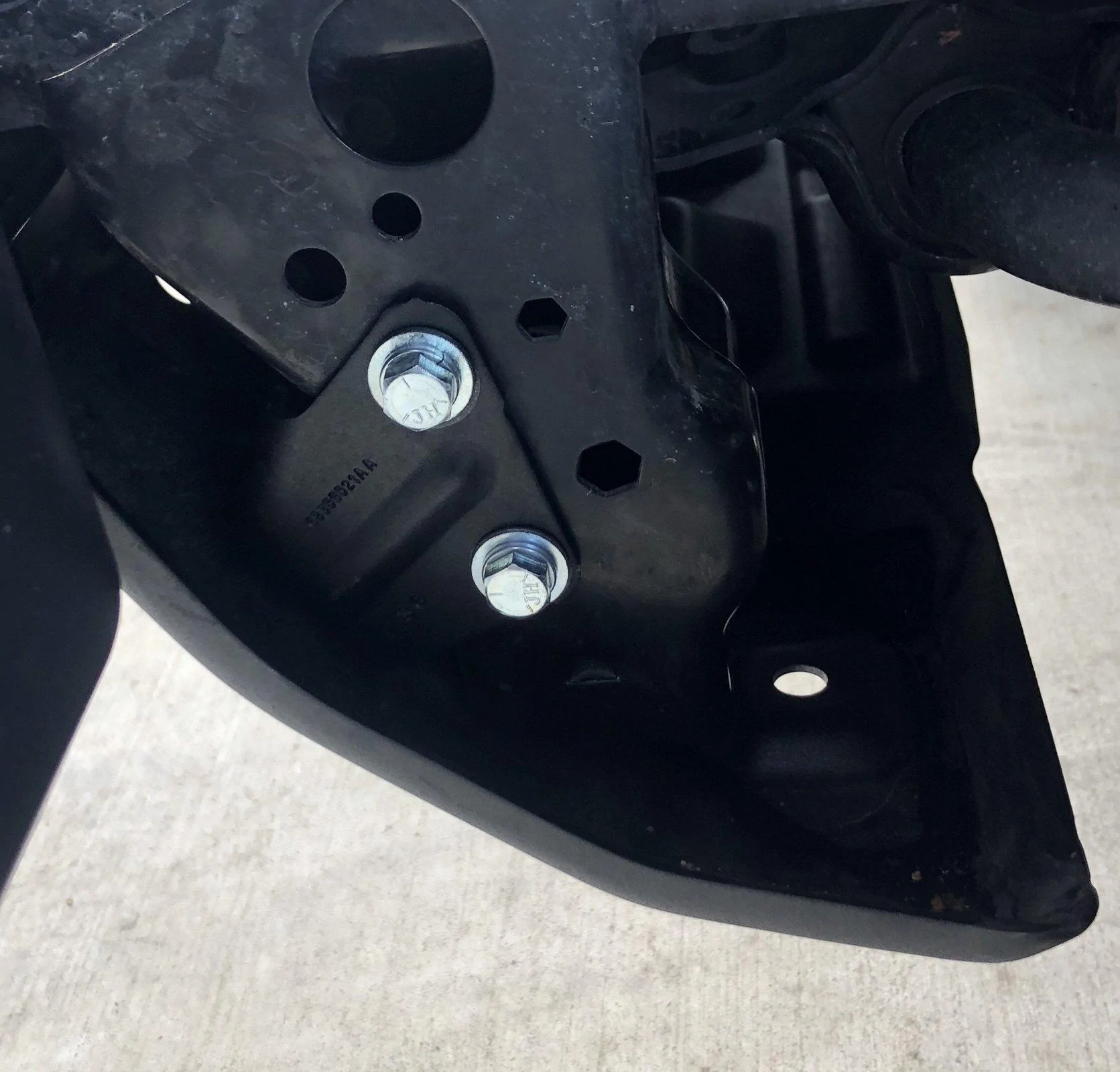

3. An (extreme) close-up of the The face of the bracket is in the upper part of the picture

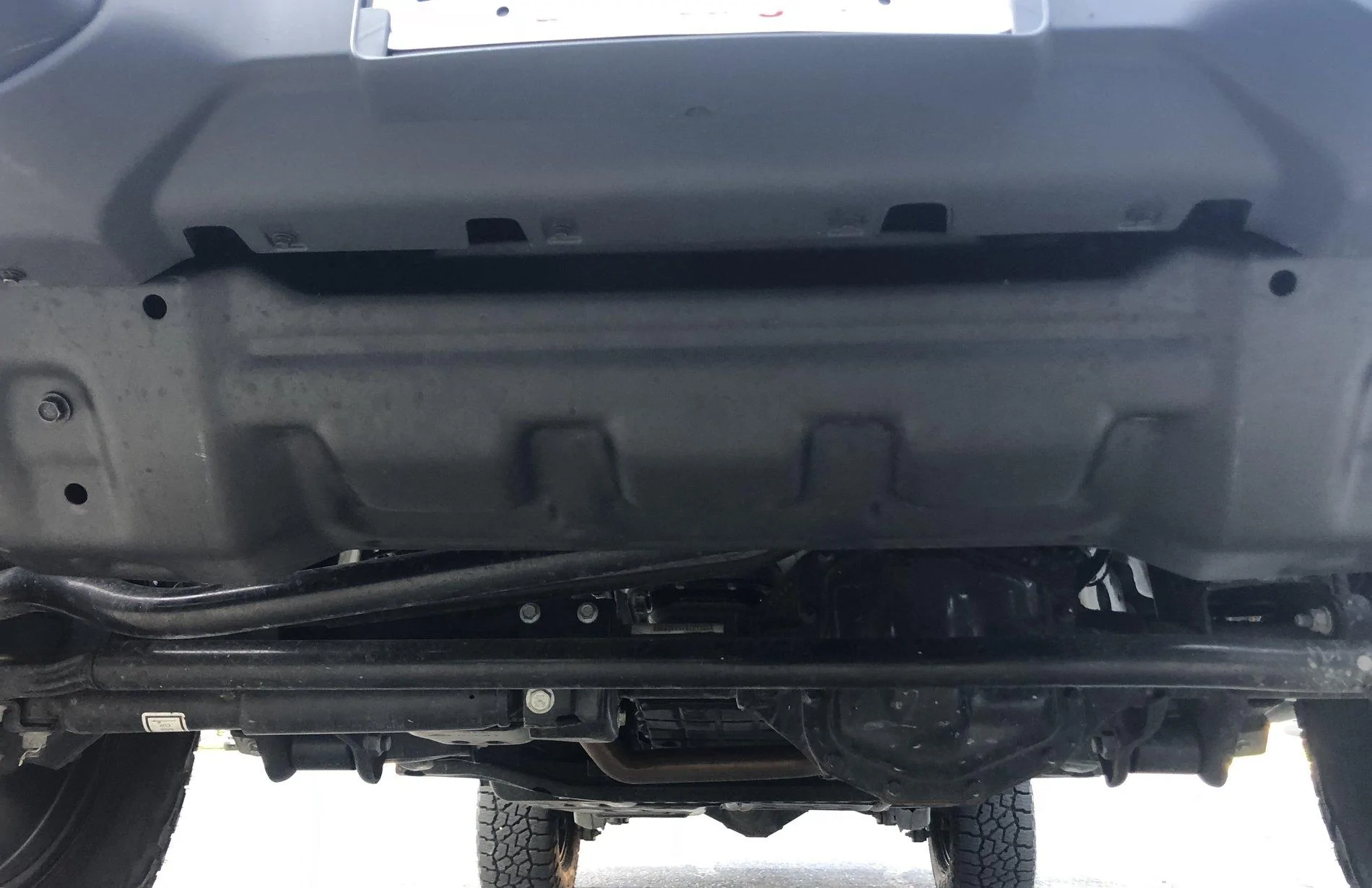

I got ahold of a stock Rubicon (non Steel) front bumper and also the metal skid plate that goes with it - but it looks like I'm missing some sort of mounting brackets/hardware?
Does anyone know what that skid plate bolts into and if the brackets are available anywhere?
Sport S with rubicon one piece bumper and skid plate.
