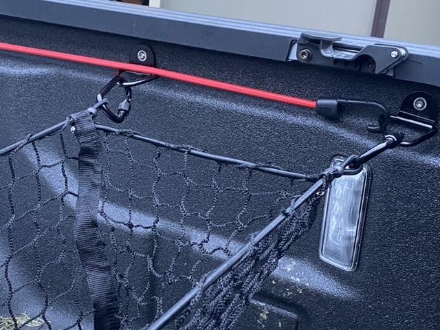

I put a few of these in today to attach a storage net to. Quick, cheap, and easy solution to handling a few bags of groceries when I’m out with the family and the cab’s all full.
I like that - it's similar to what my wife was mentioning I should do when we loaded up a few things and I had a few jugs of distilled water in the back for my shop - and decided to move them to the back seat floor area.
She suggested one of those net type basket things that attaches to the side, folds or pulls out to put groceries, jugs of milk or whatever in, and then when empty, folds back out of the way. Your post gave me some ideas.

Would be a big help if you posted links to the items you bought - d-rings, net, etc.
Thx

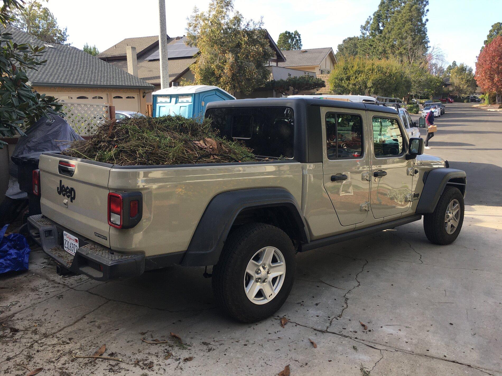

I did the same thing with the D-rings. Put them on every location where there was a screw. Trying to figure out how to do it on the tailgate too. I found removing one of the Torx bolts from the tailgate was useful in clearing out the bedliner from my holes rather than using a tap. Just that and a screwdriver with the torx head was enough to clear them out. In and out a few times and it was clear. I've used them many times already. The metal of the bed isn't super strong, so you do have to be careful with ratcheting tie downs. They were really useful using my bungee net the other day. Lots of connections points at the top of the bed.

I have the exact same bungee in the exact same location...just in orange. Great minds think alike?

The links are still accurate
Net:
https://www.amazon.com/dp/B0179KBKTS?ref=ppx_pop_mob_ap_share
Tie down anchors:
https://www.amazon.com/dp/B07H9ZKRH6?ref=ppx_pop_mob_ap_share
Screws:
https://www.amazon.com/dp/B07PNZLRY2?ref=ppx_pop_mob_ap_share
Carabiners:
https://www.amazon.com/dp/B072NCYVQK?ref=ppx_pop_mob_ap_share
Thanks for resurrecting this thread. I was just thinking about doing something like this.
@Phinneywood I hope you are still around because this is brilliant and I just want to say thank you.
