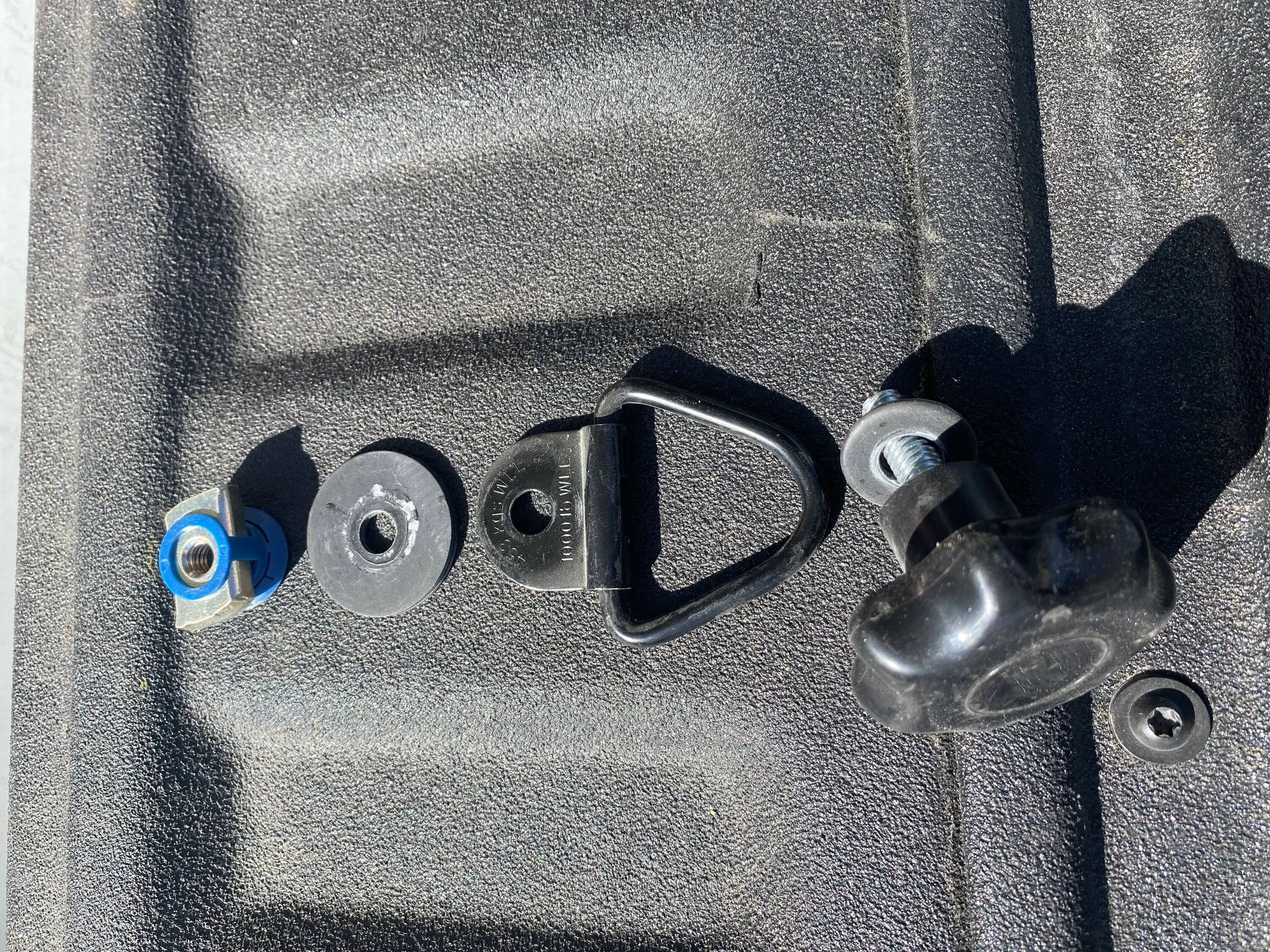

Unistrut parts fit fine. Get a unitsrut spring nut and pull the spring off. I forget what size, but Home Depot will have them

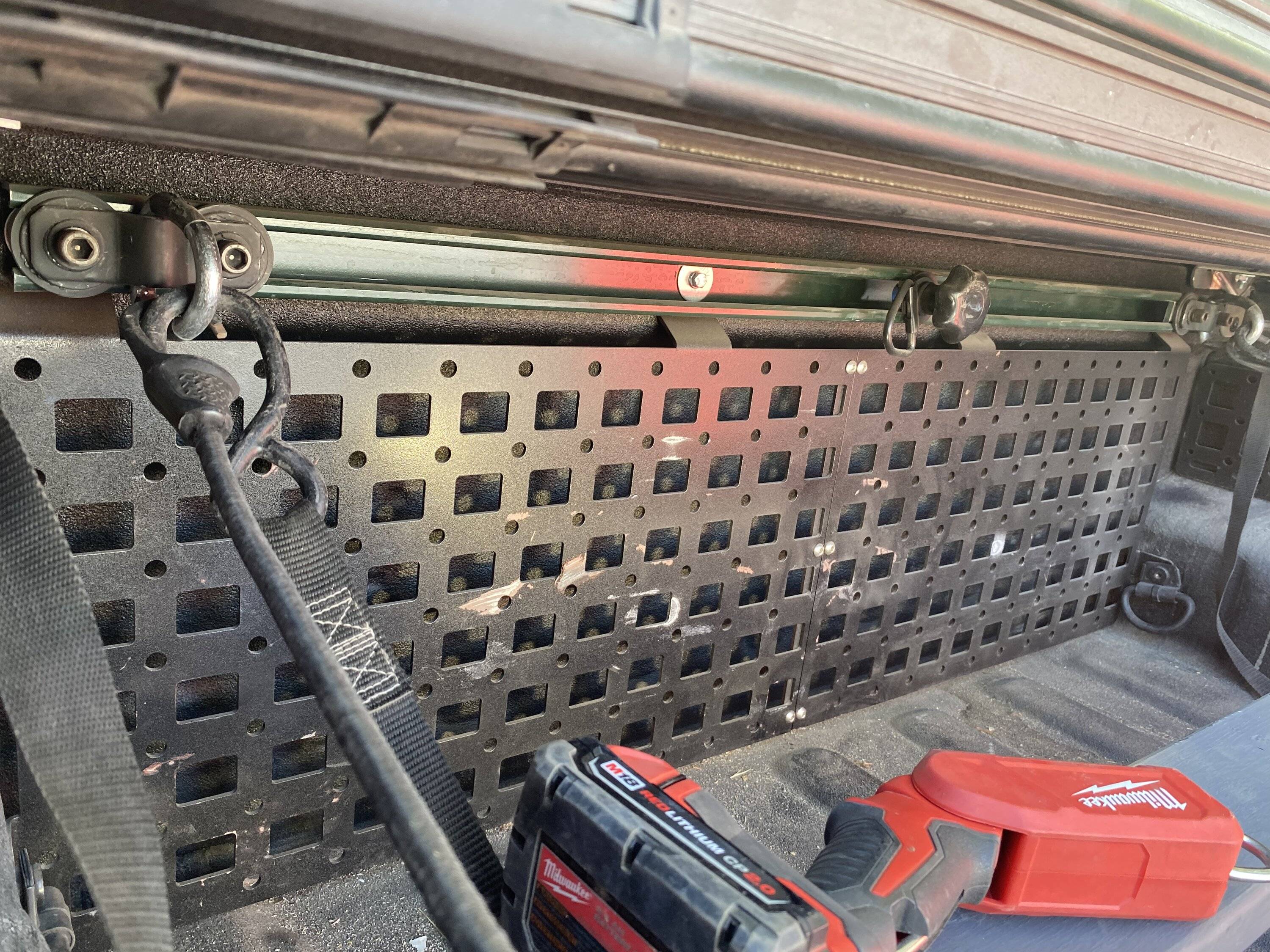

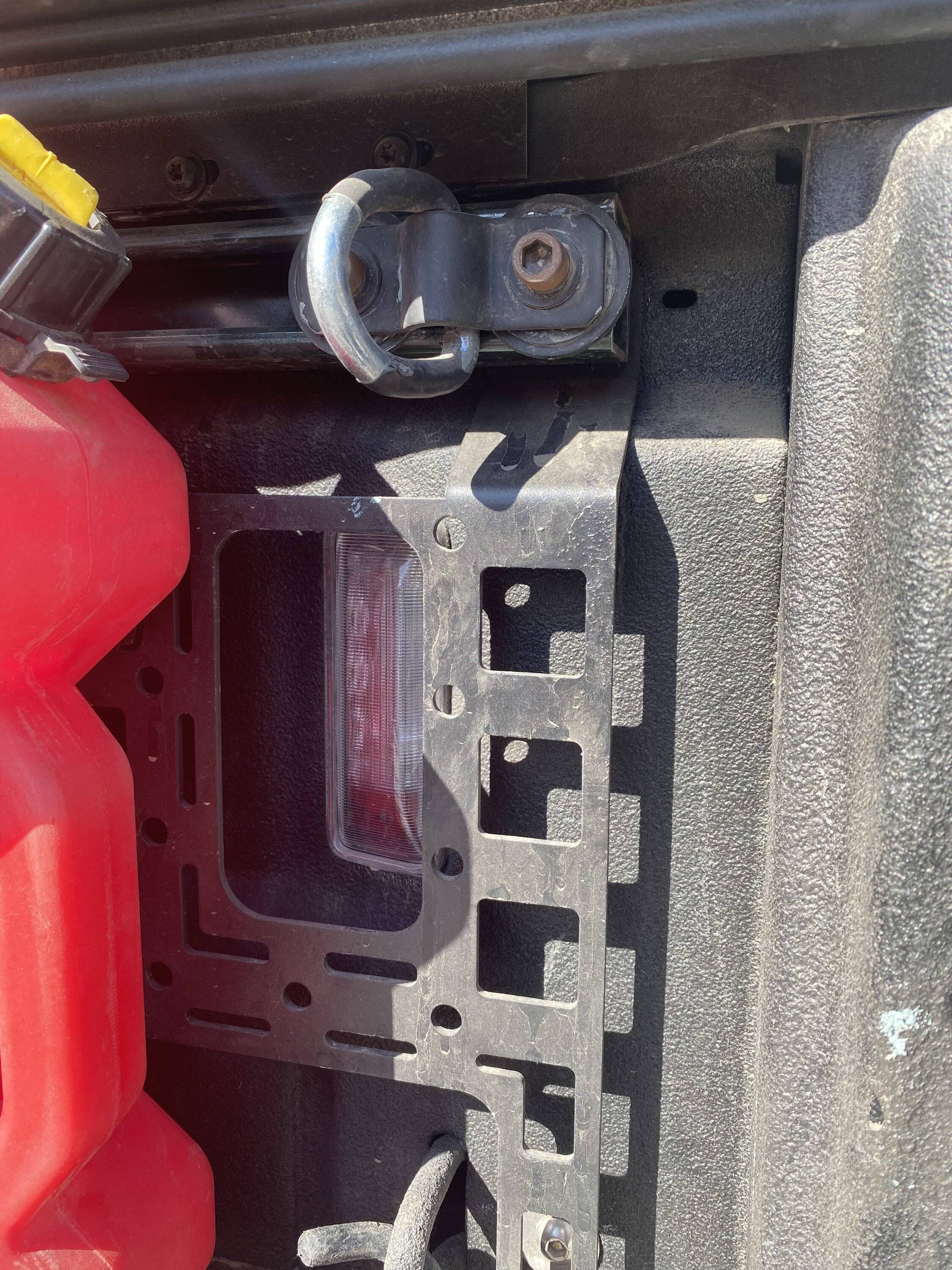

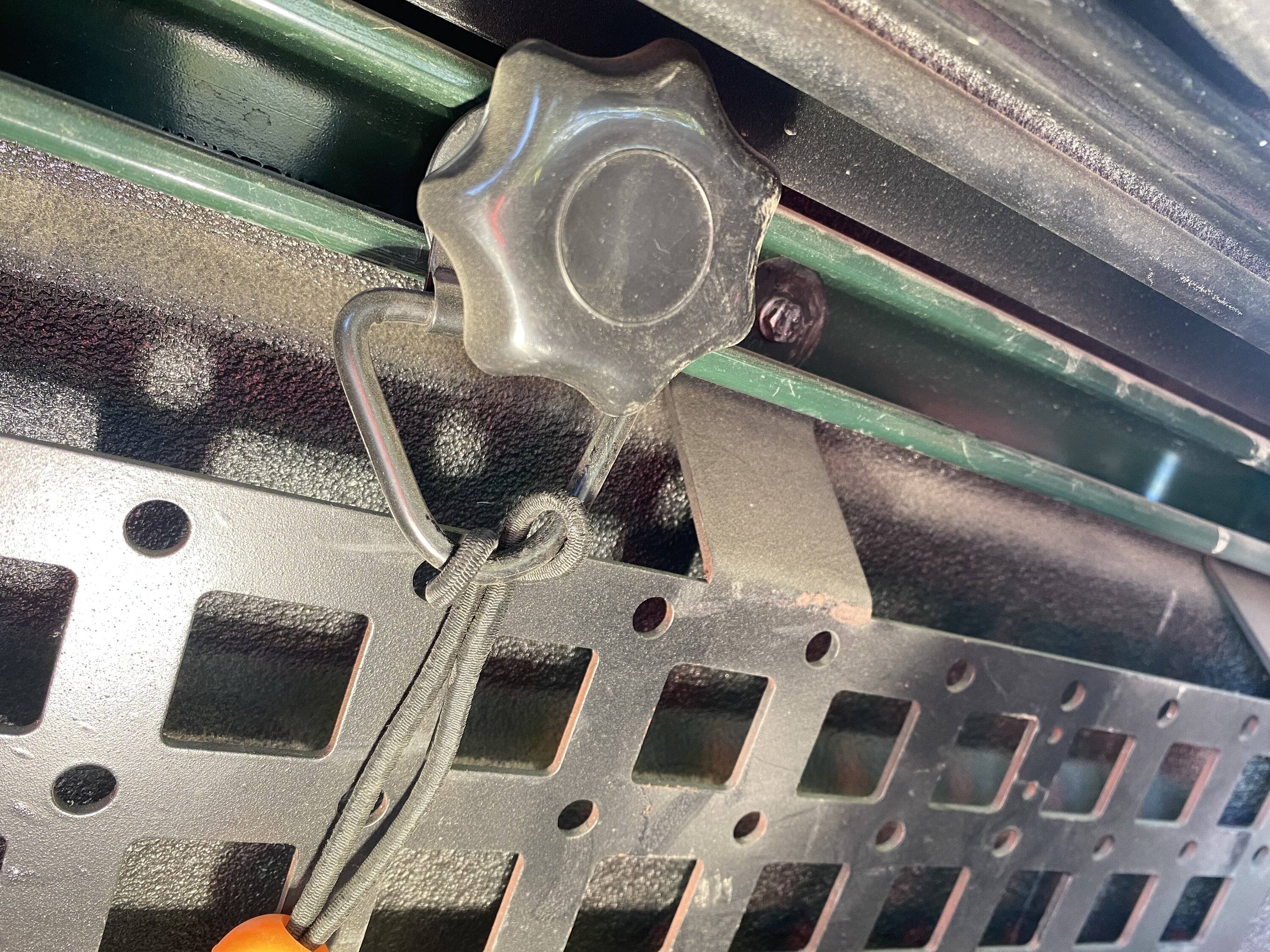

I did the trail rail out of unistrut also. Used two different types of tie downs. The larger two bolt from local hardware store the smaller single bolt on Amazon. With both the unistrut lug was used
Jeep Gladiator Trail Rail Tie Down 270B601B-591D-467E-97D1-D4C538522236
Jeep Gladiator Trail Rail Tie Down 3A6AE882-4EC9-45F8-B81C-72887009B28E
Jeep Gladiator Trail Rail Tie Down 817834BA-F2DD-415A-8305-94C92FF01228
Jeep Gladiator Trail Rail Tie Down F6817647-BA64-40CA-9661-C3F88E5F1F59
