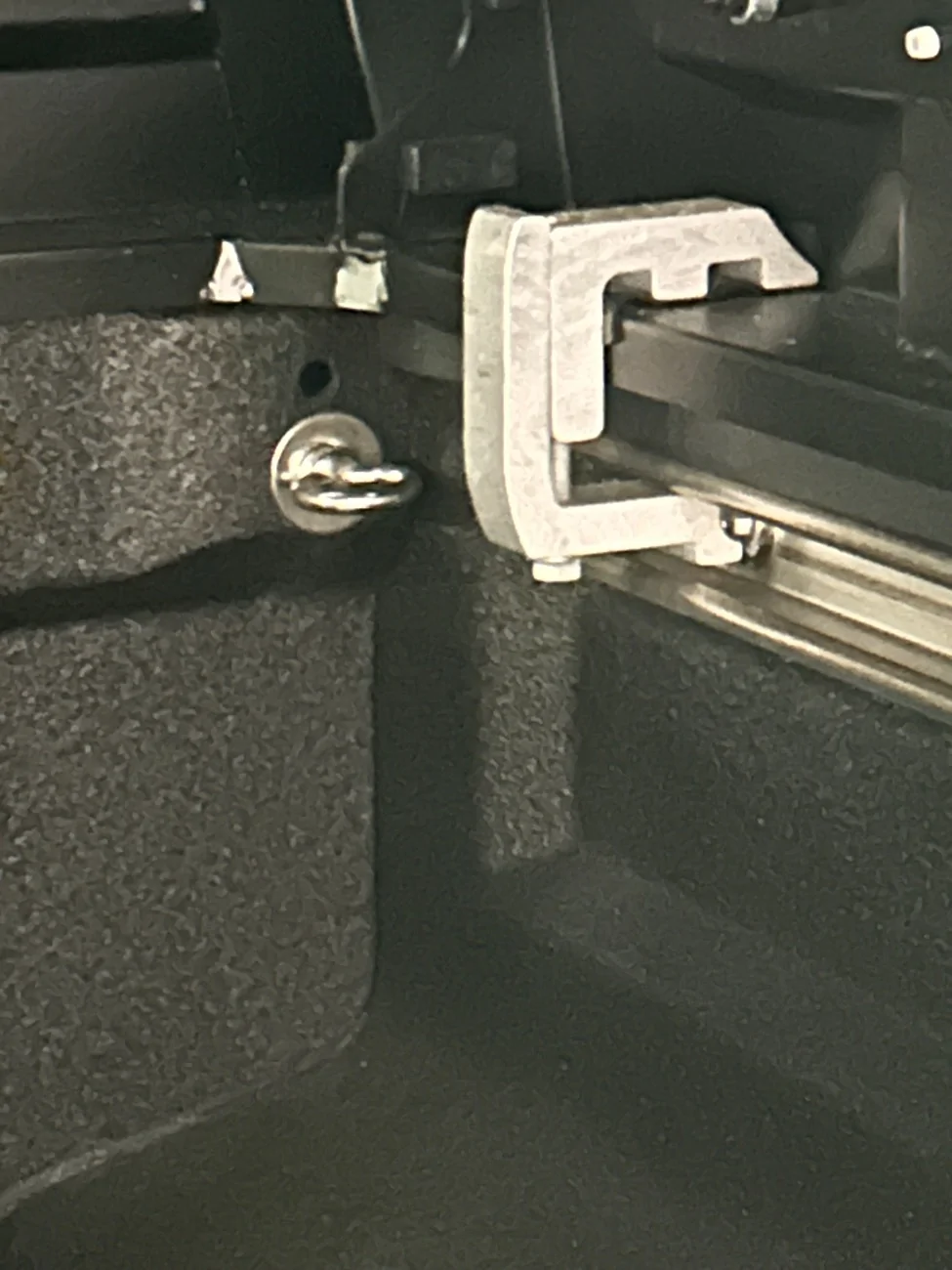

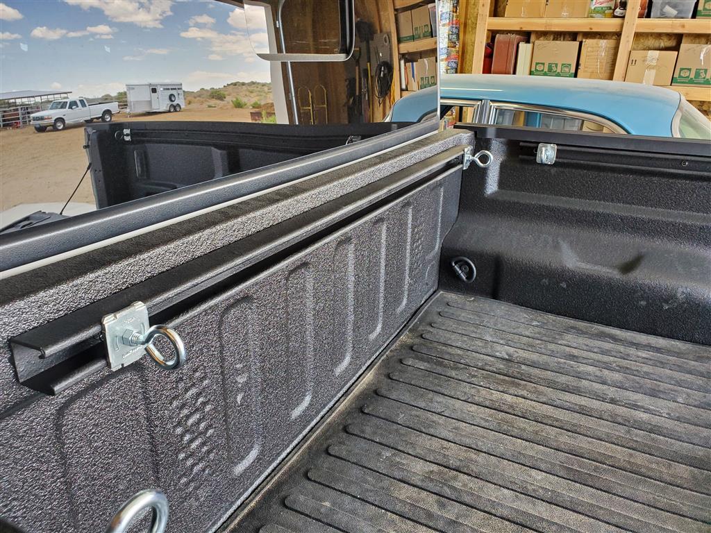

I've been using it to hold an air compressor and also my RSI cap, even got stainless steel , but did not put any on front as I figure every inch is important in a 60" bed.......Jack
Edited to show a couple things:
Jeep Gladiator Anyone use unistrut  instead of mopar bed rails? IMG_5131
Used 316 stainless cast eye bolts pretty low profile.
Jeep Gladiator Anyone use unistrut  instead of mopar bed rails? IMG_5130
Used one of the existing corner holes with stainless fender washer for front, never had an issue with not having the front rail on .

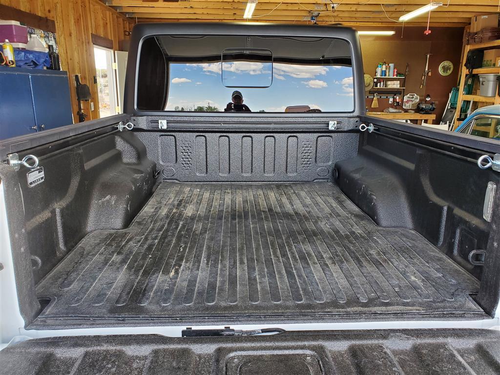

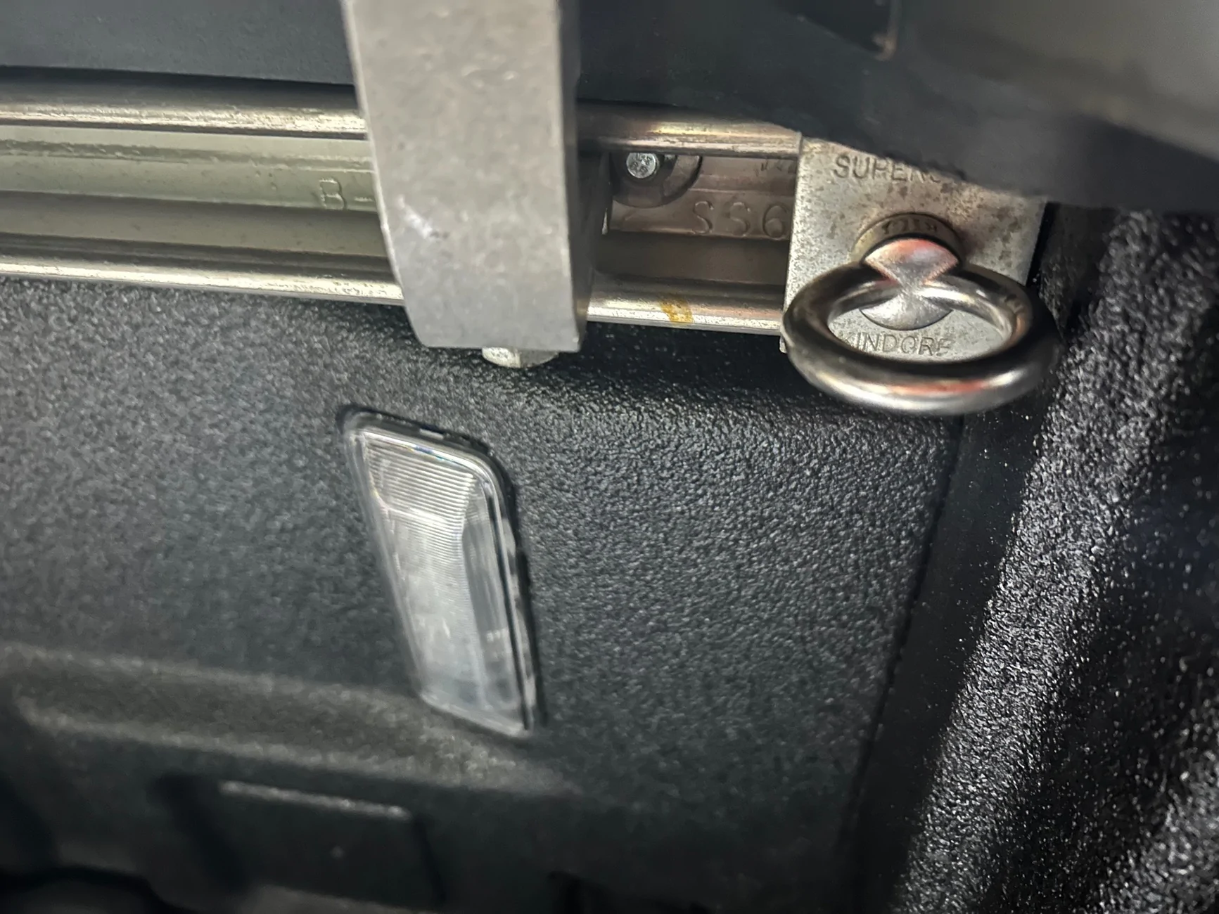

This is what I did on my 21 Gladiator. Solid Unistrut and black wrinkle paint. Worked fine. On my 25 Mojave I have the Amazon rails.
