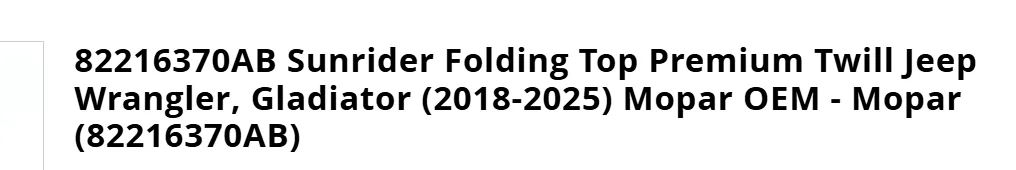

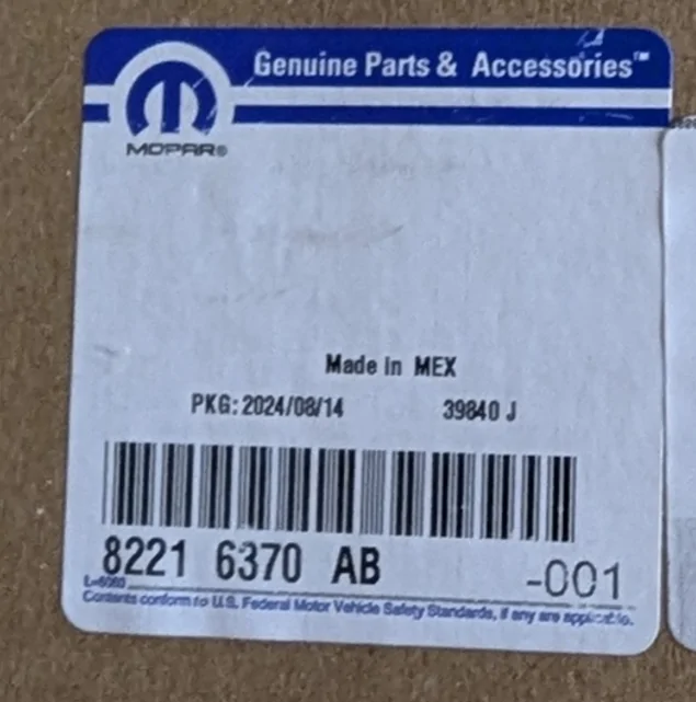

Are your replacements Jeep or Bestop branded? There will be a "Jeep" tag on the passenger side exterior, at least there is on mine.
40,514
54,043
The original, or first, of course Jeep.
The second, the one that the dealership ordered and put on is Jeep
The third that got damaged and sent back - Jeep.
The one that Bestop sent, I put back in the box - can't recall what the tag on it said but I believe it was also Jeep.
