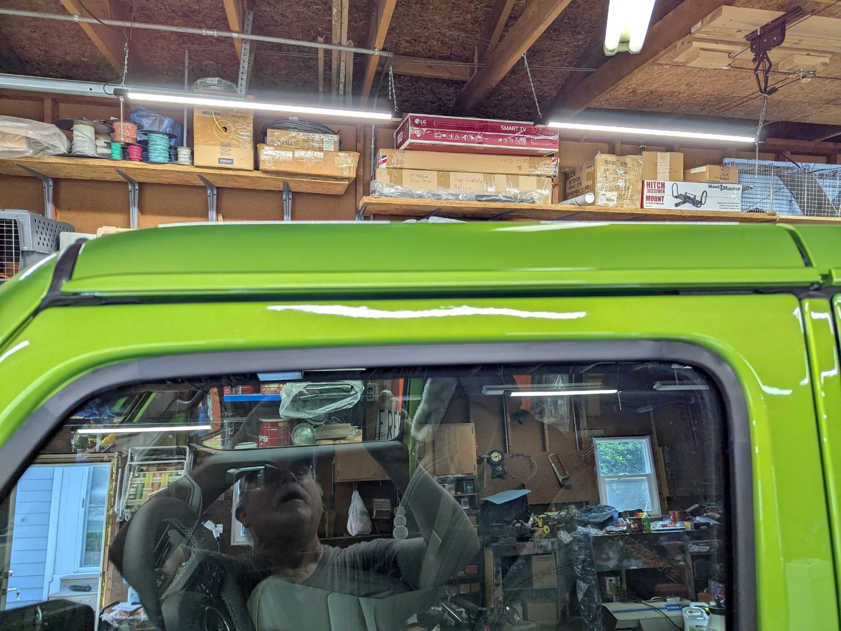

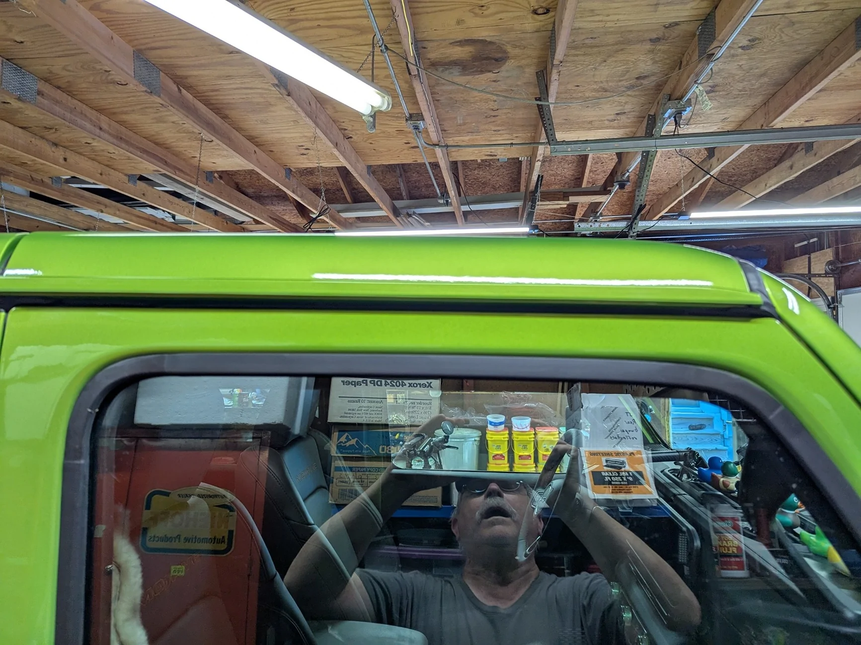

I apologize upfront if already mentioned, but how does the actual hardtop freedom panels fit?
40,514
54,041
Perfectly.
0 issues.
Exactly parallel with the tops of the doors on both sides, and the seals just touch the panels, no pushing down on them at all.
