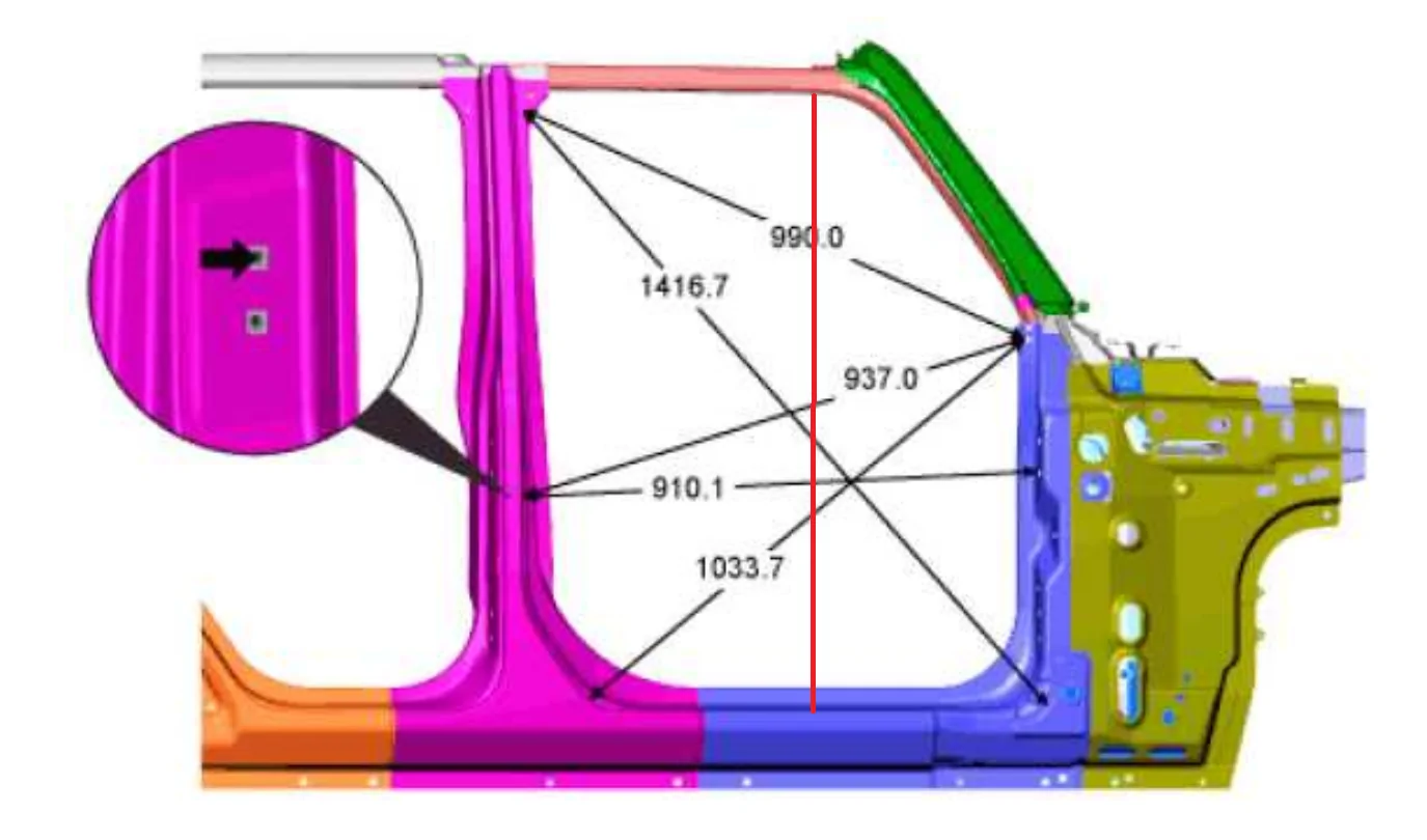

@ShadowsPapa have you done any measurements yourself? Attached is the body dimension document for a 2021 that has Figure 4 showing the upper body and sport bar dimensions in MM. It does not give +/- tolerances for the hard fixed point dimensions but does give panel gap dimension tolerance, but seems to be fixated on the hard top panels.
That's more than I had - thanks.
I don't know what the panels weigh, but I'm not supposed to lift anything over my head over 10 pounds so I might not be taking the panels off to measure any time soon. Got a couple of weeks left before I'm to lift.
Since the problem is at the front of the sunrider (it seems to sit ok at the rear), my biggest concern is the red line here -

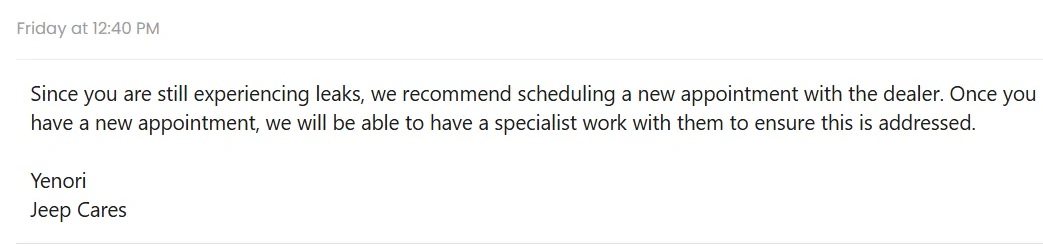

I had to laugh at this message from Jeepcares -
Jeep Gladiator Sunrider owners - MY mess-up, or theirs? 1762890897136-qd
They don't get it! It was never about leaks, and the dealer will not set up an appointment without some direction as to what's being done and so on.
Dealer will say "what's the appointment for" and laugh if I tell them.
JEEP needs to contact the dealer and say something.
Last time I tried this - nothing happened. Dealer never heard from Jeep and Jeep closed the case
JC is running in circles, and worthless.
