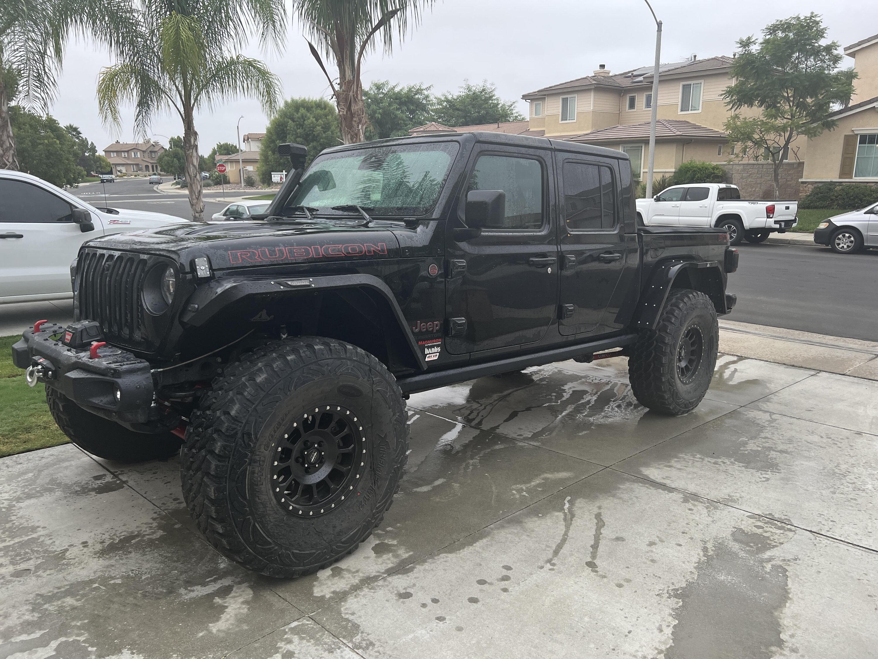

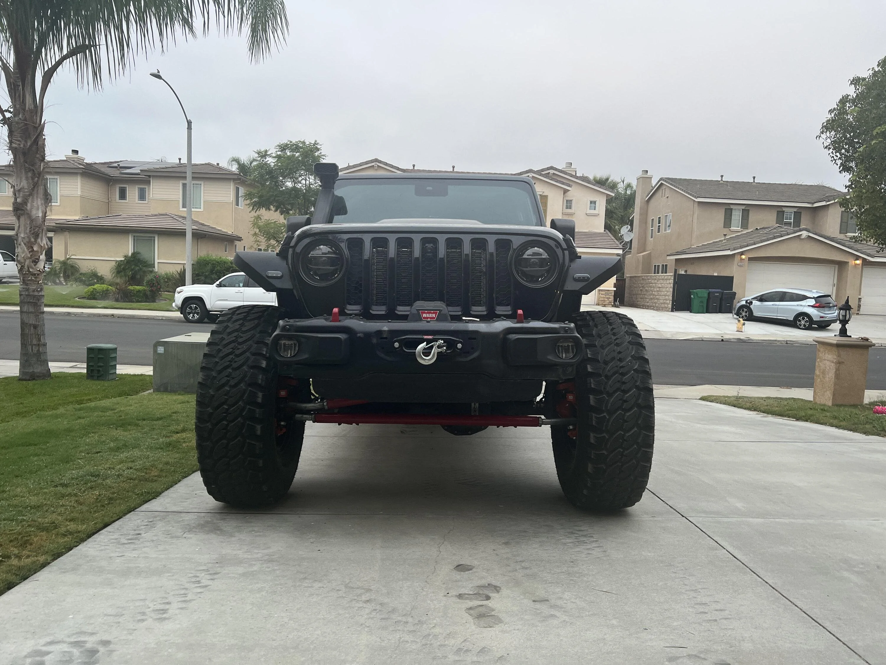

Got her back finally.
Jeep Gladiator Supercharger with 5.13 = Pinion Kaboom 40sfront
Jeep Gladiator Supercharger with 5.13 = Pinion Kaboom 40sside

500ish mile break in and then I'd suggest a 250W shockproof oil like Amsoil has. You are asking a lot of those axles and leverage required to turn that diameter tire.

Great to know, Ive been using 140. I'll get the 240w shockproof and once I hit 500 miles use that. Thanks for your input

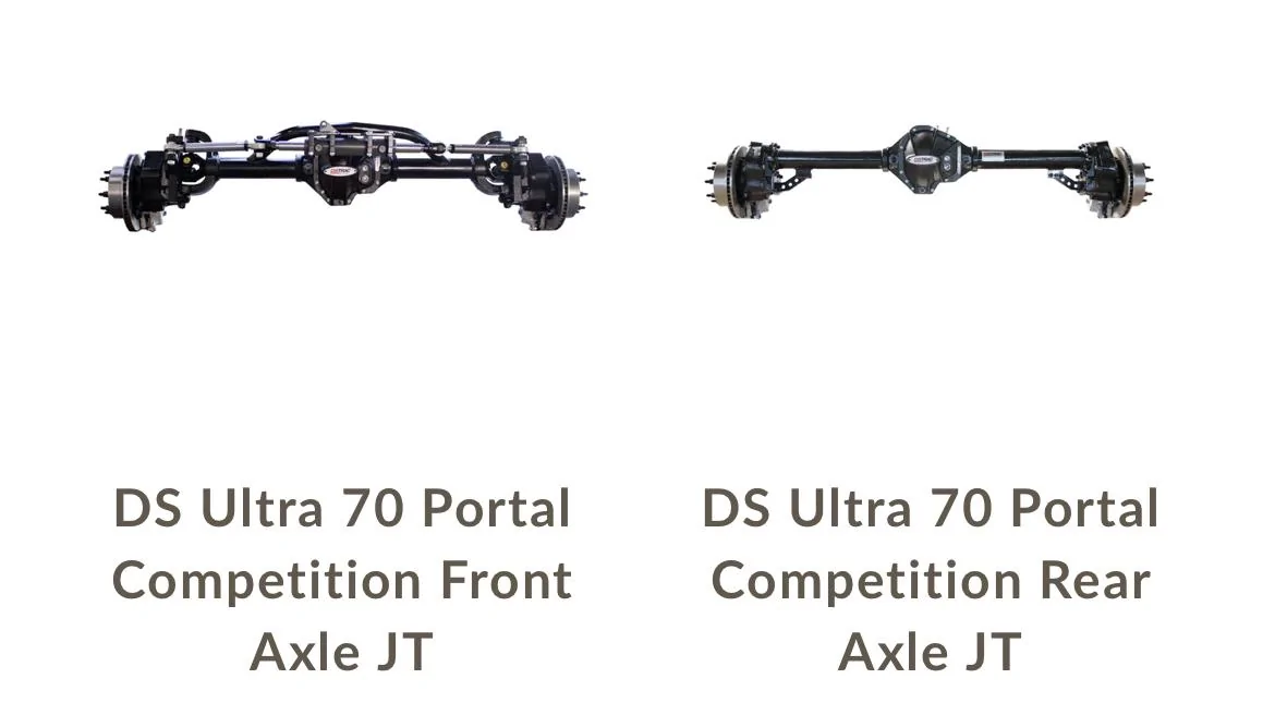

when and if I eventually decide to do an axle swap I will go with the following:
DS Ultra 70 Portal Competition Front and rear Axle JT
Anyone on the forum you know running these? I was expecting them to be more $$$$ because of the portal axles but they are inline with alternatives. Look sweet!
You better want to run 42"+ tires with those axles since you will need at least a 2-3" lift if you want your suspension to work right. I'm turned off just because the fictional losses weight, and extra maintenance......What about parts availability in 10 years?
