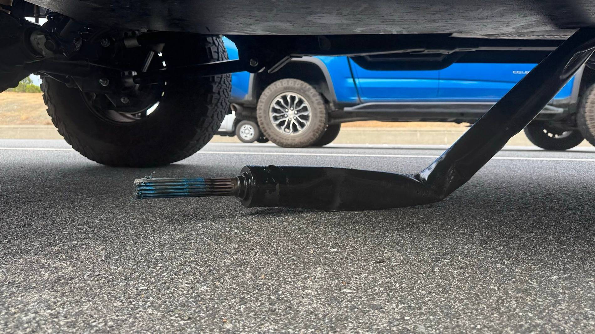

Yea, I've been battling a similar drone above 60-65. I took it to a shop who sent it to a driveshaft specialist who said it was bent, and they did "the best they could" to straighten/fix it. It was actually better till about 68-70, but would still start vibrating. Finally came to a head when I took it over 80 (had to pass a car to get out of the passing/left lane).
Craziest part is this isn't how I expected it to go if it were to: if you can tell, the spline slid out of the slip yoke entirely intact.
