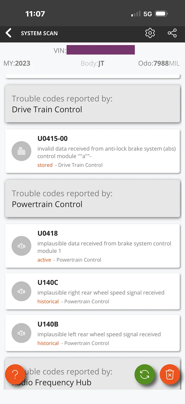

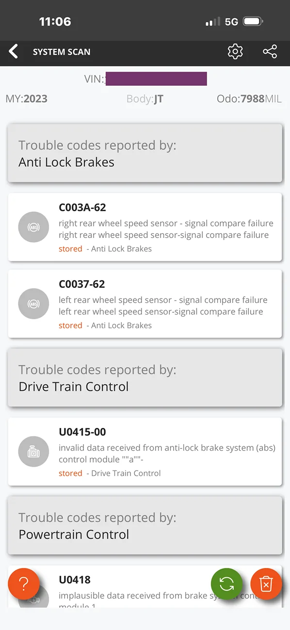

I just installed my new Dynatrac Pro Rock 44/60 setup, and my Jeep Gladiator is throwing rear ABS errors that are effectively shutting down my rig.
Jeep Gladiator JT with Dynatrac 60 and ABS Errors thumbnail_IMG_1769
Jeep Gladiator JT with Dynatrac 60 and ABS Errors thumbnail_IMG_1770

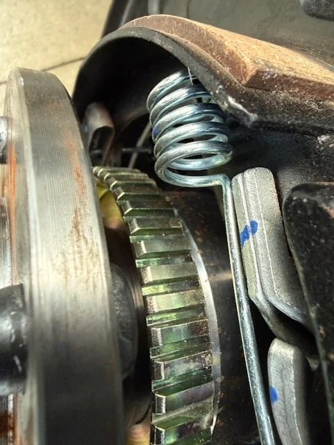

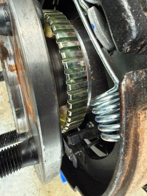

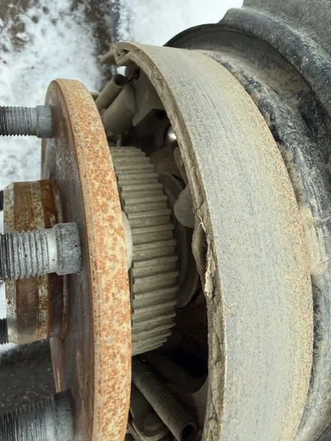

I replaced the rear ABS sensors on both sides, but the errors persist. I do have a noticeable difference in the tone rings between my original and the Dynatrac one. I took some pics, as the teeth for the 60 are considerably larger than the OEM.
OEM
Jeep Gladiator JT with Dynatrac 60 and ABS Errors thumbnail_IMG_1790
Dynatrac

Not sure if that’s an issue?? I have both a J-Scan and a Tazer as needed for programming. Right now, I have the tazer, unmarried, and using the JScan. I have confirmed my axle and tire settings are correct and have initialized the ABS after the updates. Also, here is a picture of the ABS sensor gap if that's also something to look at.
