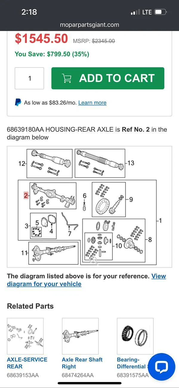

I'm still betting there's no gears or locker just a bare housing by the pictures though. Piecing it together, geras, locker, adding shafts, truss, and paying someone to weld brackets I'm betting you'll be way closer to the cost of the semi float 60 than you'll want to admit. Personally I'd need to at least get confirmation that is a complete center section before I'd drop the money. Especially if you have to pay someone for the gear setup. You'll easily be real close to the sf60 if gear prices are as high where you are a they are here. $1500 housing, $1k for shafts, $1500 for gears and install, $1k for the locker, truss/brackets and welding another $500-1k. And now you're $6k into a 44.
I agree, except the “housing” has gears, which also means it has a carrier … soooo, back to the $3500 I stated …
I guess the reality is we need to order one and see what’s what …

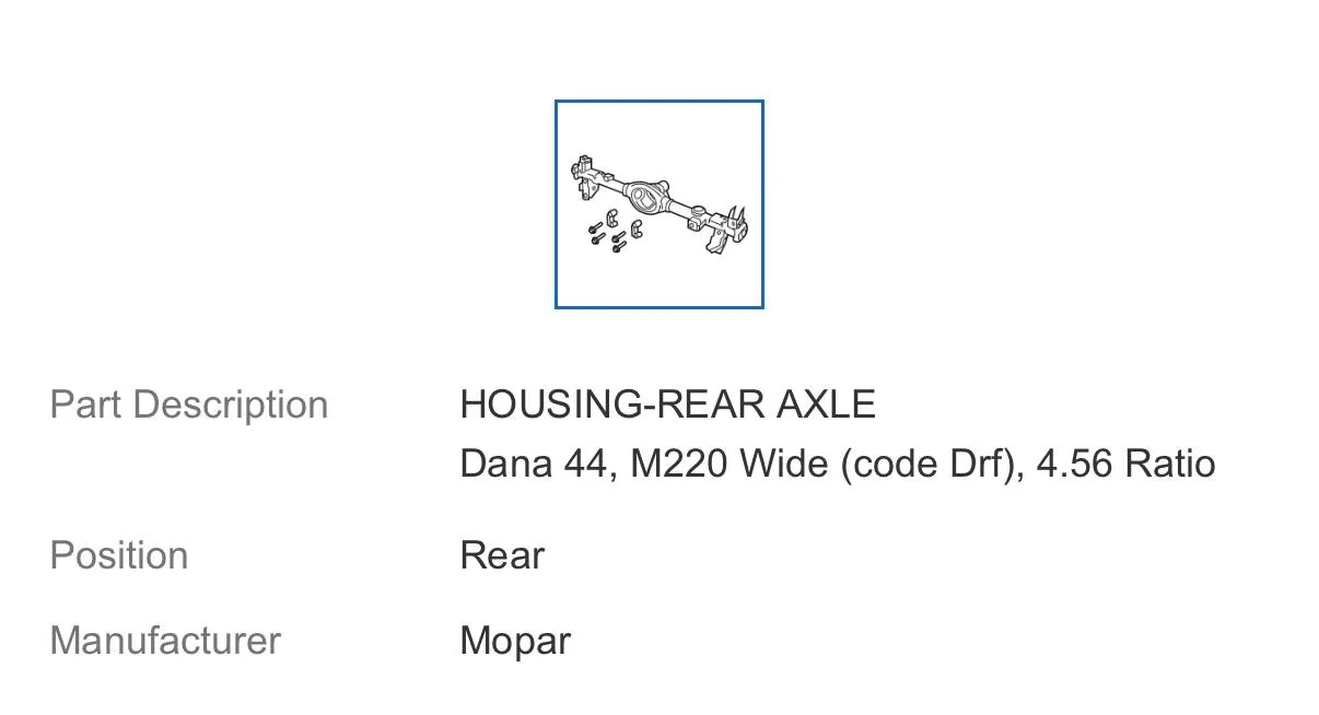

Then why would they specify a gear ratio if there is no gears ???
also, to your other point. The full float rubicon axle is about $100 bucks more. $2600 for a complete replacement axle. These are service replacements which are a bolt on and go sort of deal.
https://www.moparpartsgiant.com/par...year=2024&submodel=&extra1=&extra2=&filter=()
id almost be willing to order the housing just to see what we get. Keep it if it has gears/carrier installed.
Does the carrier ever change with these gears? Maybe that’s why? On my camaro the carrier is different for 2.XX gear sets and 3.XX gear sets.

They would throw in a carrier just to dangle around without mounting to anything … and no, the carrier/lockers are all the same, DANA got away with the “carrier break”

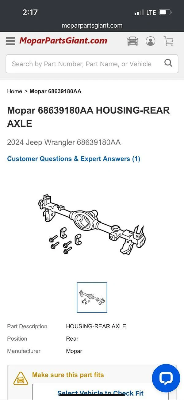

Thats weird. I checked on both my phone and laptop and I see something different. Another pic at that link shows it includes #2 only which is a pic of a housing with bearings caps. The ring and pinion is #9 and not part of #2.
Jeep Gladiator New: Ultimate Dana 60 Semi-Float Rear Axle for JT Gladiator IMG_2438
Jeep Gladiator New: Ultimate Dana 60 Semi-Float Rear Axle for JT Gladiator IMG_2439

Like I said earlier it clearly shows that only #2 is included. The bare housing with nothing else. Why it says 4.56 is beyond me as the gears are a separate number and the locker/carrier a third number.
